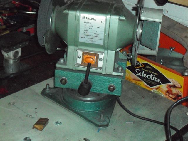

      Two years ago I used a cut down brake disk as the main part of a rotating base for my grinder. This now forms the basis of my tool and cutter grinding equipment.grinder
