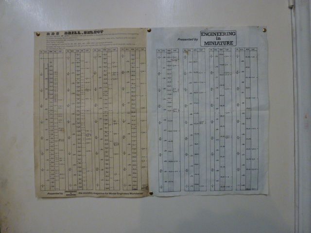

      This useful chart was an inclusion with MEW ( dont know when because it bears no date, but it has been a while because it bears a Nexus Specilist Publication logo, so it pre-dates MTM)
      Ive found it very useful and mine shows marks of wear, tear, grease and dirt.
      So If I can get hold of a fresh one or otherwise re-print, I would like to do so and this time laminate it before the damage
      Michael ……. dow nunda

                      Thor, I appreciated the mm inserted in their proper place by size
                      Myford aint down under and postage of a laminated chart would be prohibitive
                      Didnt follow your point, not done
                      So Im still looking for a scanned original one, not any ot the other charts mentioned. I have tried many and that MEW one is IMHO the best combo of data in an A2 soze ( to be laminated and handled, not put on the wall)
                      Michael(an internetnik since about 1982, BTW)

                              These 2 charts are pinned to my workshop door. They came with the very first issues if EiM, (am I allowed to write that on this forum?). How long ago was that?
                              I wouldn't be without them.

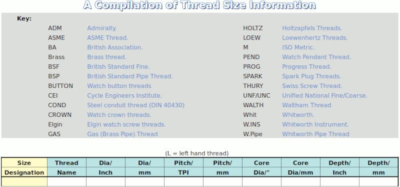

                                Table with most thread data downloadable as PDF or ODS (spreadsheet) from Journeyman's Workshop
                                This information is from a now defunct website "Watchman" which fortunately has been archived on the Wayback Machine website. The original is a huge HTML table but also available as a spreadsheet. I have downloaded the spreadsheet and modified the layout slightly and made it available here for download along with a pdf version of the chart.
                                The table is 525 rows long and covers 24 different thread types. The image below shows what data is in the download.

                                    Posted by Michael Belfer on 08/12/2020 03:36:37:
                                    What useful chart? I don't see any chart at all. Can you post a picture?

                                      Posted by Journeyman on 08/12/2020 10:37:12:
                                      This information is from a now defunct website "Watchman"…
                                      For the sake of clarity, it might be useful to stress that you obtained this table from that website but in no way is that place responsible for its original compilation.
                                      If you put 'bodgesoc thread table' into Google, you will find its true genesis, Andy Pugh, who is also a member here.
                                      Credit where credit is due and all that…

                                        Yes, that information is contained on the downloads at the bottom of the table:
                                        "Original compilation by Andy Pugh of Bodgesoc Industries, Sheffield, UKAdditions and layout by Ian W. Wright, Sheffield, UK"
                                        I do always try to credit others good work where I can!

                                              Twenty-odd posts later and we have an impressive array of answers to questions that Michael didn't ask. Unfortunately I haven't got the chart he's looking for, so I can't put him out of his misery. Can't anybody help him?

                                                We might have a fighting chance if we knew what the chart looked like.
                                                #512460
                                                Michael Belfer
                                                  @michaelbelfer47979
                                                  as suggested, and as I said, tattered and dirty more than somewhat
