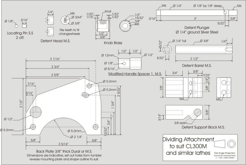

          Posted by Mick B1 on 16/01/2019 09:50:36:
          Posted by JasonB on 16/01/2019 09:43:51:
          Mick, could you let me know what dims you think are missing please.
          And I'd have to make assumptions about the x-position of the left-hand holes on the left-side rectangular pads, whereas that of the left-hand holes is specified.
          Edited By Mick B1 on 16/01/2019 09:53:23
          Edited By Mick B1 on 16/01/2019 09:55:07
          Aaargh! Sorry – think I meant the right hand holes on the left-side pads!

              Thank's Mick
              I did not show a thickness as it is not a critical dimension, really just skim the bottom so it does not wobble. The 0.062 for the round corner fixings could just as well have been a spot face, the 0.125 is the only one that really matters as things could clash with the base if less.
              Regarding the 8No 5BA holes to the left I went for the assumption that most people would take them to be a mirror image of the right hand side. The only dimension on the left extends down to the 3.0mm CSK hole and positions that and the one lower down.
              SOD, I try not to put too much on a single sheet to avoid clutter buy may place 3 or 4 small related items on the one. Sometimes it is difficult when you have decided to constrain yourself to one sheet size and you get a part that needs several views and maybe a section as well as having a lot of dimentions etc.
              On this particular engine I have had to put the cylinder onto two sheets as scaling it down so all the views fitted would just clutter the dimensions etc too much. If I had gone upto say A3 or A2 most people would end up printing bits on A4 and putting together anyway so no real harm.

                Posted by JasonB on 16/01/2019 10:43:35:
                Thank's Mick
                Ah – context is important. I should've thought of that.
                I'd assumed that it was for issue to a foundry and machine shop, intended to cover both casting and machining. Of course, if it's for issue with a set of castings in an ME kit, it'd be obvious it was intended only to cover machining. Nevertheless, I'd expect the corner hole spacing to be dimensioned – Anthony Mount did so on the base of the Hypocycloidal I built last year, though only from one edge and without the 'typ. <n> posns.' I think I'd probably have put in.
                But I'm carping – it's always a helluva lot easier to comment on the work of others than to do it yerself! blush

                    Jim, hopefully you will get what you ask for as that is what was on the Jowitt drawings that you made.
                    The subject of holes in bosses is an interesting one. I could as Mick suggests dimension the hole from two edges but all to often you see a model where someone has followed these dimensions to the letter and you get a hole that is well off from the boss as the casting did not end up like the designer had intended (as in this case). Worse if the builder does not take the trouble to tidy up the boss afterwards so it is uniform around the hole. Though out of context you don't know if these 4 holes should match those in another part in which case dimensions should be given.
                    I have recently made a couple of engines from American casting kits and these had the "COB" that I have used here which stands for "centre on boss" and results in an aesthetically pleasing hole that is smack ban central to the boss, obviously only works for things like these mounting holes which are not critical as they will just be used to screw or bolt it to a display base.

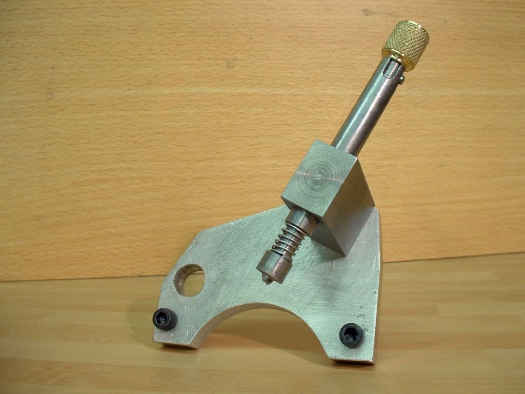

                        Another thing that I can include in the package is a 3D PDF where you can zoom in and out on the 3D model as well as move it all about. You can play about with lighting, colour or just get a line drawing and transparent is handy too.
                        You may need to trust the document the first time you click on the image but after that click to activate and hopefully you will be able to look around the model Cloud link

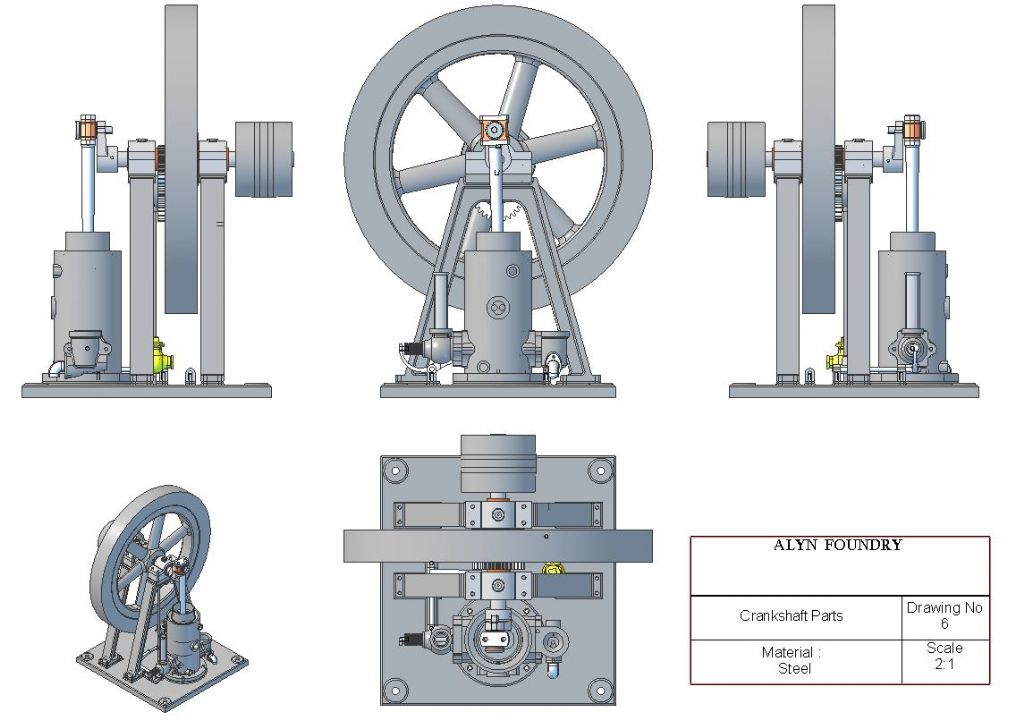

                          Can I throw in a googly?
                          I have a personal preference for a VERY pale shading, say a 5% gray, for the background.
                          This makes it very obvious what are holes through a part and what are raised features, and also makes it clear that dimension lines are not part of the object.
                          This will no doubt be unpopular with some but I find it helps me 'read' drawings, especially ones with lots of parts.
                          I find many 3D drawings distracting unless they are needed to help visualise a particularly complex part.
                          I can live with or without colour on 3D.
                          P.S. here's one I did 15 years ago(!)

                            Whatever you do, avoid the awful kids' crayon efforts that appeared in ME with Keith Wilson's GWRillian series. It certainly didn't help that production problems with ME at the time caused some of them to appear almost blank!
                            Yes, "We've always done it that way" line drawings with 2 or 3 views are well known and understood, but modern 3D CAD does enable realistic rendered images to be produced. All very well if you're only going to look at them on a screen, but it'd cost a fortune in printer ink if you're printing out a load of beautifully-rendered colour 3D images…
                            My preference (Assuming you will print drawings) is for standard orthographic views as line drawings (Avoid too many hidden lines – add another section view if necessary) and pictorial/isometric line views if needed to illustrate a point. Pictorial views can be rendered, but I think it's mostly unnecessary; it could be considered showboating because you have a flash 3D CAD system.

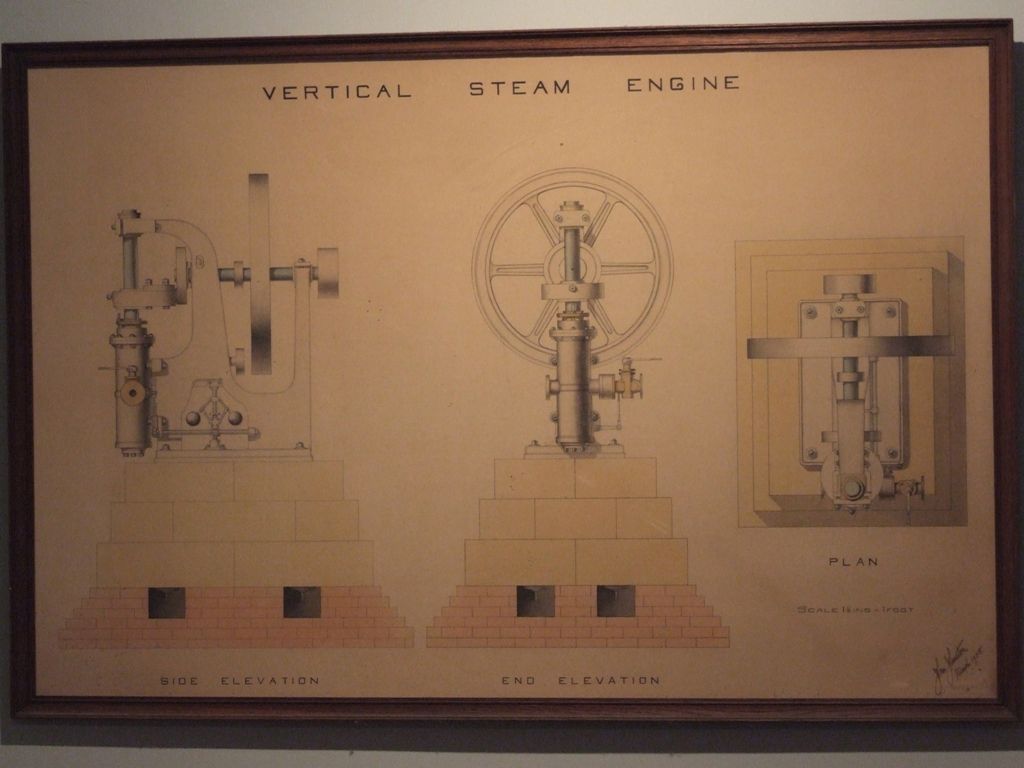

                                Of course the use of colour in assembly, as opposed to engineering, drawings is not new. This drawing was done in 1904:
                                Andrew
