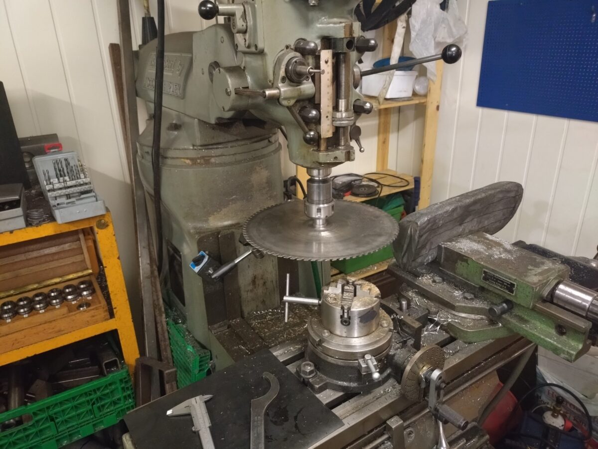

                    #792344
                    Fulmen
                      @fulmen
                      You don’t even need a horizontal spindle:
                      No, I never turned it on *shudder*

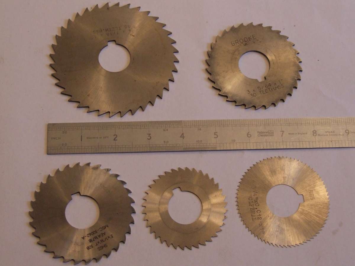

                              #792411
                              Julie Ann
                                @julieann
                                Slitting saws come in two basic forms, coarse tooth and fine tooth. Here are a selection of slitting saws:
                                2016_05190018
                                The slitting saws are all coarse tooth apart from bottom right which is fine tooth.
                                Fine tooth slitting saws are intended for shallow cuts only, like slotting a screw head. For deeper cuts use a coarse tooth saw, otherwise the gullet will get full of swarf and jam the saw.
