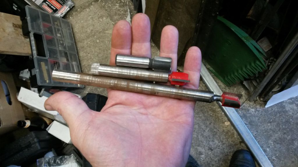

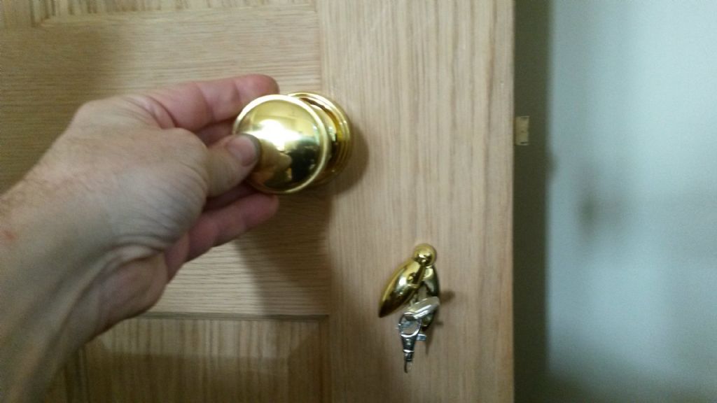

                                To achieve a period look I routed the apertures for mortise locks (Key centre 3" from edge) and latches (handle centre 6" from edge) for 7 internal doors with a router.
                                I couldn't find cutters long enough for my 1/2" bit router so I bought one 1/2" shank bit and 2 1/4" bits, turned extension bars on the lathe and bonded the 1/4" shank cutters into the extensions with a locking spot weld for good measure.
                                The company fitting the doors had suggested using roller latches as their fitters didn't have the means to fit latches this deep in the engineered timber doors which they supplied so I did the job while they hung the doors.
                                Cost me the cutters and some lathe time 😀
                                Edited By Nick Hulme on 31/05/2019 20:05:17

                                    Even with clamped wood support plates the door fitters said drilling can split the surface veneer of engineered timber doors, regardless of whether spiral or spade wood bits are used, I suggested all this as I have that equipment too
