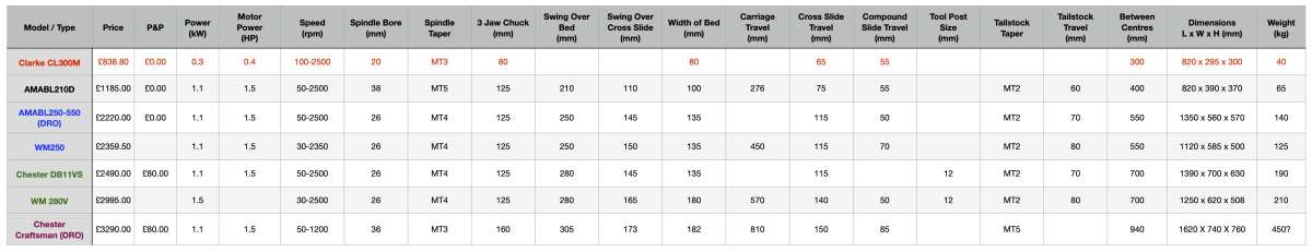

      Hi,
      This is a follow up from my original post ‘Upgrading from a Clarke CL300M, where to go?’ (https://www.model-engineer.co.uk/forums/topic/upgrading-from-a-clarke-cl300m-where-to-go/).
      My trusty Clarke CL300M has finally died (quite spectacularly) and now it is time to upgrade.
      I got some really useful help from my original post and have put together a selection of new machines ranging in both price and size.
      1. AMABL210D
      2. AMABL250-550 (DRO)
      3. WM 250
      4. Chester DB11VS
      5. WM 280V
      6. Chester Craftsman (DRO)
      These machines roughly fall into 3 or so categories in terms of specifications / price; 1-3, 4-5 & 6.
      I’m slightly struggling to understand the small differences in specifications (particularly the bed, compound and cross slide numbers) and whether they would make a real difference in day to day life. For instance would a difference of 45mm in bed width really make a huge difference and warrant paying more..?
      I have attached a comparison chart of the technical data I’ve managed to get (apologies if it is incorrect) to hopefully show what I’m talking about.
      My main concern is that apart from 1st and 6th machines the spindle bore size is still quite small. I realise that with a bigger, sturdier machine using a steady or tailstock mounted chuck handling larger pieces would be more successful than on my CL300M (which coincidentally was the final nail in it’s coffin) but I do think if I bought one of the smaller bore lathes would I one day regret not paying the extra to make life easier..?
      Whichever machine I decide to get I’m going to ask to have a DRO attached as this has been really useful on my mill. Only two machines on my list come with this as standard and I am yet to talk to the sellers regarding the additional cost this will incur.
      There are also some other points I wish to confirm such as the weight of the Chester Craftsman (DRO) being 450kg – is this including the metal stand?
      As before all and any comments would be very welcome!!!
      Thanks in advance, Chris.

        Maybe also consider the SEIG C4 if you want something larger than the CL300M. I’m very happy with mine.

            If you are also thinking of getting a factory fited DRO you may want to consider going up to the WM290, advantage over the 280 and Chester 11 are that it has a 1.5″ bore and a quicker to change chuck, DRO a sstandard.
            A lot will really depend on what use you want to put the machine to as to the size/length of material you are working with. I don’t find I need to get the steady out much with the 25mm bore in my WM280 and I get a fair bit of hobby use out of my lathe
            A wider bed generally means a stiffer lathe, look at the ratio of ctr height to bed width as that is a better guide than just looking at the width on its own as that naturally increases as  the size of lathe goes up.

                  Bed width makes a big difference, stiffer
                  Spindle bore, a big one means you just chuck a bar, no faf-fing about with cutting a workpiece, and less waste

                    Warco machine has VFD and 3-phase motor – no belt-changing. 2HP in place of 1.5HP. Higher top speed as well – although also slightly higher bottom speed. Also has D1-4 Camlock spindle nose, which is so much better for chuck-changing than the bolt-on-flange style, which the Chester machine seems to have (although not actually mentioned in its description).
                    Are these worth the additional cost? I suspect if you buy the Warco machine, you would forget the extra cost once you have used it a bit. But you do have to find the cost in the first place, and it’s always easier to spend someone else’s money…

                      The Warco 250, 280 & 290machines have two speed ranges so there is some belt changing, low range if you are doing large items or want it slow for threading otherwise it can stay in high for most things.

                            Camlock is an asset, but having lots of different chucks gets expensive. DRO’s could be added at a later date, and are not as essential as when used on a mill.

                                To chuck another option into the mix – the Warco GH600
                                As the name suggests, this is a gear head machine with a 12 speed headstock covering a range between 45 & 2000 rpm.  4MT spindle internal taper & 26mm through the spindle. Maybe not as “covenient” as a variable speed machine, but (unlike variable speed machines)  it has the full 1 hp available at all speeds & much simpler switchgear. Starting (fwd & rev) & stopping the spindle is done with a lever on the saddle, so no reaching over the spindle to get to the controls. Also has a “proper” screwcutting gearbox for easy selection of most metric pitches & a wide selection of feedrates without having to swap gears. Some Imperial threads (but not all) can be cut using the supplied changewheel. I would not say that mine is any noisier than similar sized Harrison or Boxford gear head machines & belt drive variable speed machines will still have feed gear noise.
                                It does have the “bolt onto flange” method of fitting chucks but, as was suggested before I committed to getting mine, fitting studs to the chucks & using flanged nuts makes changing easier. There is a DRO version & and the stand is included as standard equipment, unlike the variable speed Warco offerings. All-up weight is around 270Kg on the stand. Bed width may be less than is quoted for some others, but what it may lack in width it more than makes up for in depth & cross ribbing – this is a substantial bed casting.
                                I am happy with mine – it was better than I was expecting (and that is “period” rather than “for the money” ) & I cannot fault the accuracy and setup-up out of the box.

                                  The Craftsman is a bit of a monster at 5 ft long and half a ton – but if you have the space for it and are majoring on work > 3″ diameter and /or can live with the limited effective speed range, go for it!
                                  The GH600 always struck me as a solid, compact machine. Always fancied one, could never justify it on the amount I do.
                                  In the end, it is always a compromise.

                                          You hae the Craftsman MT3/5 the wrong way round. I don’t believe the price of No2.
                                          #705799
                                            The Amadeal price looks about right, compare it to a Chester DB8 which unlike the Amadeal includes 4-jaw, steadies and faceplate then there is not much in it as those items will add about £200 to the Amadeal price. The adverts may say high spec, low price but there are reasons why the price is low!
