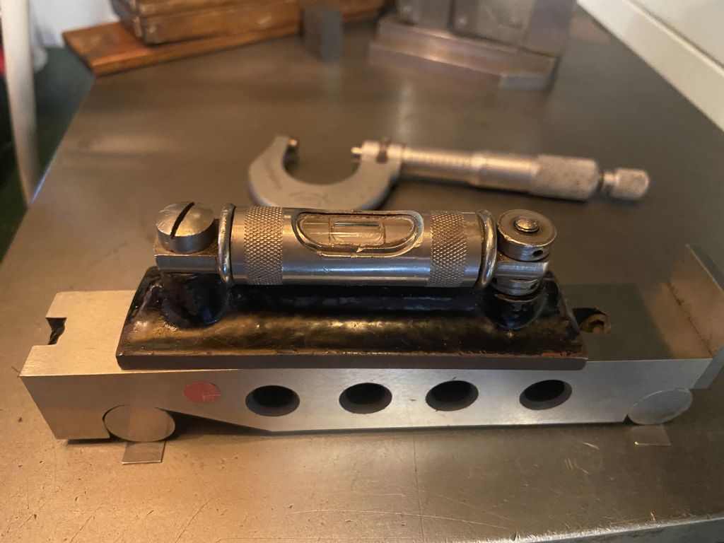

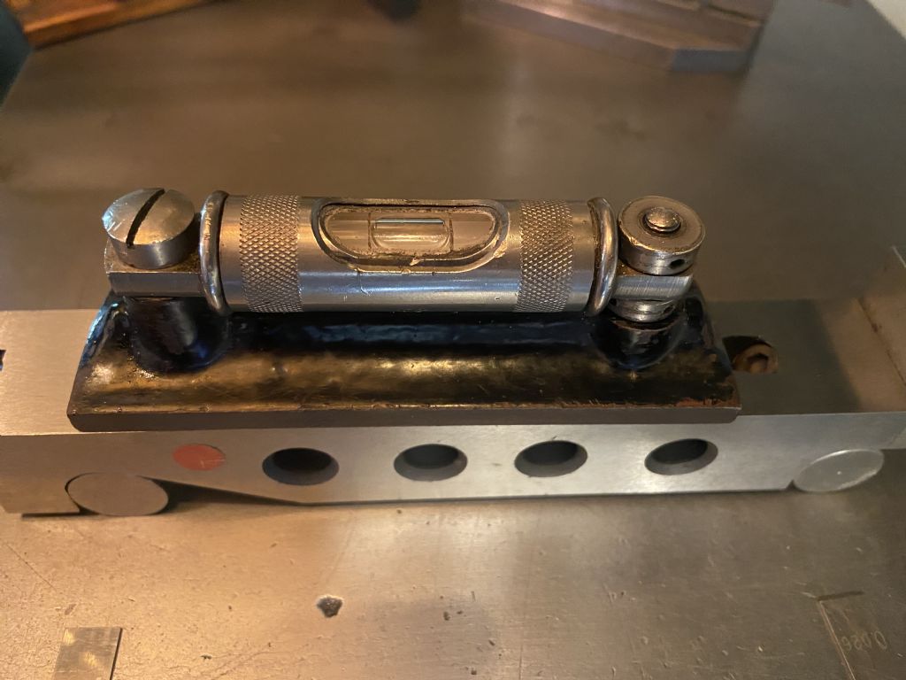

                        Posted by SillyOldDuffer on 03/10/2021 10:16:07:
                        To be explicit, an ordinary bubble level won't cut the mustard. They're good for putting up shelves and most other purposes but aren't sensitive enough to detect a twisted lathe bed.
                        You need an Engineers aka Machine Level. They are made to detect tiny deviations from level, as required to set a lathe accurate to a thou or two over several inches. Typically, in a new installation the lathe stand is set up with an ordinary level first, and then the lathe is tested. If not cutting straight a Machine level is used to check for bed twist, which can be corrected by shimming a foot: some machines have screw-adjustable feet.
                        This example is made by Dasqua and sold by RDG.
                        In theory new lathes are confirmed to cut straight on a true level surface in the factory, so plonking them down on any decently stiff flat surface should be good enough. In practice, don't expect too much of inexpensive hobby or elderly lathes. Note flat rather than level. It's not necessary for lathes to be level provided the bed is straight: they work perfectly well in storm tossed ships. Levelling is just one way of eliminating twist, and a bent stand is one way of accidentally twisting a machine.
                        In my book Machine Levels aren't good value for money. Pricey and much too sensitive for ordinary work. Fussy and the bubble takes an age to settle. Good for anyone installing lots of machines, dubious for putting one into a shed! After being used once to set-up the owners lathe, I suspect most Machine Levels end up in a cupboard. As an alternative, Rollie's Dad's Method takes longer and is more complicated to do than detwisting with a good level, but it requires no special equipment.
                        A word of warning: high-precision measuring is so difficult it's quite easy to lead oneself up the garden path into a deep maze of confusion. A wobbly DTI moving on a slide will cause trouble. When measuring into the 0.02mm / 0.001" region don't rush to adjust anything based on amateur measurements: they're likely to be flawed because taking them properly is a skill you don't have!!! Therefore, keep measuring simple and use the right tools: detect taper with a micrometer, not a DTI. Check everything – it may take several hours practice to get a micrometer to repeatedly read the diameter of a precision rod consistently. Positioning the micrometer correctly is important, and so it applying the same pressure to the screw every time. The ratchet helps, but trained craftsmen rarely use it; they develop a 'feel'. Some are better than others, so find out how good you are by practising. In the meantime, don't jump to conclusions!
                        Thanks for taking the time to explain all that Dave.
                        My little rabone level is obviously an engineers level of sorts, it is adjustable, with a ground bed and far more sensitive that a regular spirit level. Whilst it may not of give me absolutely precise measurements, what it did do was give me a “direction of travel“ and magnitude for the amount of twist that there might be. When I started shimming up 1 foot of the bed, it moved substantially, and was useful in that it told me the direction of twist and that it was quite considerable, and if I continued shimming, it would probably damage the lathe.
                        I do need to work on my micrometre technique, positioning it in exactly the right place and square, particularly on a round surface, does seem tricky. I’m not yet convinced I get the same answer every time.

                          Your Rabone might be part of the problem. Thing is, hitting the target is downright difficult if the level isn't sensitive enough for this job. It may be necessary to remove or add so much shim to move an insensitive bubble that the bed twist is always over or under-corrected. For this reason have a look at Rollie's Dad's Method which only needs a rod and DTI. Although the instructions look complicated at first, the Rollie's is actually quite simple. Don't fixate on the Rabone just because you have one!
                          An indication of sensitivity is how fast the bubble moves. Engineering levels are poor for putting up shelves because tilting the shelf half a millimetre causes the bubble to shoot across the scale and disappear. Conversely, when measuring a fine level correctly, an engineering bubble moves very slowly across the scale maybe requiring a minute or two to settle before the measurement is taken. Another difference, Machine Levels are usually graduated, whilst ordinary levels aren't.
                          It's possible to estimate the Rabone's sensitivity by laying it on a stiff beam, say 1 metre of 2 by 4" or similar, and packing one end of the beam so the Rabone bubble is centred. Flipping the Rabone around should put the bubble back in exactly the same position. Assuming it passes that test, use a strip of aluminium cut from a drinks can to lift one end of the beam. (About 0.15mm). If the Rabone really is a Machine Level, the bubble should move to indicate the tiny change of angle caused by inserting the strip. Actually, a Machine Level should be sensitive enough detect even smaller changes.
                          Given it's unclear the Rabone is fit for purpose, don't rush to twist the bed based on it – cast-iron breaks easily if overstressed in tension.
                          Stick with it – realigning a lathe from scratch may be time consuming but it's highly educational! As a beginner wanting to get on with metalwork rather than fixing machines, I bought a new Chinese Lathe to avoid this sort of shenanigans. The problem with second-hand is condition is uncertain, varying from 'as-new' to 'completely knackered' via 'maladjusted' and the other circles of lathe hell. The good news is 'maladjusted' can be fixed, but depending on what's wrong it may take a fair amount of effort, especially if skills and tools are limited. For example, in the factory the headstock of an inexpensive early lathe would have been aligned in a few minutes by a trained man using a jig. Newbie in a shed 70 years later has to work from first principles, which is much harder.

                            Please permit me to say, Dave, that the little Rabone does appear to have adequate sensitivity … even though it does not have the additional graduations.
                            Steve has demonstrated to us that the bubble moves substantially with a 4 thou' tilt, so one thou should be easily detectable. … It think it may be more a matter of technique.
                            #565491
                              Posted by Steve355 on 02/10/2021 22:06:57:
                              here is a 0.004 feeler gauge under one end. I would imagine that makes it sensitive enough to be useful?
                              Q.E.D.

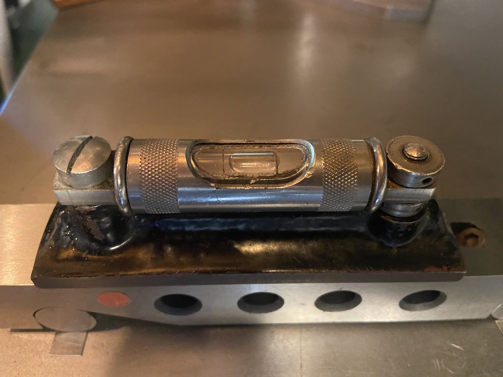

                                  Just to (probably not) settle the question of whether my little Rabone level is any use or not, I remembered I had picked up some other gizmos in my eBay travels – some gauge blocks and a sine bar.
                                  here’s the level on the plate…
                                  5 thou….
                                  1 thou….
                                  so, well, inconclusive. 5 thou is very clear, the level isn’t quite straight in the 1 thou pic. I will give it a good clean on the base.

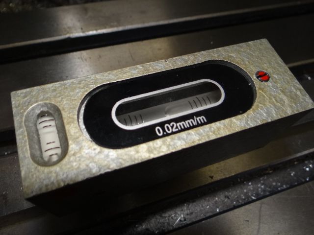

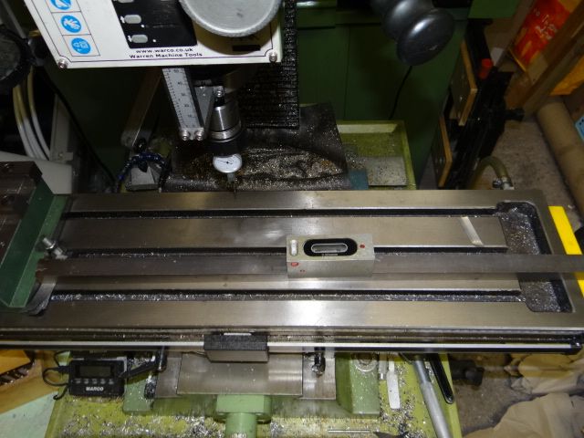

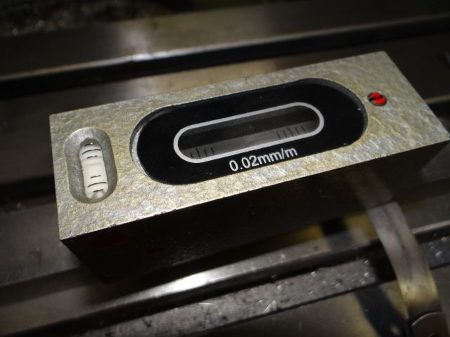

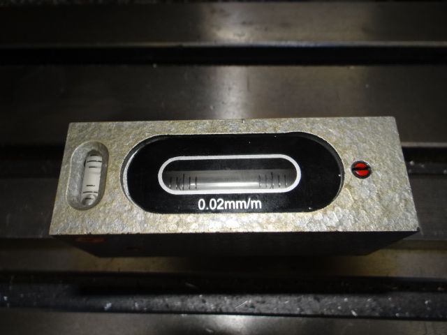

                                          Posted by Michael Gilligan on 04/10/2021 11:39:44:
                                          Q.E.D.
                                          The case for the defence. I think I show my Machine Level to be considerably more sensitive than Steve's Rabone.
                                          The apparatus is a 670x30x20mm bright mild steel bar laid on my milling table, with a Level in the middle, shimmed at one end so the bubble is nearly level. It's a bridge:
                                          The beam isn't quite level: nearly 3 graduations right, 2 left, a slope of 0.02mm per metre, about 0.001°. It takes the bubble just over 10 seconds to settle in this position after hands-off.
                                          Unlike the Rabone which was tested with a 4 thou feeler, a 3 thou feeler under the right hand side of my level moves the bubble well outside the graduations – the resulting slope is bigger than the level can measure:
                                          Inserting a 0.15mm shim at extreme right (370mm away from the level, about 0.023° ), also moves the bubble off-scale. The graduations can't be trusted.
                                          My thinnest feeler is 1.5thou (0.059mm). Inserting it 370mm from the level moves the bubble off-scale, but it can be guestimated at about 4 divisions. To really test the level by shifting the bubble a graduation or two, I need a shim about 0.02mm thick at the far end. Can't think of anything 0.02mm thick to use: cigarette paper maybe but I expect it's too soft to take the weight without deforming.
                                          Happy to have the methodology criticised, for example that 20x30mm steel bar must be bending slightly! But I hope m'learned friend and the jury accept the Rabone isn't anything like as sensitive as my genuine Machine Level. Whether the Rabone is good enough to level a lathe is another question: I think not, but I'm often wrong…
                                          For most other purposes the Rabone is a far more practical instrument than my Machine Level. It's a pain in the proverbial in action: far too sensitive, nothing but fiddle, fuss and bother. Not one of my best buys! But it does do accurate levelling when that's really needed, way better than a Wixey or an ordinary Spirit Level. Ordinary Spirit levels get far more use in my workshop though, simply because most practical levelling is done better with a sensibly insensitive instrument! As tiny amounts of twist cause a taper, lathe beds need a sensitive level. Or consider Rollie's Dad as a alternative!

                                              Posted by SillyOldDuffer on 04/10/2021 14:16:10:
                                              No problem with that, Dave … and thanks for the demonstration photos yes
                                              At the risk of sounding like a Weaselly Politician or Lawyer : I did carefully write that “the little Rabone does appear to have adequate sensitivity ” … which is not to say that it is ideal for the job.
                                              If Steve can use it to check that his lathe bed is free from any more than 0.001” of twist in 4” across the ways; then I would maintain that it has served the purpose quite adequately. … It will obviously need more ‘imagination’ than doing the same check with a more sensitive bubble and graduations; but on a modest small lathe, of some considerable age, any better than one thou in four inches is probably a pipe-dream.
