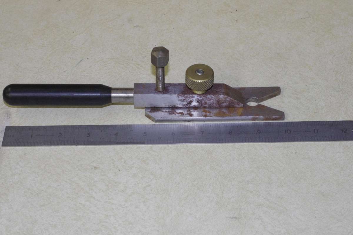

      Amongst the items that the museum has inherited over the years is this tool which nobody can identify. It is very high quality, with ground surfaces, and might be used in a similar fashion to toolmakers clamps.

      roy entwistle
        @royentwistle24699
        I’ve always known it as a finger plate

        Bazyle
          @bazyle
          If you are familiar with a fretsaw rest which typically has a V notch in order to ensure the wood is supported each side of the cut I think this is a simple hand vice with a plate similarly arranged to give support when filing or sawing thin metal.

          old mart
            @oldmart
            It must be unused, there are no signs of file or saw damage. I will see that one of our volunteers who runs the model club gets a look, it may be useful to them.

            Diogenes
              @diogenes
              Don’t / didn’t ?Grobet (or) ?Vallorbe favour black ‘sausage-shaped’ handles for their piercing saws?

              Grizzly bear
                @grizzlybear
                Hi,
                Grobet finger plate – Search Images (bing.com)
                #730228
                  It certainly has a Grobet look to it:
                  https://www.hswalsh.com/product/grobet-swiss-jewellers-piercing-saw-frame-fixed-ts122

                  peak4
                    @peak4
                    I use my shop made version for holding small components when drilling them.

                      Rod Renshaw
                        @rodrenshaw28584
                        As Peak 4  Bill,
                        I am fairly sure I made mine after seeing a sketch in one of the ME mags or books. I find it quite useful, for smallish holes, and it was a nice quick satisfying thing to make.

                        Bo’sun
                          @bosun58570
                          Mmm…. with “ground surfaces”.  That’s a bit grand for a Fretsaw rest.  With the tool in question in one hand (assuming that’s what the handle is for), and a Fretsaw in the other, fine control isn’t going to be the best.  Also, having to stop and unclamp the work frequently to advance the cut is likely to become somewhat arduous.

                          Speedy Builder5
                            @speedybuilder5
                            Clock making ?  Hold the gear with its shaft through the round hole. Hold the black handle and rest the vice end against the edge of the workbench and file the gear tooth to profile ??

                            old mart
                              @oldmart
                              There are no makers names anywhere on the tool and even the hole looks to have a ground surface. It could hold work up to 1/4″ thick. The rust is superficial and would be easy to remove.
