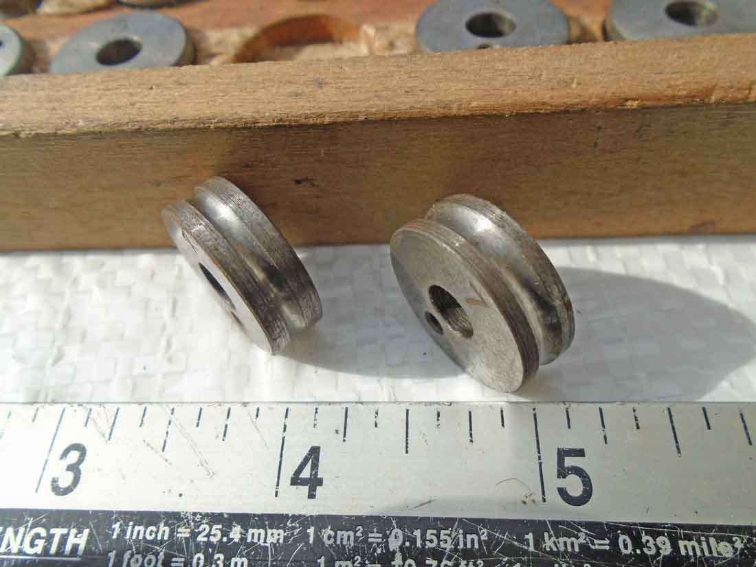

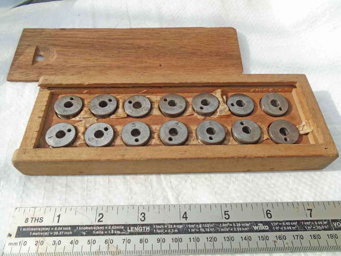

      Hi All,
      This lot came in with some watchmaking tools and a Pultra lathe that i have been after for a long while!
      I do not think they are to do with watch or clock making but not sure and would love some info on them please.
      They are of hardened steel. Cheers, Martin
      boxwatch 1boxwatch 2

        Rolls for a wire/rod bender?
        #723051
        Diogenes
          @diogenes
          ..^//or tube bender.?.  ..do the numbers refer to the diameter of the material to be formed..?

            Hi All
            Someone has said they are jewelers ring formers but I do not see how you would get the ring of the tool?
            Martin
            #723184
              “Someone” was quite correct, Martin
              But the point, perhaps not mentioned, is that the tool is used for re-forming the shape before soldering the ends.
              The classic bench tool looks like this one:
              https://www.ebay.co.uk/itm/300401358053
              #723185
              Robert Atkinson 2
                @robertatkinson2
                For a ring rolling tool these would be the part that is rotated around the outside of the ring with a mandrel on the inside. These are sized for the rod diameter, the mandrel sizedfor the ring diameter. The rings may or may not be jewlery.

                    In the eBay link, the mandrel is plain, suggesting the item to be rolled is flat where it touches on the inside.
                    Hence, I wonder if there is a better descriptive term than ‘rod diameter’. Let us say I want to roll a ring tomorrow. What should I search for to find the correct shape of material to use? I can find ‘half round bar’ but would a ring use material that is full semi-circle?
                    Second, what do the numbers in the photo above refer to? Is it simply that 4 is bigger than 3 or do they relate to a measurement system?

                        I think jewellery rings are of part-circular form, but I would first see if the numbers are of mm.
                        Measure the diameters of the grooves themselves (not of the entire roller) and see if the sizes and numbers correspond.
                        Bear in mind they might be slightly shallower than a full semi-circle, but if so should follow a regular, identical or proportional, difference.
