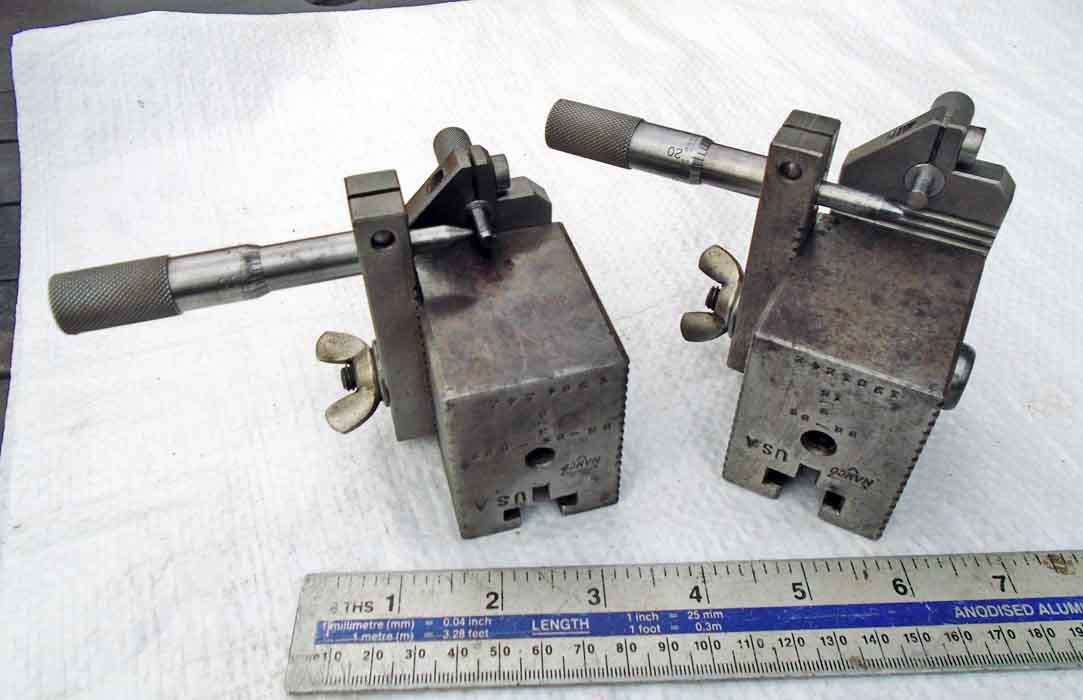

      Hi All.
      These two items were just blobs of rusty grease when I dug them out from the bottom of a large crate of tooling most of which has gone to the scrapyard:
      namco 2namco 1namco 3namco 4
      To my amazement they have cleaned up really well and even the small micrometers by LUFKIN USA are now all good.

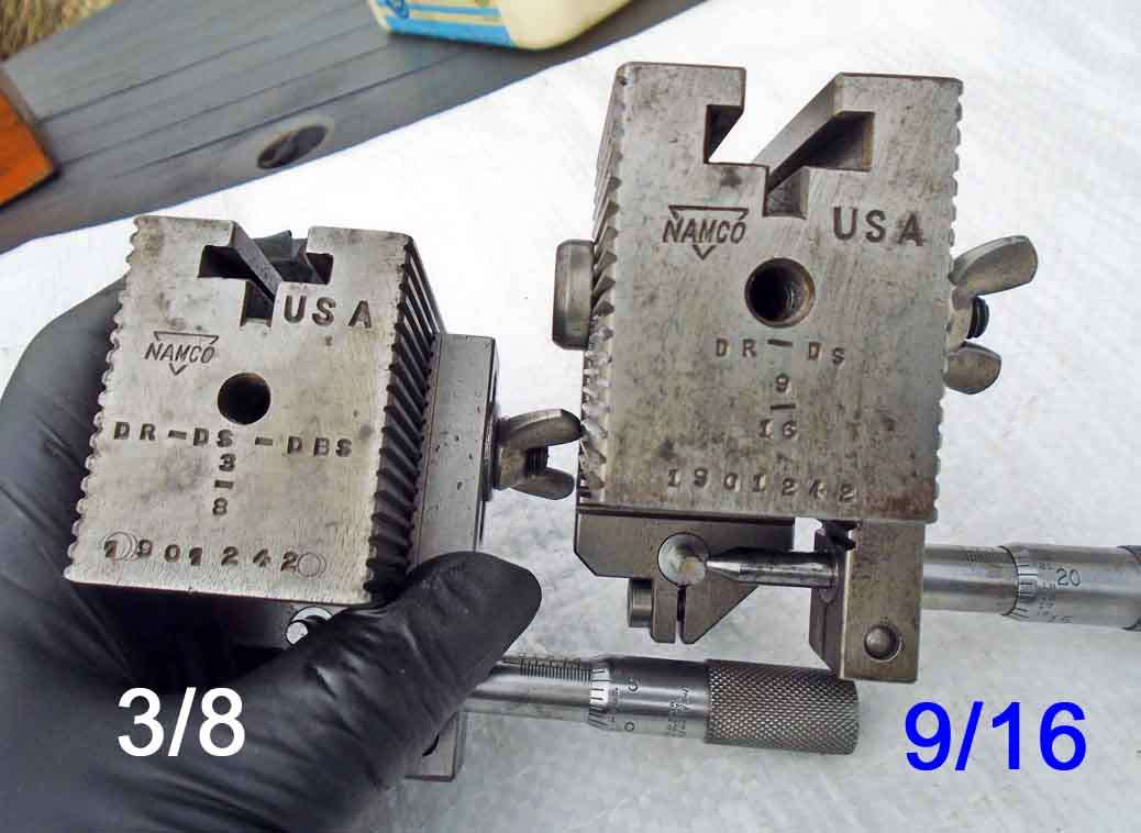

      As to what they are for, I would love to know? They are stamped with two different sizes 3/8 & 9/16 as shown.
      What the DR-DS-DBS is all about I have no idea!
      Cheers, Martin

            On Michael Gilligan Said:
            … and for the eternally curious:
            Thankyou. I have downloaded the full seminar in pdf as they allow. That is very useful information on dieheads.
            The eBay link shows the same tool made by a few people (Herbert, BSA, etc.).
            Some discussion of NAMCO here:
            https://www.practicalmachinist.com/forum/threads/herbert-namco-etc-thread-setting-gauge-uses.380879/
            Edit: the link explains the DR, etc. as the diehead model with which the gauge is to be used.

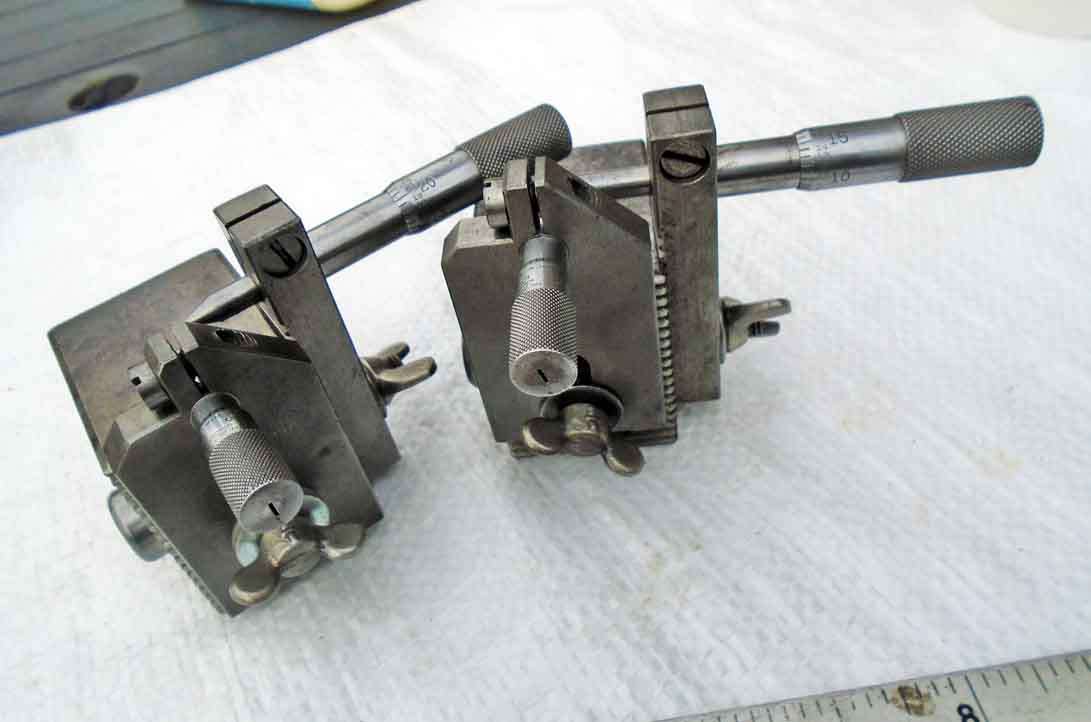

              Hi Michael,
              Thanks for that; NAMCO did not come up when I looked in EB?
              Blimey! that second link looks complicated! Somewhat specialist tooling it would appear.
              I have a feeling that from my point of view I will do better with the 4 Lufkin Micrometer heads on their own as they will have a appeal to the watchmaking community etc. We shall see.

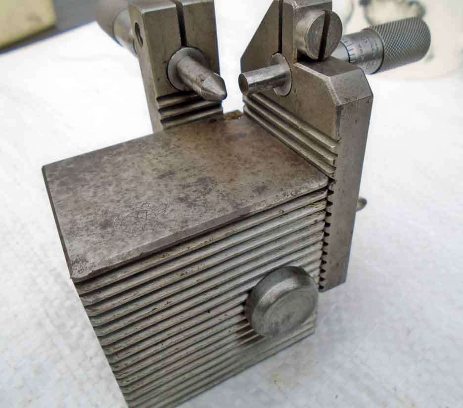

                If you squint at them a bit and imagine the micrometer heads removed, they look to have potential to hold drill bushings and be used as drilling jigs.
                The step-by-step indexing of the parts clamped on the side gives good adustability. I think if you inverted the clamped-on parts so the top was the part with the T-slot, they might be even more versatile.
