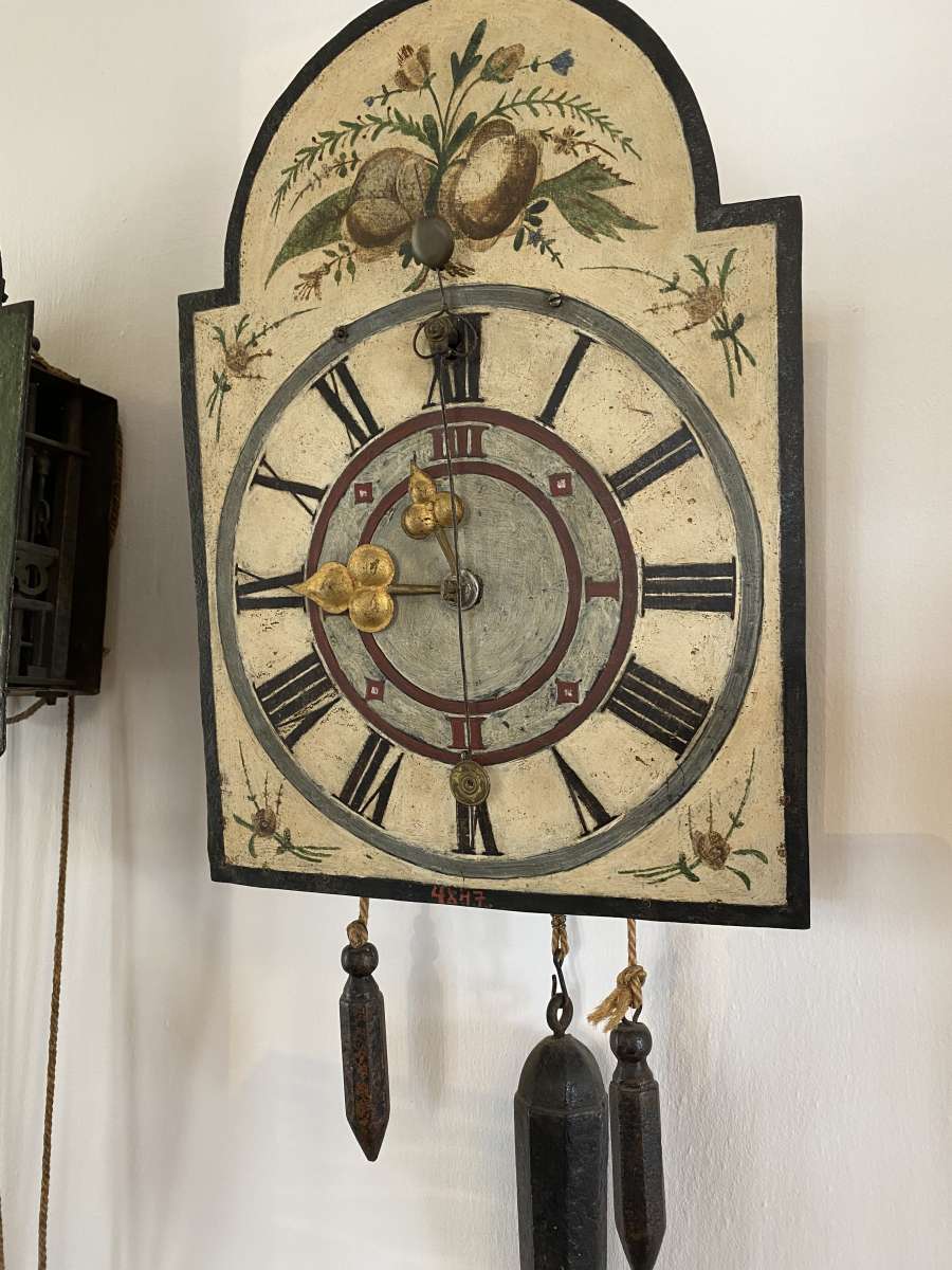

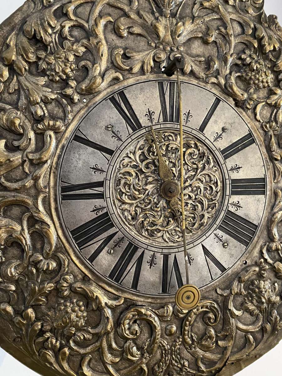

      I recently had a holiday in Bratislava. While there , we visited a clock museum where there were a number of clocks with the pendulum over the dial face. Not come across this before.
      David
      IMG_0714IMG_0716
      #727562
      bernard towers
        @bernardtowers37738
        What sort of escapement David?
        #727579
        speelwerk
          @speelwerk
          Its a verge escapement with a so called “kuhschwanzpendel”  (cow tail pendulum), common in middle Europa. Niko.
          #727585
          bernard towers
            @bernardtowers37738
            Thanks
            #727587
            David Noble
              @davidnoble71990
              I’m glad you answered that Nico, I had a look behind the clock and all of the mechanism was encased in a brass cylinder about 4″ diameter and 3″deep so I couldn’t see anything.
