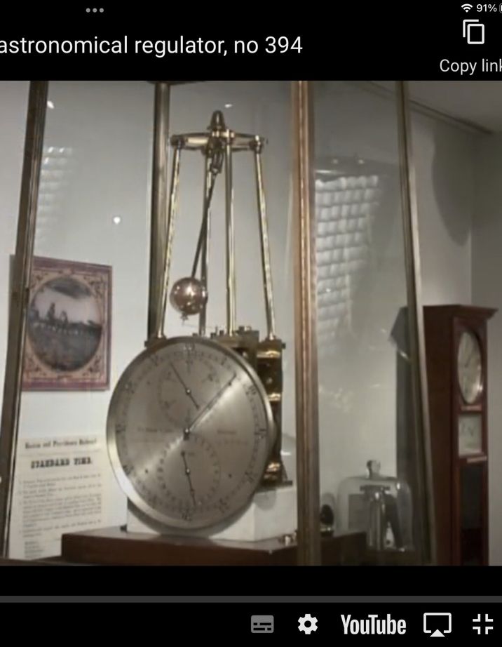

          And in the video (thanks Michael) what about those missing gear teeth from about 4:10?
          Ensuring synchronised re-engagement has to be yet another clever piece of the design.
          Albeit set by hand, that was a problem I encountered during the design and construction of the mechanism for a popular TV game.
          Sam

            The missing teeth were, I believe, an improvement introduced after the original build
            I do have some information about the modification, but cannot locate it at present. blush
