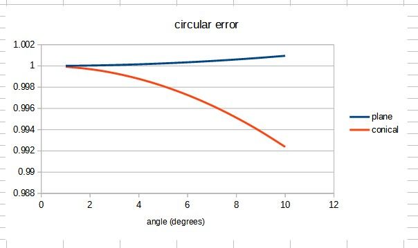

                                Contributors have rightly pointed out that the period of a conical pendulum is dependant on the angle of the cone. However, the period of a plane pendulum is also dependant on the angle of swing, it's just that for small angles this error is very small. Using the formula for a conical pendulum I found in a previous post, and one for plane pendulum with greater amplitude found at large amp I have plotted the attached curve. I actually only used the first 2 terms in the equation, which is slightly cheating as the conical uses the cos() term. There isn't a lot to choose. I don't know how you control the amplitude of a conical pendulum, it feels like a trickier job than a normal escapement.

                                    Yup, wrong attachment, here's the right one. The blue line is the first three terms of the link as in
                                    sqrt(1+a^2/16+a^4*11/3072) where a is the half amplitude
                                    the red line is sqrt(cos(a))
                                    the plane pendulum appears a lot better on this basis, so apart from novelty value why use conical?

                                    #602498
                                    John Haine
                                      @johnhaine32865
                                      Posted by duncan webster on 20/06/2022 17:35:35:
                                      That's an excellent question!

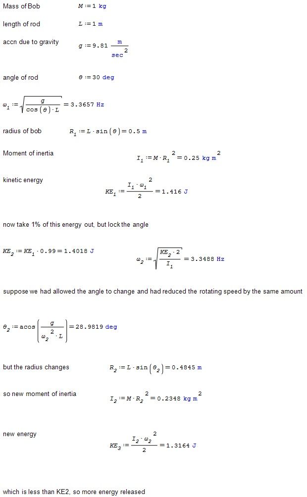

                                                  A conical flywheel makes a lot more sense. If you take a small amount of energy out, the speed drops, so the ball radius drops, which means that the drop in speed is less than it would have been if the radius was fixed. I could do some sums, but it's too hot.

                                                    That makes sense Duncan. Intuitively when the spherical pendulum does work the slowing of the angular velocity causes the bob to fall and the radius to reduce which transfers potential energy back into kinetic energy which moderates the loss of angular velocity which is what you said. I did look for the maths but as it hared off into Hamiltonians and Lagrangian mechanics I gave that up as a bad job.

                                                      The sums required an ice pack, for reasons I'll go into later. taking equations 1 & 2 from my original link and doing a bit of re-arranging you get cos(theta)=g/(w^2*L). Then taking a mass 1 kg on a rod 1m long rotating at such a speed as to make the rod be 30 degrees from vertical
                                                      so the conjecture is proven.
                                                      The problem comes when the angle gets lower, in fact if L*w^2<g you get cos(theta)>1 which is impossible. I think this reflects what happens if you have a ball rolling round in a curved dish, there comes a point when the ball stops rolling round in decreasing circles and heads for the middle, but if anyone can confirm my ramblings I'd be happier.
