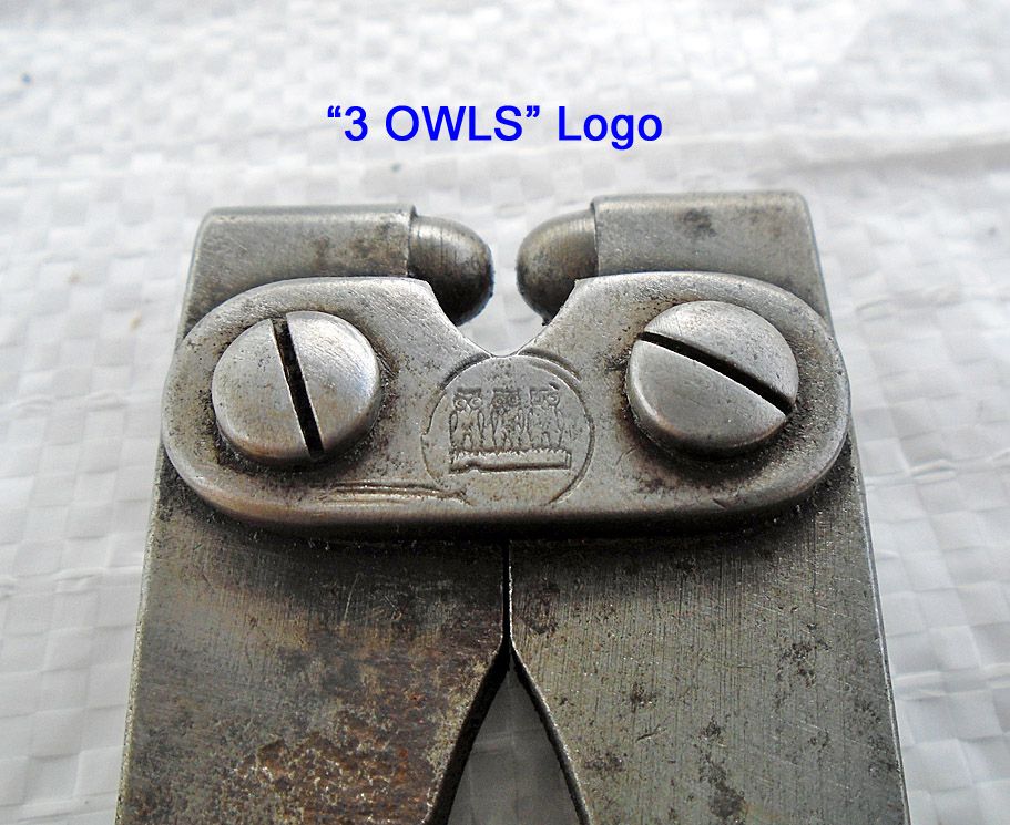

      Hi All,
      Here we have a long handled set of compound action pliers with ball jaws.
      When fully closed the ball just touch; when wide open the gap is only about 2mm or a bit less.
      No makers name but a really cute "3 OWLS" logo as shown.
      What on earth are they for please?
      Cheers, Martin

          Another eyelet crimper?

            John, That was my first thought also, but it does not open wide enough for any eyelet i have seen?

              Via a fairly circuitous route, involving disabling some security settings etc, they seem to be
              "Ball peening pliers" recommended for use on IBM typebars when repairing typewriters
              See this old catalogue
              https://typewriterdatabase.com/1960-Ames_Gen_Cat_10-March.shop-tools.manual
              The link is OK as far as I know, it's just my method of finding it was a bit odd.
              You need to scroll just over half way down the page.
              See also;
              Collectors Weekly to find the logo
              https://www.collectorsweekly.com/stories/248422-unknown-silver-hand-tool-marked-made-in
              Google Eye on the left hand image led me to a different item, but explained the industry
              https://www.etsy.com/dk-en/listing/961853147/vintage-nineprong-bending-pliers
              Google search on "Typewriter repair tools 3 owls" led me to a security blocked site, (though I think it's basically OK) for Theodore Monk, who referred to a 1960 Ames Catalogue, and searching for that found the very first link in this post
              For their use, see P 68 of This large pdf it shows up as 207 of 490
              http://www.bitsavers.org/pdf/ibm/typewriter/25-6007-0_Electric_Typewriters_CE_Ref_Man.pdf
              From the Theodore Monk website, which may well show as clear, depending on your browser or ISP
              Question
              "Hi, I have recently acquired 3 tools, which after lots of searching have identified as for typewriter repair, they have a logo with 3 owls on a branch inside a circle, would anybody know the name of this brand, as I haven’t been able to find out anywhere else!! Many thanks."
              Answer
              "Dreusicke brand (German). Used by Triumph-Adler and possibly many others"
              I can't se them listed on their web site, but the logo looks correct
              https://service.dreusicke.de/
              They seem to have won a design award in 1954
              https://ifdesign.com/en/winner-ranking/project/kombinations-typenjustierzange-fur-schreibmaschinen/2765

                Bill, WOW! Amazing piece of research, thanks very much indeed!
