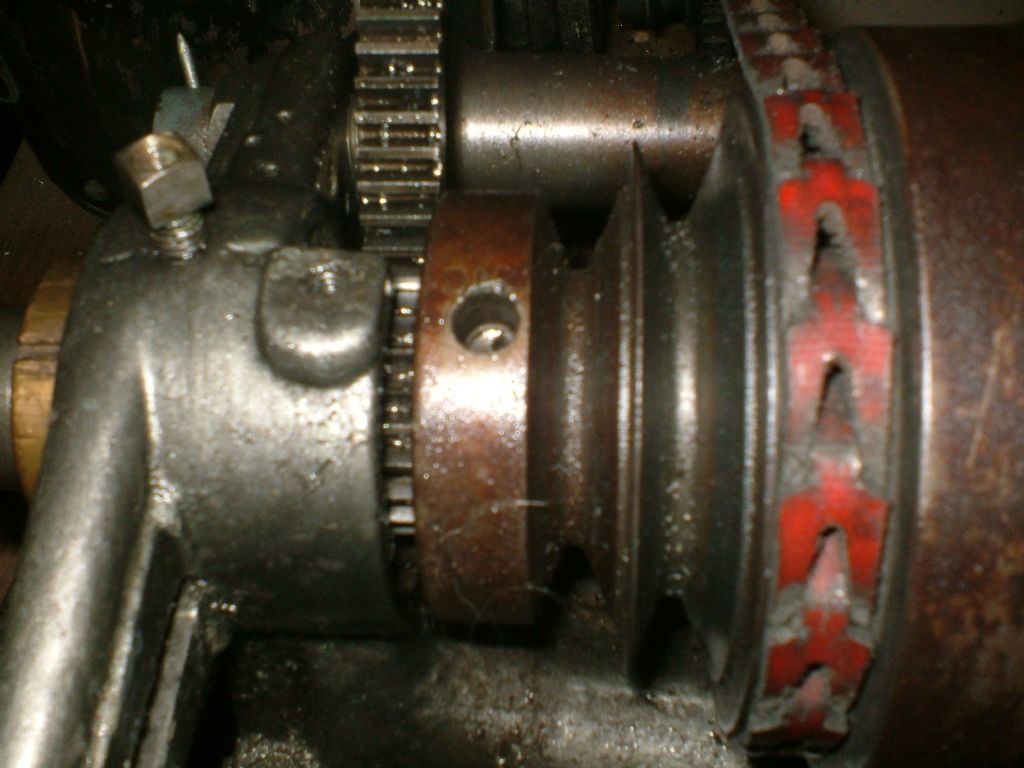

      The easiest route I've found on a Myford M series is to use the backgear
      A bit of wood on the bed (at a right angle) and a roundbar into a hole in the belt pulley
      A bit of pressure on the bar from left to right (moves pulley backwards about an inch or two) and the chuck unscrews itself
      Zero violence required
      I think the reason it works so well is because the 6:1 ratio (or so) of the backgear allows you a lot of control over how much pressure to apply (plus the block of wood gives you a decent 90 degree lever at the spindle nose) and the chuck is removed with the absolute minimum pressure necessary to achieve success

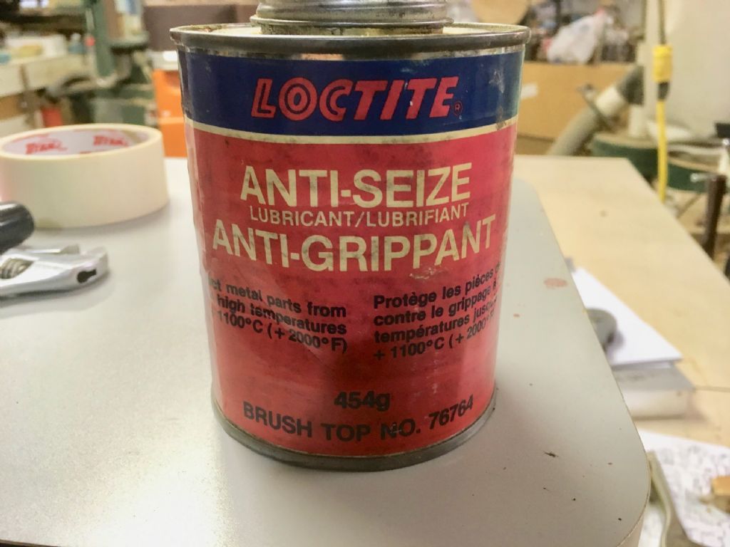

            Larry here is a shot of the material I use.

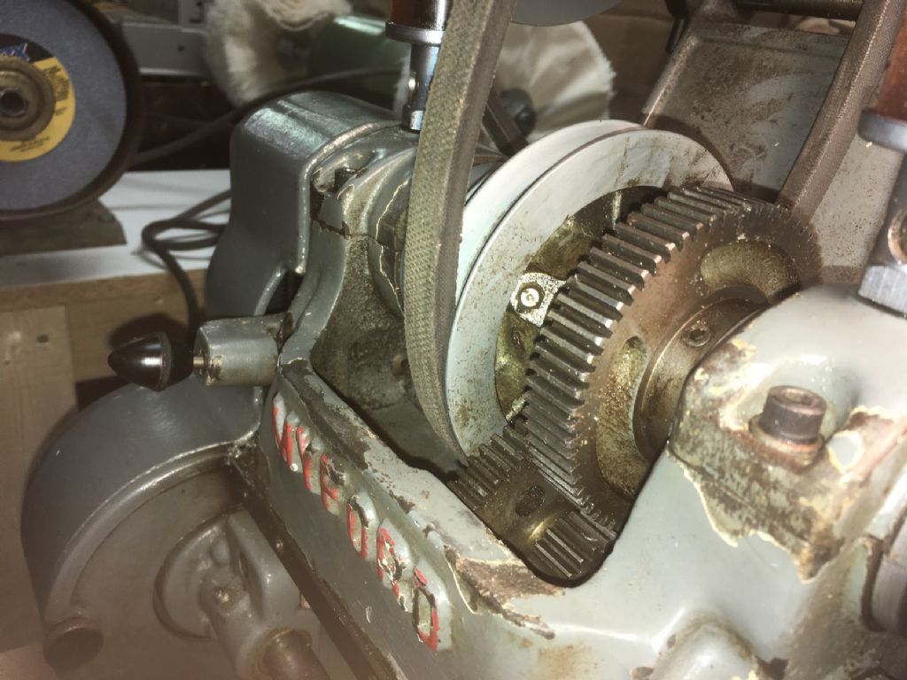

            never seizeAfter reading and re-reading all the suggestions in this thread I took a closer look at my ML7 and note that there are grooves/slots in the sides of the Bull Gear. So I'm wondering why I can't use them to 'lock' everything in place. Here is a photo of the side of the Gear.

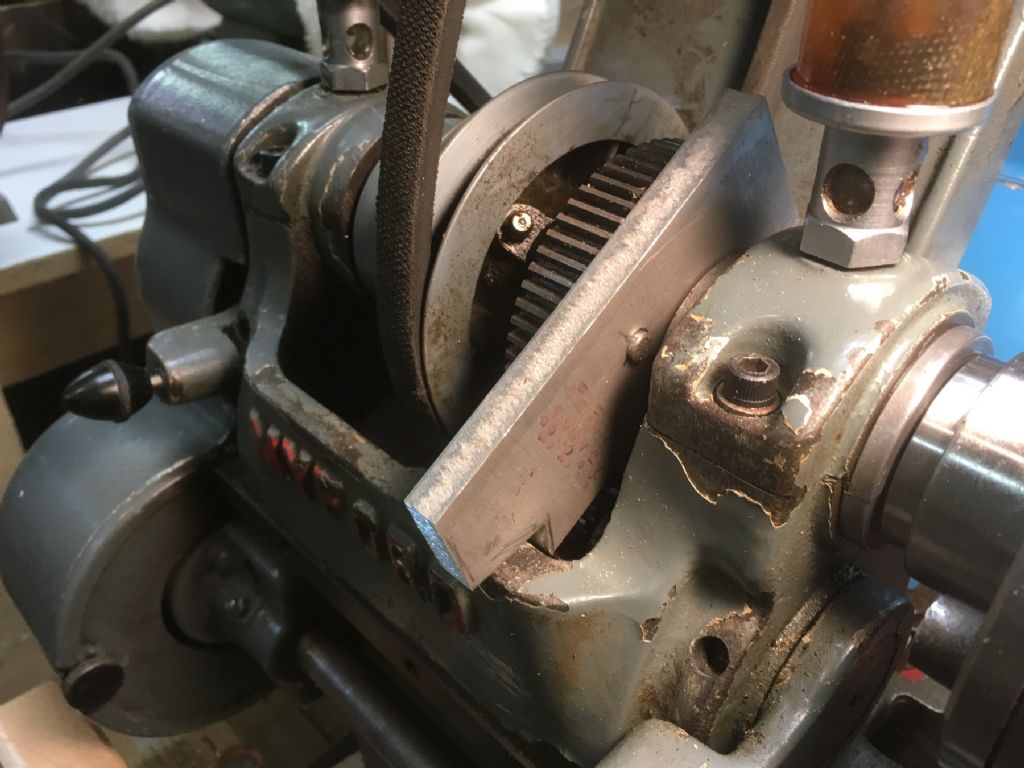

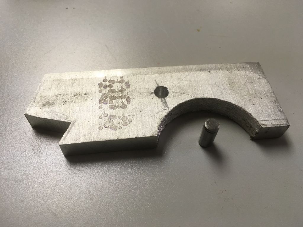

            bull gear1Here is a photo of the tool I made from a chunk of 3/8 aluminum.
            tool
            Here is a shot of it in place. I push the pin into the slot and have cut a small slot in the pin that I can use to gently pry it out of the grove when I'm done.
            new tool
            Seems that it should work pretty well especially if the chuck is maintained as has been suggested. Of course my chuck is no longer stuck so I really haven't yet had a chance to 'test' it properly.

              Can you provide anymore detail relating to the hole in the belt pulley?
              There was already an oiler hole in my pulley of about 9mm, I use an 8mm bar
              If you are going to drill your own hole make sure the pulley casting is solid and not hollow at the drilling point
