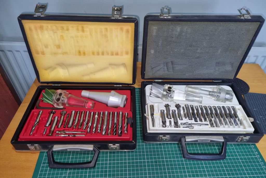

      a20221221_153430.jpgHi

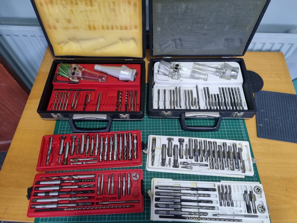

      I am in the process of clearing my Dad’s house and workshop and came across these two cases.
      I have seen milling Clarkson chucks before, but never in plastic! One is aluminium and the large cutters attached (one Green) are aluminium.
      They both have 3 trays of cutters all either 6,8,or 10mm all HSS.
      Has anybody seen these before?

          I suggest a salesman's demonstration sample.
          #636248
          DC31k
            @dc31k

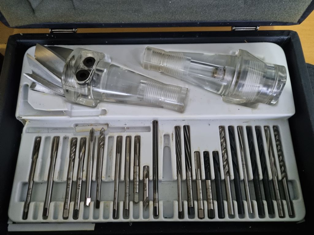

            The reason they are made of perspex is so you can see how the cutter relase mechanism of the Dedlock chuck operates and how the cutter is gripped in the Autolock chuck.
            The empty pocket in the middle of the first photo looks like it should contain the Dedlock release key.

                Thanks, I needed some more views, I was thinking training equipment, but wanted to check there was not some odd anti-static / Spark use. When you look at these and see how the system works it is a very clever idea.
                I will now try and write an ebay advert to see if I can find a collector
