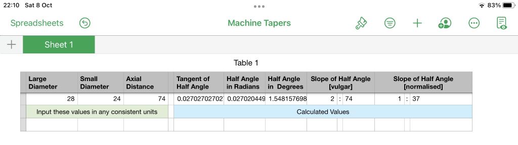

measure major and minor diameters, a carefully measured distance apart..
Convert your dimensions to Imperial and use those, to calculate in various formats..
The taper can be expressed in a variety of ways, Angle, Half Angle, Inches per Foot, Inches per inch.
