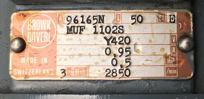

      I spent a couple of hours, yesterday, cleaning and admiring this machine … Major reorganisation of the workshop will be required before I can use it; but so far, it looks superb.
      Now … The Motor for the high-speed head:
      … feels mechanically perfect, and I would really prefer not to start digging-around inside it.
      Can anyone suggest a suitable VFD question

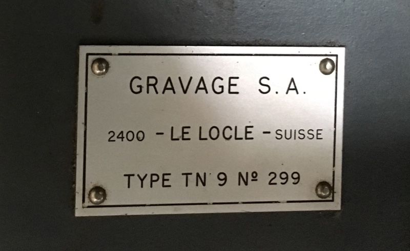

              Another clue to the machine's parentage:
              This plate is on the engraving pantograph [currently lurking in a big plastic box]

                  I would check that the motor can be wired for delta which will give you a good choice of inverters to choose from, if delta connection is not possible with out digging the star point out of the windings then you are limited to one of the inverters that claim to give a 400v output from a single phase input. I would be interested to know how they do that.

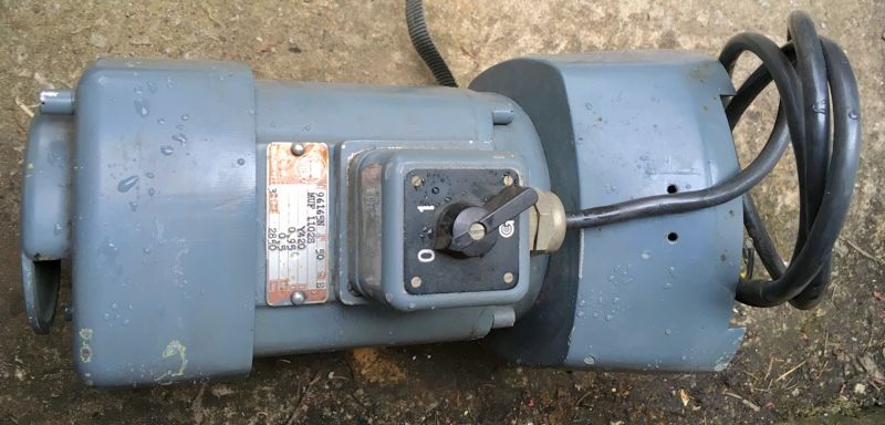

                    This rather poor photo [it was just coming on to rain] shows the very neat self-contained motor & switch assembly, which I am somewhat reluctant to dismantle.
                    Hopefully … Someone might come along to tell me just how easy it is !!
                        Michael I think you are going to have to dismantle it.
                        Others will need to see how the connections are arranged so a photo of the inside will really be required. This will help to see if the star / delta connection points are easily accessible.
                        If they are not then all is not lost. – Easy way if not 100% sure of your ability to rectify the issue would be to jump in your car and drive to Warrington. (not too far from you) and take it to **LINK**
                        They are a very helpful and knowledgeable bunch and will supply, connect up and programme for you the required equipment to the motor if needed. They will even dive inside a motors windings to retrieve the required connections if not easily accessible.

                              The Brown Boveri motor is for the high-speed drilling and milling head [which appears to be the genuine Aciera F3 unit]; but there is also another 3-phase motor [small, but as yet unspecified], buried in the base of the machine, to drive the pantograph spindle.

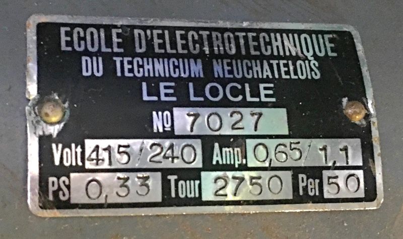

                                      2. Removed the motor that drives the pantograph spindle, from the base of the machine … This one is dual voltage smiley and the nameplate might [just possibly] explain the origin of the 'TN' branding.

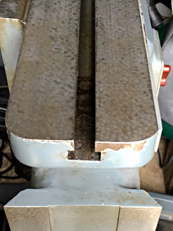

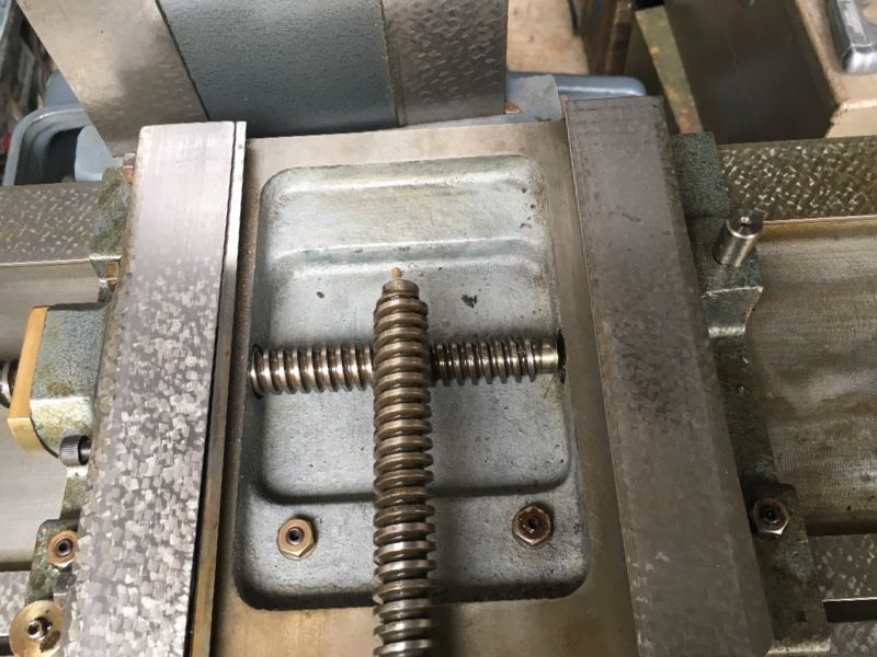

                                        A little more cleaning and general familiarisation today The build-quality of this machine is absolutely stupendous.
                                        I removed the gib strip from the 'Y' slide, just to clean the old oil 'varnish' from it … The strip is beautifully ground on all six faces, and has a hole for a location pin; the adjusting screws all bear on little brass slugs, shaped to the dovetail angle.
