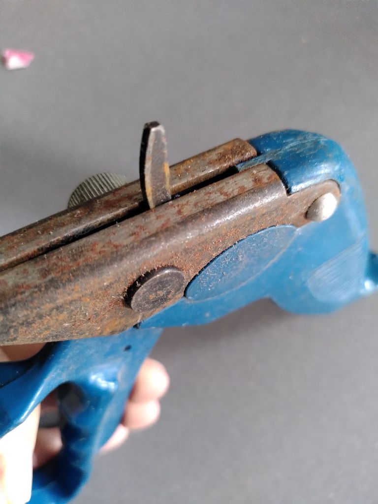

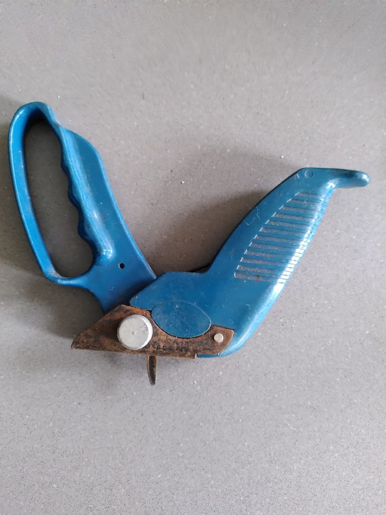

The blades are exchangeable, thick beefy ones are for sheet metal, slim ones like that in the photo are for laminates.
I had one for nibbling Veroboard and Printed Circuit Board. They're meant for thin sheet, not car body work, for which a heavier version with longer handles is available.
