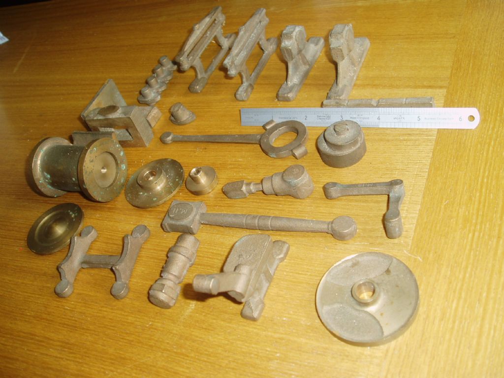

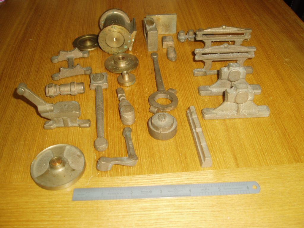

      I wonder if anybody can identify these castings. I was given then by a friend who's brother had died and he didn't know their source nor did he have any drawings
      p9040247.jpg.
      Perhaps some of the more distinctive ones will trigger some memories.
      Some bear numbers starting with an "M"

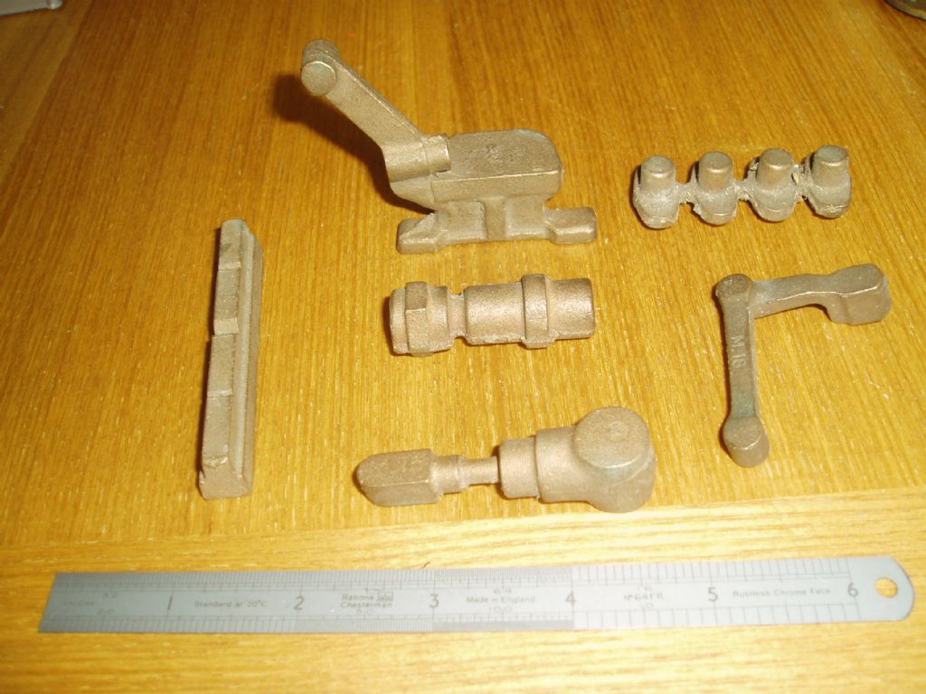

          At risk of stating the obvious, but not knowing your background knowledge of model engines, it looks like some type of horizontal mill engine, judging from the cross heads and bearing pedestals etc.
          Not sure what the gizmos in the last pic might be. Reversing gear? Governor?

            Thank you for a speedy reply. Sorry, my introductory post seems to have got lost. I have been a model engineer on and off for a few decades and am aware that they are indeed for some horizontal engine but which or rather who's design is the mystery. Another strange thing is that the cradle shaped casting is too long to fit between the cylinder casting's flanges which is where I imagined it to be used.

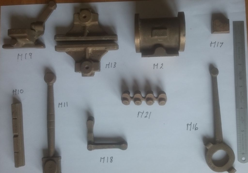

                    The cylinder bore is 1" and the casting is 2 1/8" overall, the piston is 3/8" lang and if the disc is the crank then it would point to the stroke being 1 1/2". The numbers are as followed :-
                    PS   …..and if you haven't already guessed M17 is the valve
                      Could it actually be two separate parts connected by a casting sprue which has not yet been cut off? Each part seems to have its own mounting holes so I don't really see the point of the connecting bar.
