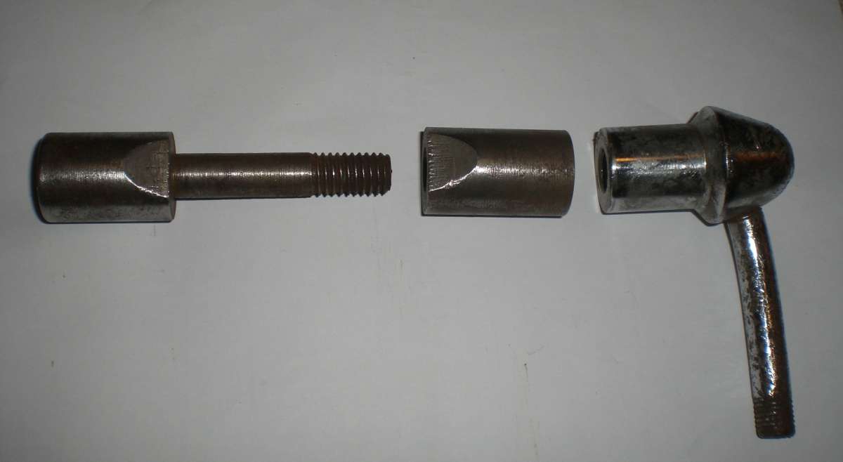

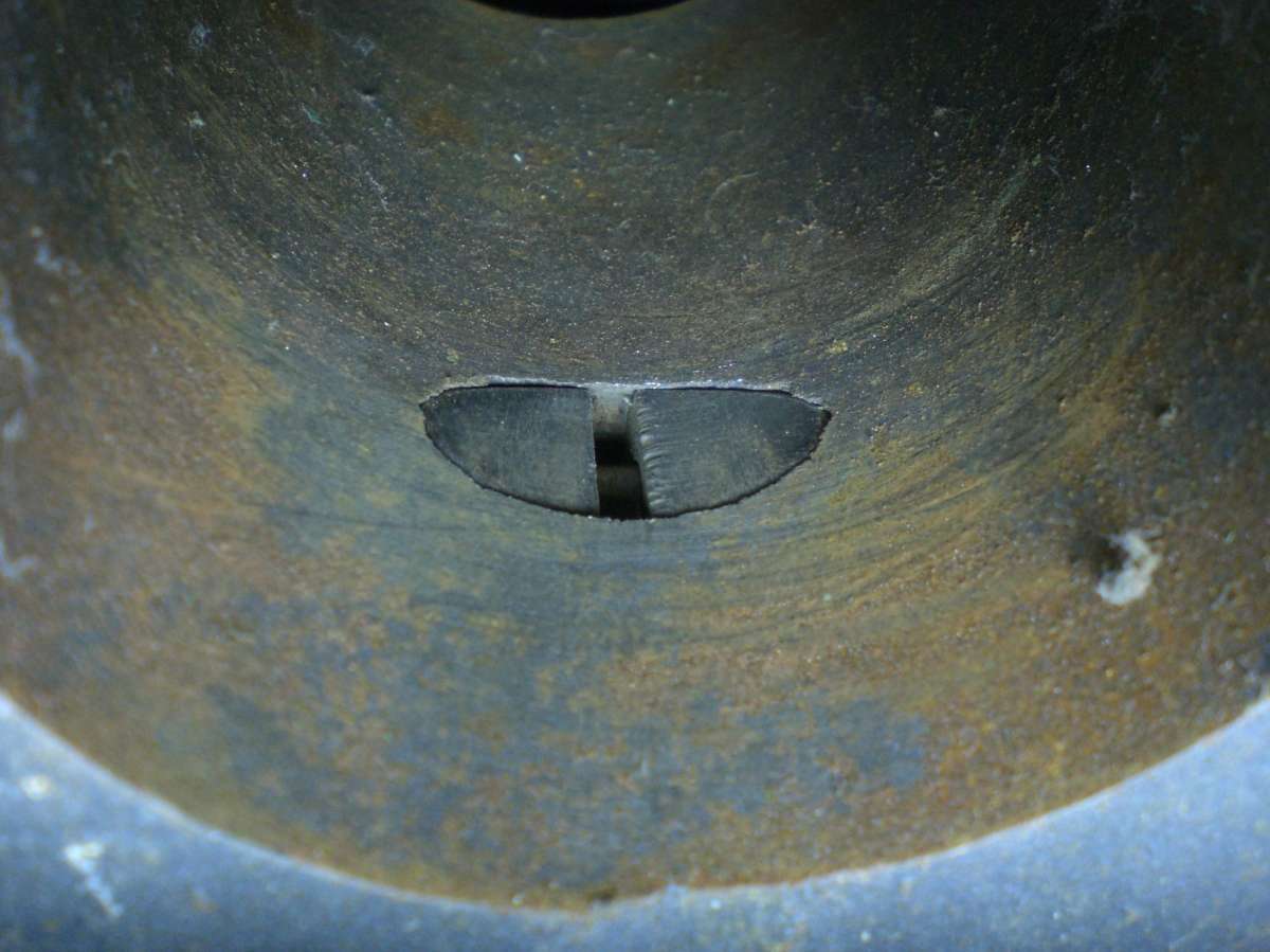

              Hi File Handle, Similar to the one that MichaelG has shown, here’s one that belongs to an old drill-head that has a three inch solid shaft, and the one in the drill table is much the same, and both parts grip the shaft.
              Drillhead Clamp
              Drillhead
              Regards Nick.
