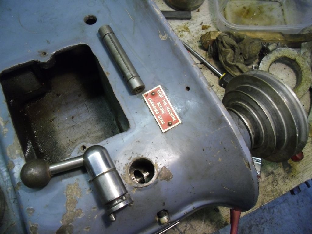

      Laying a a scrapheap, I chanced upon a Union PD4 floor standing pillar drill. Remarking that it looked too good to go to scrap I was told 'yours if you want it'. Needless to say I did not need telling twice! I dismantled it to transport home and have conducted, thus far, a very cursory inspection and checked the details on lathes.co.uk. The machine is reasonably complete, the electrics have been butchered (possibly when converted from 3-phase) and has remarkably little 'drill rash' on the table which makes me think it has not hard a hard life or the main fault I found precluded it being used much in its former life and worthy of a little restoration work. It appears to be the two-speed model, at least that is indicated on the speed information plate, and the fault seems to be that the spindle will engage with the pulley wheel only when the gear lever is in one position which makes me think there is stripped gear somewhere in the head.
      So, the question is this: does anyone have any information on this machine, other than what is on the 'lathes' site and an exploded parts diagram they could let me have? I would, of course, cover all photocopying and postage costs if the information is not in an electronic format. And, has anyone dealt with type of fault in this model of drill, if so what was their solution?

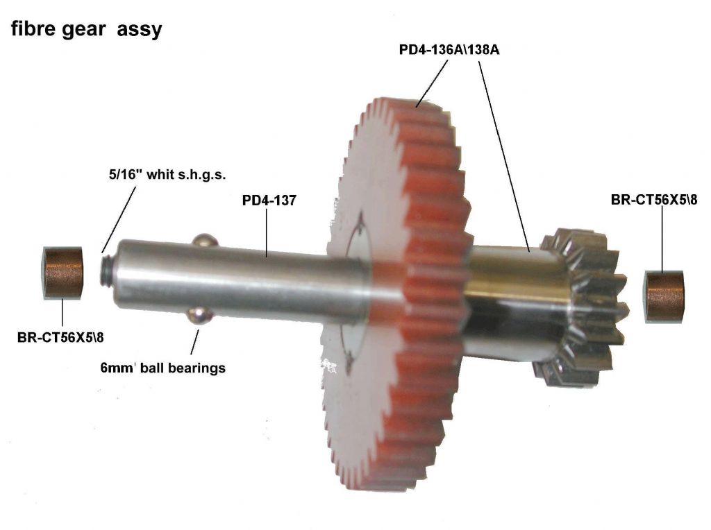

          I am guessing that if you have a gear lever for high and low ratio's, then it will be PD8 like mine.
          Are you aware that Boxford have some exploded views and spares lists on their website, there is one showing a fibre gear which could be a contender for having some stripped teeth.
          http://www.boxford-software.com/spares/menudrill.html
          http://www.boxford-software.com/spares/DrillFibreGear.html

                  Just in case Chris feels uncomfortable about it … I have grabbed the illustration of the fibre gear assembly.

                    I am very grateful for the help and advice offered, thus far. Having found the Tufnol gear spindle (Part PD4-137) lying in the cavity of the drill head I am now convinced the problem is either a stripped or missing gear or someone has had this assembly apart before and failed to put it back together properly. It seems that very little detail was ever published about these machines and probably no complete exploded parts diagram ever existed. So, before I 'poke and hope' has anyone ever stripped one of the machine's heads and did they take any photographs or make any sketches that they could give me sight of?

                      You say the spindle and gear assembly were lying loose in the head cavity. Surely that is the cause of your problem, not a stripped gear. Put it back together again and all should be well, I don't see the difficulty really, it can't be that difficult to see where it should go having found it.

                        Regrettably, I have not found the whole assembly as indicated in the diagram, merely what looks like to be the gear spindle. There is nothing obvious as to how to the remove the main spindle and dismantle any internal assembly. I have no fear as to what may lay inside, but I thought it may save some time and trouble if someone could 'prime' me as what to expect and an exploded diagram or photograph of the whole assembly would make everything obvious. It seems, as far as I can currently ascertain, that no such diagram was ever published by the manufacturer but I stand to be corrected and live in hope.

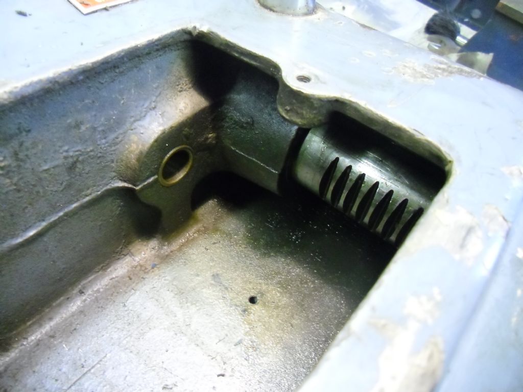

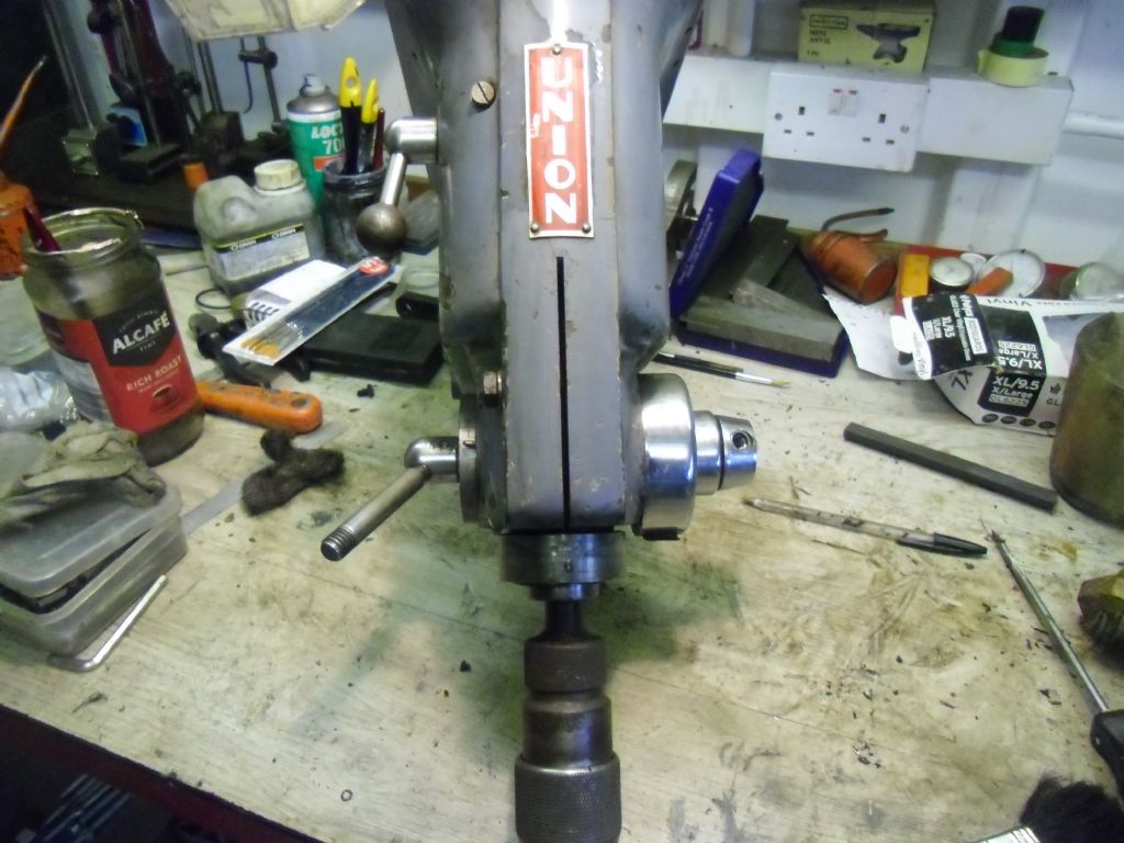

                                    I have taken some photographs of the drill-head I have titled them and put a note on them to try to explain my difficulty. At this stage I am still in complete ignorance as to how to remove the quill/spindle as there does not appear to be any other way than to withdraw it from either the top or bottom of the casting. Whether this will just slide out when I have found a way of removing the pinion shaft or whether it will need to be forced out by some means remains to be seen. I am assuming that the slot in the front of the head and the provision of what appear to be two clamping bolts is to hold assembly in position, but one is missing and the other is slack at the moment with no apparent movement of the spindle, possibly because the pinion is still engaged in the rack or the bearings are held tight in the head elsewhere. There is a bushed hole parallel to the spindle in the upper part of the casting with no apparent function, so if anyone can tell me what it is for I would appreciate the advice as I have no idea at this stage.
                                    The gear change appears to be effected by sliding an inner sleeve up or down with an eccentric a spigot on the end of the gear-change lever which seems to confirm my initial thought that the gear-change is effected by some sort of epicyclic arrangement within the spindle, but again I have no idea what is in there at this stage. The component in the same photograph as the gear-change lever was found loose in the head casting and appears to the Tufnol gear spindle shown in the Boxford diagram.
                                    I stand to be corrected, contradicted and educated on all this by anyone who can provide any guidance or suggestions as to how to go about stripping this head down for repair because, unless I am missing something obvious, there appears to be no way into the mechanism to me at the moment. Clearly, there will be a way of getting in there and all will be revealed, it's just that I don't know what it is at the moment and would appreciate some advice before I go attacking it with all guns blazing, if you know what I mean.

                                      rack into pinion housing.jpgrack & bushed hole.jpgpulley on head casting.jpghead & clamping slot.jpggear change lever & slot.jpg

                                        I don't know this model but I am pretty sure extracting the spindle/quill assembly will be very similar to what is done on other makes of drill.
                                        You need to extract the pinion shaft that racks that part up and down. There will probably be a clock spring attached to the shaft on the left hand side as you look at the machine, fitted into a housing of some kind that can be wound up and then locked to vary the degree of spring return as you crank the operating capstan on the right hand side. Often there is then nothing to prevent the innards from dropping out of the bottom of the drill housing, so be prepared for that. At the top end the spindle will have a splined section that engages with internally cut splined in the drive pulley
                                        Once you have that out you may be able to see how the speed shift gearing works. The pinch bolts, you are correct, one is missing, that close up the central split in the casting may either adjust the grip on the quill to take out any slop or act as a locking feature
                                        Refitting is a case of inserting the quill again, making sure the pulley splines engage and holding it in place with a prop of some sort so that you can refit the pinion shaft. You will need to work on the spring return to reset that to a tension that will raise the spindle again without it being too enthusiastic
                                        I hope these notes help   Brian
                                        I should have added that the short shaft with a pin in your last picture engages the pin into the slot at the bottom of the hole it is next to raise and lowered that slug to alter the gearing. Beyond that you may well find out what it does when it operated once you have an internal view  Brian

                                          It turns out that my assumption was completely incorrect. The gear change is not effected by some in-line epicyclic arrangement on the spindle. What I took to be a blanking plate on the top of the head casting was actually concealing the Tufnol gear assembly, minus its shaft which had dropped out and that which I found in the lower casting void. This shaft is clearly meant to run in the two bushes parallel to the main spindle, which is obvious to me now, and had originally been retained by two circlips judging by the grooves at each end of the shaft. The Tufnol gear and its accompanying steel gear on the same shaft act as sort of lathe back-gear arrangement. When the top speeds are in use the drive from the pulley is direct by the engagement of dogs on the split spindle with the steel gear being dis-engaged. When the lower speed is in use the gear assembly on the on the main spindle is moved down, disengaging the dogs and engaging a larger gear mounted on the gear-change sleeve with the smaller steel gear on the Tufnol gear shaft, which I should now really call a layshaft. The driving key for this larger gear was displaced and gear was just running free around its spigot. So there were actually two faults with the mechanism both of which are now just simple repair jobs.
                                          Which fault caused the drive failure first is hard to say, the layshaft bushes in the casting appear to be quite worn so will need replacing, although the gears rotate freely on the layshaft which could actually stay stationary. I don't know what the original intention would have been. The large gear is running a little too free on its spigot so I will have to possibly bore it out a little and fit a bush so it doesn't rattle its key out again. But in any event I will have a machine which will well outlast me, I think. I will take some more photographs of the arrangement in case someone else encounters the same, or a similar fault, with this type of machine.

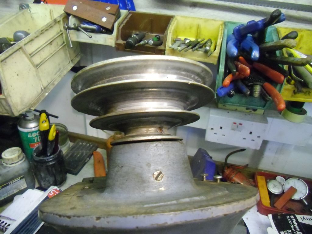

                                              Well, I have got the drill re-assembled for a test run but then I noticed a discrepancy. The machine, as recovered from the scrapheap has 3-step pulleys on both the motor and drill head, not the 4-step as indicated on the speed plate. I guess that makes it either a PD3 or PD6? So, may I ask if anyone has the PD8 model could they kindly measure the diameters of the pulleys on both the motor and drill head end and let me know so that I can try and source the correct pulleys from somewhere and if anyone can tell me where these pulleys may be available (I don't expect them to be OEM parts), so much the better.

                                                    I have taken some pulley measurements from my PD8 for you. It is very difficult to get good access to measure them due the position of the drill in my workshop, but these are the best I could get.
                                                    62mm – 90mm – 115mm – 130mm
                                                    I notice on your spindle photo that the largest pulley is uppermost, on mine the smallest is at the top with the largest nearest the main body casting.
                                                    Hope this is of some use to you.

                                                      Thank you for taking the trouble to measure the pulleys on your drill. I will try to source some suitable replacements for mine although I think the sizes will have to be approximate as OEM items will not be available.
                                                      It was my error in placing the pulley the wrong way up on the spindle. I had just hastily put it back on to take the photograph and had not quite figured out at the time how everything fitted together properly. Obviously, I know now that the belt guard casing will not fit over this inverted pulley.
                                                      Clearly, the drill will be usable with the 3-step pulleys until they are replaced. It rattles slightly in back-gear, but there again so does my lathe, so I think this is normal for straight cut gears. I have fitted a new key-less chuck and given everything a good cleaning and lubrication so I think this machine will now serve as the 'proper' drill I promised myself 40 years ago when I had to buy some 'cheap Chinese rubbish' because that was all I could afford at the time. Actually, it's a Taiwanese branded Nu-Tool bench model that has given 40 of good service, still works perfectly well and cost me £150 in 1983, second-hand from a local tool dealer. Amazingly, they still cost about the same 40 years later but are branded differently.
