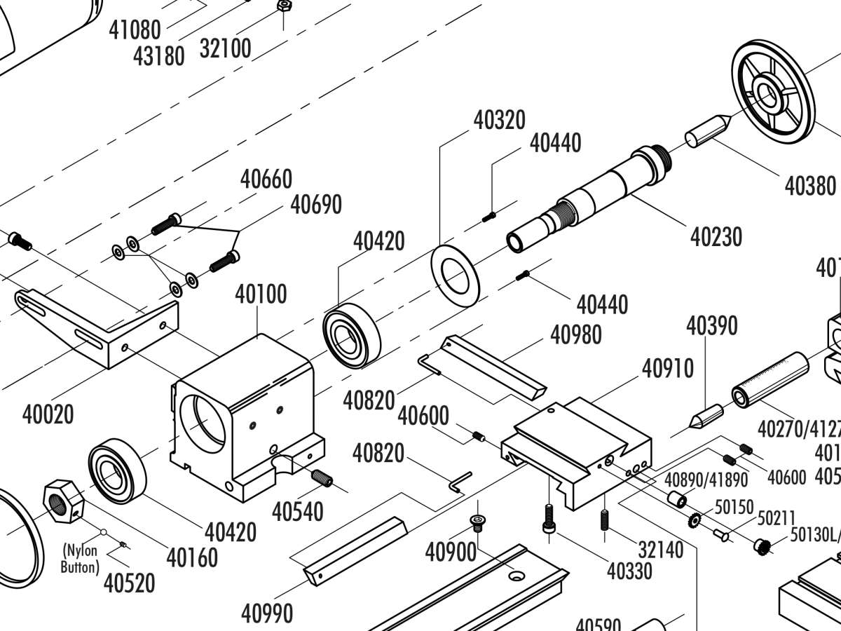

      And what stops the spindle moving towards the tailstock if you are plain turning with a left hand tool.
      #733028
      david bennett 8
        @davidbennett8
        These are all the things on which sherline would have made the decision of the amount of preload. Experience and trial and error, I suppose.
        dave8
        #733029
        david bennett 8
          @davidbennett8
          Duncan, the spindle nose stops it.

              Somewhat surprised by your earlier reaction, I have just re-read our earlier exchange. Yes, I got it wrong. I can only plead brain fart and apologise. If ,however, you are giving me a series of tests, then stop it now.
              ( I beleive the interference fits between spindle and bearings are all that hold it together)

              #733050
                Posted for information only:
                IMG_9688
                Refhttp://sherline.com/wp-content/uploads/2015/01/5326_instructions_v8_web2021.pdf
                #733052
                  See also:
                  https://www.sherline.com/wp-content/uploads/2016/03/4000plan.jpg
                  for an export from a nice AutoCAD drawing by John Costello.
                  #733055
                    David, if after the photos I posted of the head and it’s shoulders and the parts diagrams Michael has posted you believe it is all held together by interference fits then I suggest you are still farting.
                    Worth doing some more research on how spindles are put together and adjusted be they deep groove, angular contact or taper roller. The different interference fits are there so there is no play between bearing outers and the head or bearing inners and the spindle, you need something to retain them against cutting loads over time (as per Duncan’s comment) if there were no shoulder , no flange on the spindle and no nut then the whole assembly could creep over time particularly with a heavy intermittent cut.

                        I told you I am not happy defending the sherline. As I’ve said, I haven’t even seen one. What you describe as a bearing washer, I thought was a dust cover. Now I have learned something. So why were you asking me?
