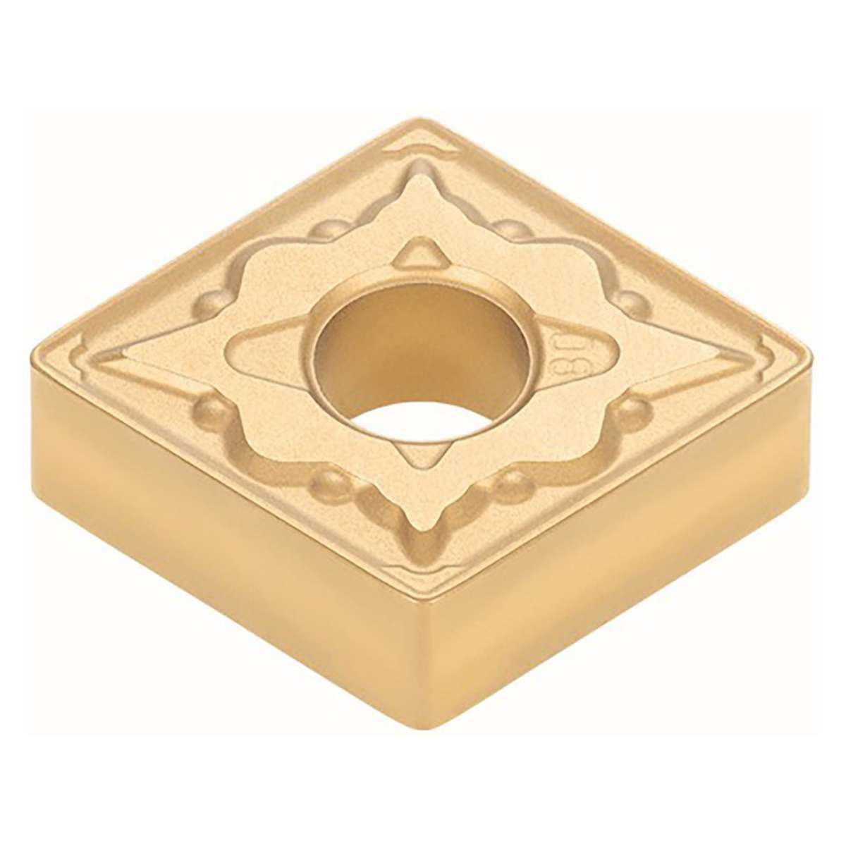

                          I think you are confused with the Cutting Edge Radius and the Nose radius of an insert.
                          Insert profile
                          The above insert shows quite clearly a radius running the full perimeter of the insert, on the cutting edge, it even goes around the Nose Radius. This is always present to a lesser or greater degree on all moulded inserts. The only time it is not there is when the insert has been finished ground.
                          Your insert might have been new, but it will have lost this edge as soon as it made initial contact with the Hardened material.
