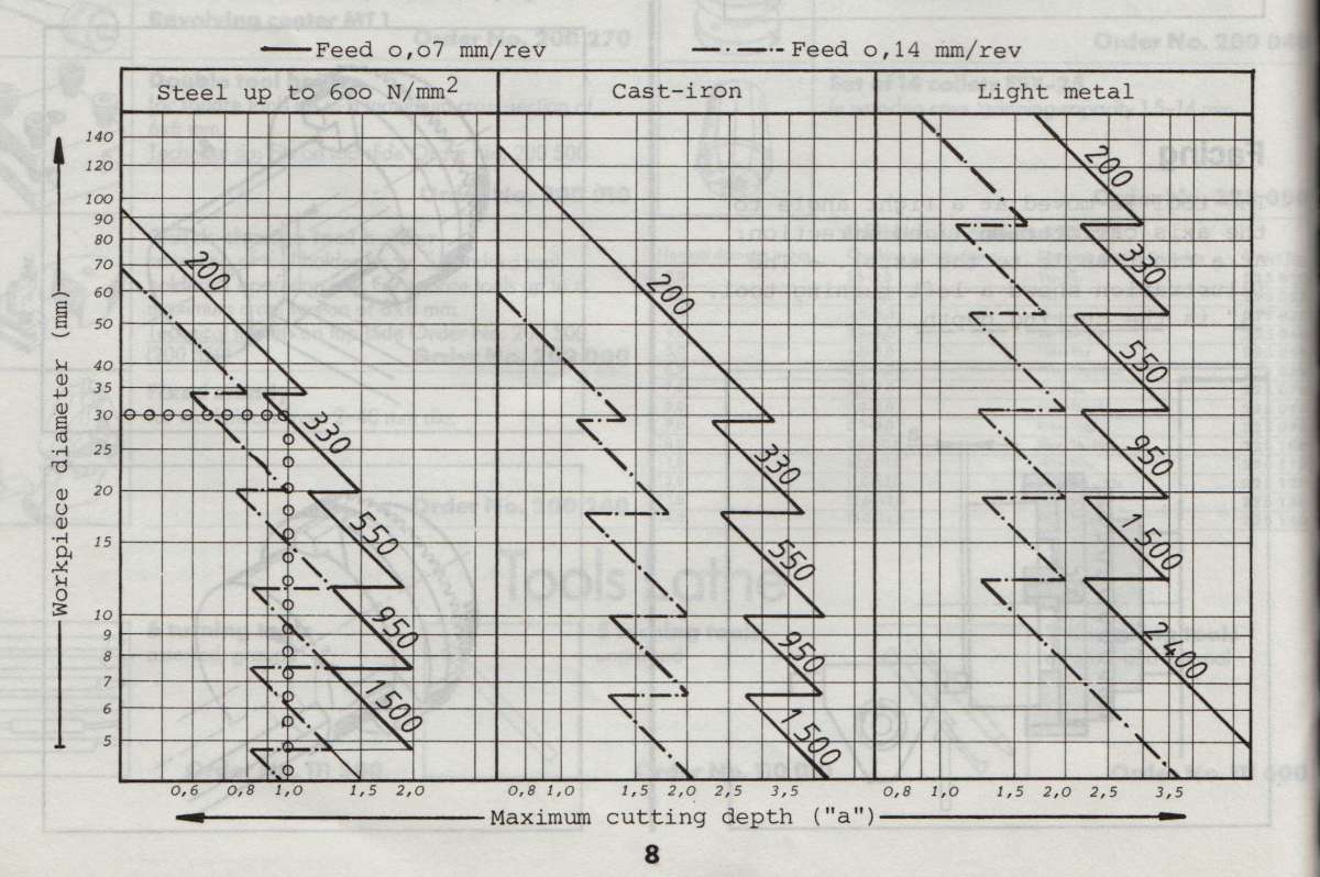

                      For those who like to do comparisons, here is the Compact 5 Chart taken from the C5 Handbook.
                      COMPACT 5 SPEEDS, FEEDS & DEPTH OF CUT
                      Regards
                      Gray,
