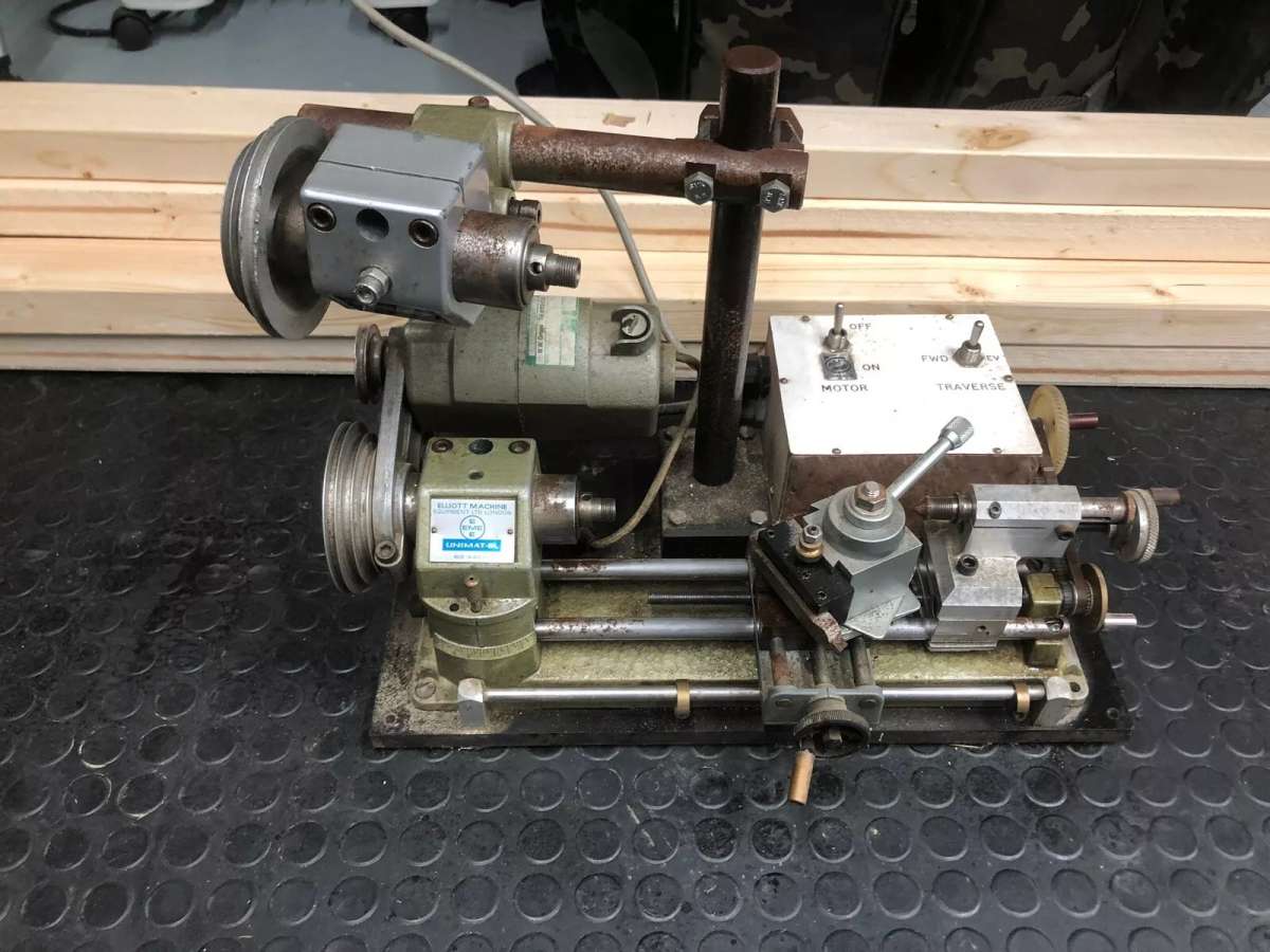

                                I’ve been wondering about Robert’s machine.  Whilst a production Unimat SL is already versatile, this one’s been customised, for example by bolting the gantry in a fixed position rather than moving the headstock, plus a control box providing belt drive to the lead-screw for powered traverse:
                                My guess is some sort of small-scale production work.   The build quality looks middling but well thought-out.  Could be a competent  amateur upgrade or a jobbing engineer paid to meet a commercial requirement by modifying a small lathe without wasting time on spit and polish.    The control box looks rough but is properly sealed and labelled.    Evidence against production is it still has the original easily overheated motor, which isn’t designed for continuous work.    Maybe instrument making or tweaking O-gauge model railway parts, perhaps for sale.   Shame the history is lost, someone in the past was up to something a bit different, maybe!
                                The changes don’t detract from the original lathe – powered traverse is good to have.

                                Emgee
                                  @emgee
                                  The traversing control looks very much the same as I fitted to an SL many years ago, the engraved panel was done on my TH engraver.
                                  When I sold the SL there was no adjustable traverse stop bar fitted neither were there risers fitted to the head and tailstock.
                                  Presently there is no intermediate drive pulley arrangement fitted and the motor drive pulley is fitted in reverse to allow correct speed changing of the spindle.
                                  Emgee

                                    That socking-great-big tool-post would seem to support Dave’s hypothesis.

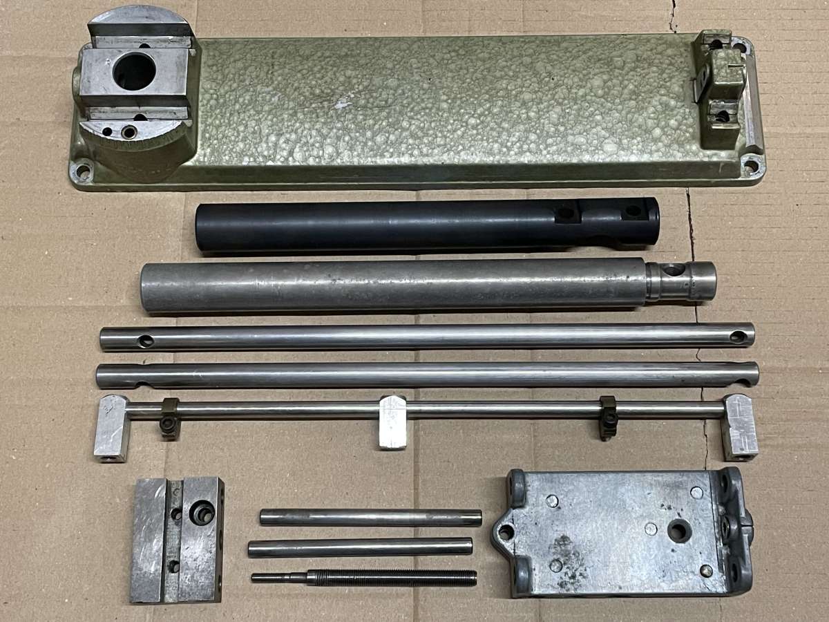

                                      Making progress – the bed parts are about ready to go back together.
                                      The biggest sticking point was getting a replacement M6 countersunk screw to re-attach the block on the limit rod, through the saddle; the original was epoxied in and and barely survived being removed. It’s below the X leadscrew so has to go in before the saddle is assembled.
                                      I had every type except countersunk in M6..
                                      The vertical add-on column looks to be an original part, for the configuration with the column in the headstock clamp and the headstock mounted on that via an adapter.
                                      The second one (cross arm) in the original photo looks to be a home-made addon, but quite nicely done. The tailstock is non-standard as well, but again quite neat.
                                      I cleaned most of the steel parts with a DIY rust remover (EDTA plus a trace of citric acid in deionised water), that a science channel on youtube came up with. The etched looking areas on parts are where the rust was dissolved away, whilst the non-rusty areas are unaffected.
                                      The paint on the bed is surprisingly good, so I’m not messing with that.

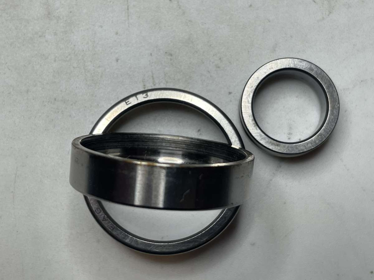

                                      I’ve also pulled the old headstock bearings; they are German FAG brand E13, so possibly the originals from new? There is a bit of visible wear, but not terrible. The part that surprised me was the very rough looking half of the outer race, where it looks like one side of the race inner has been roughly machined away! Nothing should contact that area, so I can’t see how it’s anything but the bearing makers work?

                                        Oops – just noticed that it was the vertical column that was blued originally! That will get done again.

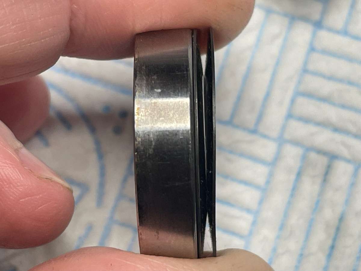

                                            On rjenkinsgb Said:
                                            … The part that surprised me was the very rough looking half of the outer race, where it looks like one side of the race inner has been roughly machined away! Nothing should contact that area, so I can’t see how it’s anything but the bearing makers work?
                                            Strange – looks like wear, but only if something is there to account for it.
                                            Possibly the bearing shell started as a rough boring that was ground to size later, and that part of the bore wasn’t important, and left unground.  Production engineers tend not to machine anything unless it’s necessary, so well-made parts are found where some of the finish is terrible, but only when it doesn’t matter!

                                            Clock polisher
                                              @clockpolisher
                                              Good afternoon Geraint,
                                              Difficult to put into words but here goes,
                                              The cupped washers go back in, between the rear bearing and casting, with the bores touching so that the concave outer sections arc away from each other.
                                              That way they can be squashed together by the bearing outer race to produce the required force to control bearing end-float.

                                                rjenkinsgb
                                                  @rjenkinsgb

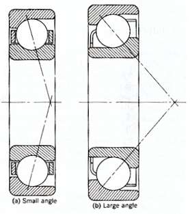

                                                  Hi Dave,
                                                  I’m used to the high angle bearings used in large machine tools. These little ones are low angle, with a symmetrical inner race. I wonder if they just machine one side of a conventional bearing out before finish grinding them, rather than make fully custom races for probably what is a relatively small demand part??
                                                  Angular-contact-ball-bearing
                                                  Geraint, just getting ready to assemble the spindle on mine.
                                                  This is the arrangement; the outer edges of the bellevilles apply pressure between the outer back race and the lip inside the spindle hosing bore. (ps. That’s an old race which is why it looks rough, I just used it to drift the new front outer race in to place).
