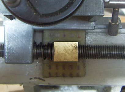

                              At the moment I am in the process of turning a new lead screw nut for the U3's cross slide from a 25mm piece of 100mm long SAE68 (?) bronze stock. Rather sloppy in its manufacture (uneven surface+a bubble taking up about 7.0mm of the total length) but an unbeatable price.
                              Adjusting the lift plates has made quite a difference. If I can manage to get this part done and working properly, another problem will have been solved.
                              Next in line are carrier lead screw wear which I seem to have (partly/temporarily) solved with the contraption below and headstock / tailstock alignment which I think is a can with a great many worms in it.

                                      We have just made a brass gib for the longer cross slide on the Atlas 12 x 24 lathe, it was the best size laying about and quite good. The original looks like cast iron, and if I had a choice some bronze woulf have been used. The aluminium might wear faster, but if it is available and can be adjusted easily, I see no reason not to use it. Keep the bed clean and oiled and all should be well.

                                              Posted by Kiwi Bloke on 11/06/2023 02:08:13:
                                              … the mating surfaces of the underside of the saddle held the 'lift strips' a tiny bit away …
                                              I think that the original topic ie: question about lift plate material has been answered and it would be a good idea to split this post to another, related and equally important topic.
                                              I went to my usual purveyor of plastics and non-ferrous materials today and got a very good deal on a few left over bits and pieces, one of which was a length of 5/8" x 5/32" brass, more than enough to make myself a new pair of lift plates to replace the ca. 1980 Emco issued ones.
                                              Then I started on Kiwi Bloke's suggestion which I think merits its own thread.

                                                Fitting of the strips seems related to the choice of material. Bit of brass should work for you. I vaguely remember on one "microlathe" I fixed up for a bloke a few years ago it did perform better when we set up the lift plate strips (steel from memory) so they were a neat sliding fit on the underside of the way where they run. Blued them up to just contact and that is all. Had to rub a few high spots down on the ways with a fine flat file and rubbing stone. In theory the lift plate should not affect cutting but in practice it did seem to help on these rigidity-challenged tiddlers.
                                                Edited By Hopper on 15/06/2023 08:40:53

                                                      Having read more than one post on various forums where it was stated that the change to brass strips made a noticeable difference, I look forward to being able to say the same thing.
