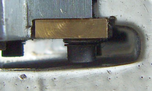

                      #653405
                      Julius Henry Marx
                        @juliushenrymarx92355
                        Hello:
                        Posted by Julius Henry Marx on 21/06/2023 16:51:00:
                        … see if this arrangement can be improved …
                        An update:
                        After a fortnight or so I had to dismantle the carrier again to take some measurements and had a look at the new brass gibs. I then realised that they needed a tad more removal from the surface they are bolted on to, so went about doing that.
                        It was not a case of line wearing as the width of the markings on the brass were quite consistent with the markings I had measured on the OEM lift strips but as the use of the set screws was needed, I decided to go ahead and see what I could do.
                        It was a very small amount and the result was quite satisfactory, to the extent on not needing any adjustment from the Sieg C0 type set screws I had added.
                        But then I found out that the whole arrangement had become more difficult tighten, I guess due to the smaller dimensions at play and the 0.7 pitch of the mounting screws.
                        The solution (again) was to follow Kiwi Bloke's advise and use Bellville washers, so I added a pair arranged in series (on top of the OEM washer) to each screw.
                        The carrier now moves very smoothly and, as expected, gets tighter as it reaches each end of the bed.
                        I expect that, as the gibs wear the carrier will loosen up and then it will become necessary to use the set screws to adjust the gibs accordingly but I think it will take many hour's use of the U3 for that to happen.
                        Here's a photo of the gib below the flat as seen from the tailstock end, with the Bellville washers clearly visible:
                        It looks like it is as Kiwi Bloke said: She'll be right.
                        That's about it for now.
                        Best,
                        JHM
                        Edited By Julius Henry Marx on 23/07/2023 16:37:43
                        #653502
                        Graham Meek
                          @grahammeek88282
                          Posted by Julius Henry Marx on 23/07/2023 16:34:28:
                          The reason why the Carriage gets tighter as it moves towards the end of the Bed is due to the geometry of the machine.
                          The Leadscrew centre-line is fixed in relationship to the Profile of the Slideways on the actual Bed.
                          Excessive wear on the Carriage Slideway Profile, now means the Leadscrew tapped hole will be sitting lower than was originally intended. This is not so bad when the Carriage is nearer the Headstock as there is some play in the system. As the Carriage nears the fixed Leadscrew bearing this will cause binding due to the misalignment of the two items. Any attempt to reduce backlash in the system will only exacerbate the binding.
                          This was, apart from wear in the original thread, one of the reasons I did the above salvage scheme on my Unimat restoration. As wear in the current Carriage set-up takes place a new Phos Bronze Leadscrew Nut can be made with a slightly offset tapped hole to cater for this misalignment.
                          The fitting of the new Nut brought the backlash back to 0.05 mm which is what I would expect. Although this is the original leadscrew of unknown age, there is no change in the above figure through-out the length of travel.
                          Regards
                          Gray,
                          #653877
                          Julius Henry Marx
                            Hello:
                            Sory for the delay in my reply.
                            Posted by Graham Meek on 24/07/2023 10:58:24:
                            … gets tighter as it moves towards the end of the Bed is due to the geometry of the machine. | … centre-line is fixed in relationship to the Profile of the Slideways …
                            I see.
                            … wear on the Carriage … | … means the Leadscrew tapped hole will be sitting lower … | … not so bad when the Carriage is nearer the Headstock as there is some play …
                            Yes, I have noticed that there is some play at the left end of the leadscrew.
                            … nears the fixed Leadscrew bearing … | … binding due to the misalignment …
                            Makes sense. But when I was testing/adjusting the new gibs with the Bellville washers without the leadscrew in place, I observed that the was some tightness at each end of the run.
                            … one of the reasons I did the above salvage scheme on my Unimat … | … wear in the current Carriage set-up takes place a new Phos Bronze Leadscrew Nut can be made with a slightly offset tapped hole to cater for this misalignment.
                            Yes. The Sieg C0 has a leadcrew nut that is adjustable in height, apparently to deal with that problem.
                            … new Nut brought the backlash back to 0.05 mm which is what I would expect.
                            Good job that one. I'm still attempting to figure out how to get that done on mine.
                            Thanks for your input.
                            Best,
                            JHM
