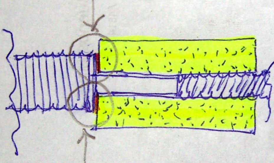

      Hello:
      Posted by Kiwi Bloke on 28/06/2023 12:22:43:
      May have misunderstood, but the 'proper' thrust bearing should be on the left side …
      Indeed, I misunderstood / misread by me.  8^°
      The OEM arrangement for that function (thrust bearing) uses part of the surface of the leadscrew end against the left side of the steel bushing: (sorry for the untidy sketch)
      ie: steel against steel.
      … may be other possibilities for getting some new bits that can be modified …
      Indeed … Food for thought.
      I will have to change the design for the part to be screwed on to the right end of the new leadscrew I ordered and also new bushing. I have a whole 60 days to think about it.
      Posted by JasonB on 28/06/2023 13:13:59:
      … the thrust is coming from the other direction so you really want the cutting forces to push against the thrust bearing so it needs to be on the left of the bearing.
      Right, now I get it.
      Otherwise all it is doing is giving a bit of preload.
      Yes, that and a smooth turning surface for the handwheel to land on.
      Thank you both for your input, much appreciated.
      Best,
      JHM
      Edited By Julius Henry Marx on 28/06/2023 19:09:40

        Also consider that if you take the bearing out to 6mm you will have even less surface where the side of the bearing and step on the 8mm screw run together so less area to take load = more likely to wear

          Hello:
          Posted by JasonB on 28/06/2023 19:30:42:
          … if you take the bearing out to 6mm you will have even less surface …
          Quite so, even less. Making a bad design worse.
          Which is why I will have to think about a different, probably more complex design for the feedscrew / new bushing arrangement.
          Thank you for your input.

          Kiwi Bloke
            @kiwibloke62605
            I think there's a risk of over-thinking this, and inventing new ways to polish a t*rd. Given the limitations of the rest of the machine, I'd suggest that the addition of a thrust washer either side of the bush is probably enough. Incidentally, I'd think the bush is cast iron or bronze (can't remember), not steel.
            However, if you want to go all fancy, ball thrust bearings are available in 5mm ID, 11mm OD, 4 or 4.5mm axial thickness. IIRC, the bush is 12mm OD, so the bearing assembly can still be loaded into the machine from the right side. You'd need to shorten the leadscrew thread, and extend the end of the leadscrew, but you're committed to most of that already. You's also need a simple shield around each thrust bearing. I'd guess this would be the trickiest bit, but a stepped-bore tubular shield could be pressed or Loctited onto the non-moving part of each thrust washer.
            Oh, forgot, Oriental bits ordered. No doubt the same approach would be possible…

            Dave S
              @daves59043
              On my Unimat the simple addition of some molyslip grease to the end of the leadscrew once in a while, combined with careful adjustment of the hand wheel/acorn locknut gives totally acceptable results. The forces on the leadscrew are not large, and a roller thrust bearing is overkill.
              That the LH end (headstock end) is “floating” makes square root of a gnats fart difference, all the thrust and guiding accuracy is between the bed end (tailstock end) and the saddle nut.
              Over constraining the leadscrew by adding tight fitting bearing blocks to both ends is imo a bad engineering decision.

              Graham Meek
                @grahammeek88282
                Hi Jason,
                A good move with the counterbore.
                Regards
                Gray,
                The standard design has lasted 40+ years without modification. It is clear there are some issues with "backlash" and normal wear. Inserting a thrust race at this point is an overkill given the cutting forces involved. Two 11 mm O/D 5mm I/D Ball races in a new Bearing Housing would be more than enough to cope with the forces involved. Provided they were not over tightened in the quest for zero back-lash.
                There is a down side to such modifications. The leadscrew or feedscrew experiences a certain amount of drag from the original set up. Remove that drag and the feedscrew or leadscrew could move during the cutting operation due to vibrations.
                Another thing to watch out for when purchasing non-original parts are the "Limits and Fits" in operation in the country of origin. The "New" replacement leadscrew could well be smaller than the original Emco one. It could also be larger which may mean it will not screw into the existing hole and there-in is another problem.
                The M8 x 1 LH taps used by Emco might well be H6 tolerance, the far eastern manufacturer might use a H7 tap. In both cases the feedscrew would be rolled to match the tapped hole to maintain the correct "Fit". Or visa versa.

                                      Hello:
                                      Posted by Graham Meek on 01/07/2023 11:52:18:
                                      As regards the short comings of this machine I don't see any.
                                      Given your knowledge and experience in these matters, I cannot but accept your point of view as the most valid one.
                                      … will take this resume of Engineering Design in the spirit of learning something new …
                                      Of course, there is no other way. 8^)
                                      Thank you very much for taking the time to write it up, much appreciated.
                                      Best,
                                      JHM
