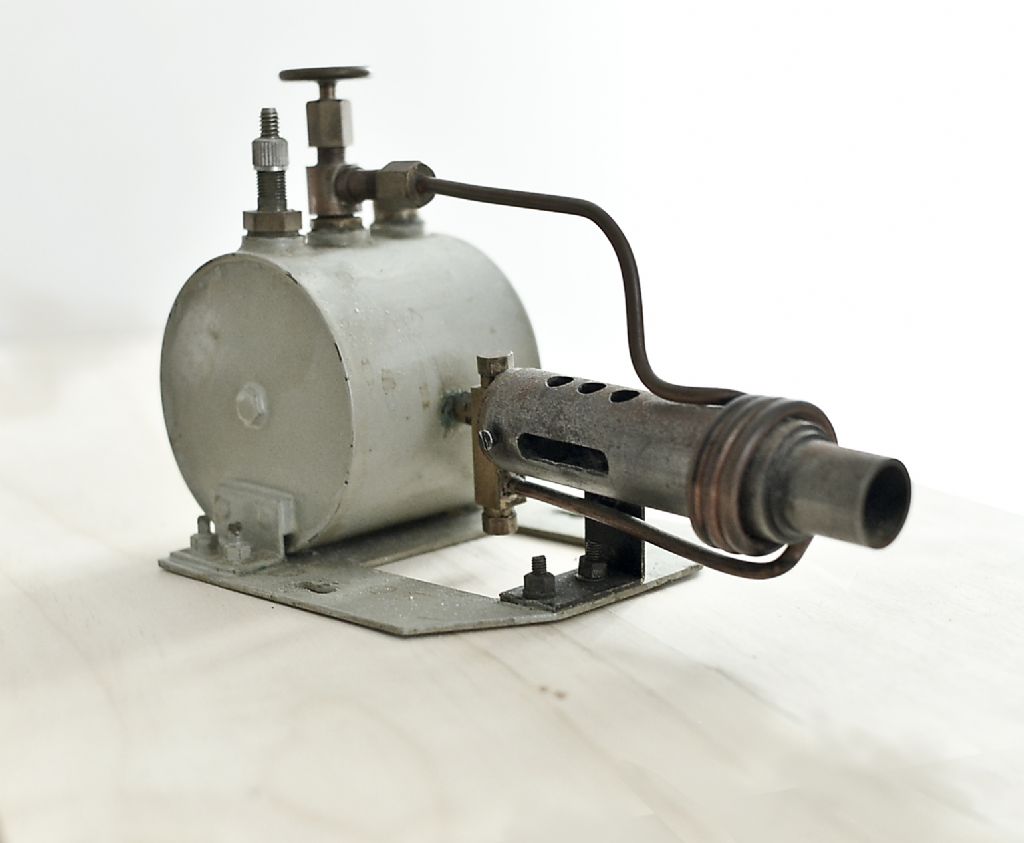

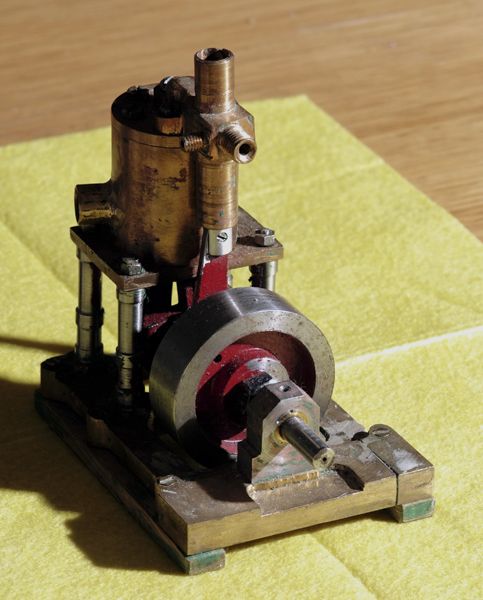

            This is a small uniflow designed for model boats, got it from an Ebay seller.
            It's not in the best of condition.
            Leslie

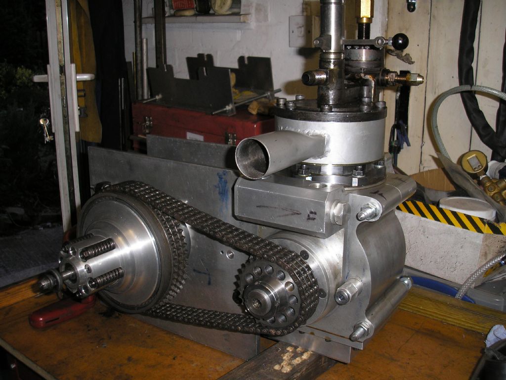

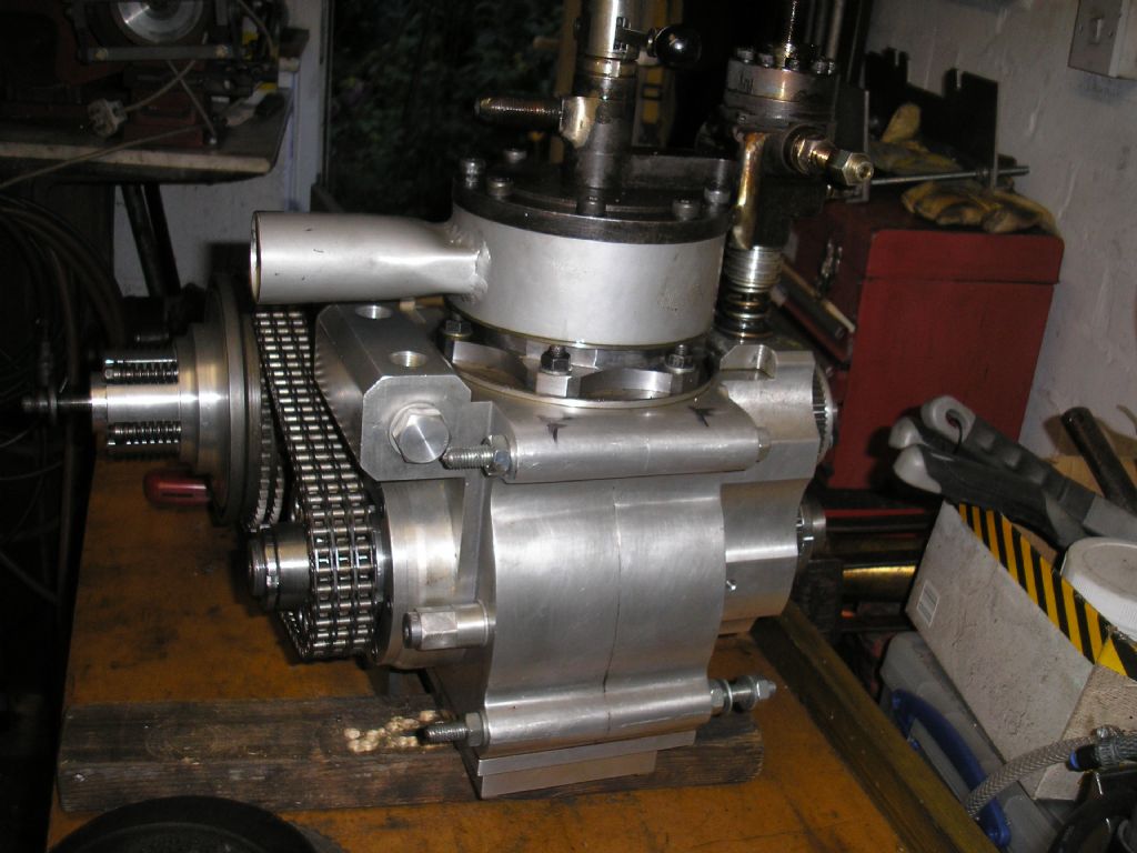

                    A couple of pictures of my latest steamer.

                      Thanks for Posting a couple of your Photos Windy. I can get a ruff idea of whats going on, but not fully. And I'm also guessing that this is out of a boat for Flash Steam? A lot of these engines favoured Poppet Valves, and don't get me wrong they're also my preferred valve as well, that is for engines operating from boilers, but for Flash Steam where I have heard of astronomical pressures (greater than 1000 psi) the strain on the valve system would be enormous. And anybody who can make a double beat Poppet valve that small, should get a Trophy. But that's all about Flash Steam and those things are powered by very large Petrol Blowlamps.
                      But to get back to my storey I was simply in the throws of designing a Uniflow Engine which would work from a Boiler, maximum pressure of about 60psi or even less. And with these engines the exhaust is nothing more than a set of blow holes at the end of the stroke. So far all is well. And so far all normal. Now without a condenser, the trapped steam with no where to go, could be compressed on the exhaust stroke, to up 60psi or more, robbing the crankshaft of some energy.
                      So what I designed was a small valve in the piston which would only open on the up stroke, but now I will need to make a model to prove it. Andrew in the mean time had sent me a link to another guy who had also designed a spring lowed valve, designed to open on the exhaust stroke with access to the outside air, and of course it used a crash valve for the admission.

                        Those pictures are for a proposed full size wheeled speed attempt vehicle engine is similar but bigger than the model hydroplane one.
                        I had a go at making a balanced poppet valve but was no good at high rpm.
                        As far as stress at high pressure on the poppet valve the opening pressure was high and cam followers took a beating but eventually sorted that problem with stellite and solid lubricants.
                        On the rapid closing of the valve only good quality car exhaust valves were used with a solid head otherwise welded valve heads dropped off.
                        The amount of preparation with the hydro before going to run it on water was astronomical and a complete strip down after every meeting.
                        A welcome break this weekend at Melbourne raceway will be watching two jet engine dragsters having a go one my friend helped rebuild Firestorm after crashing at 200mph..

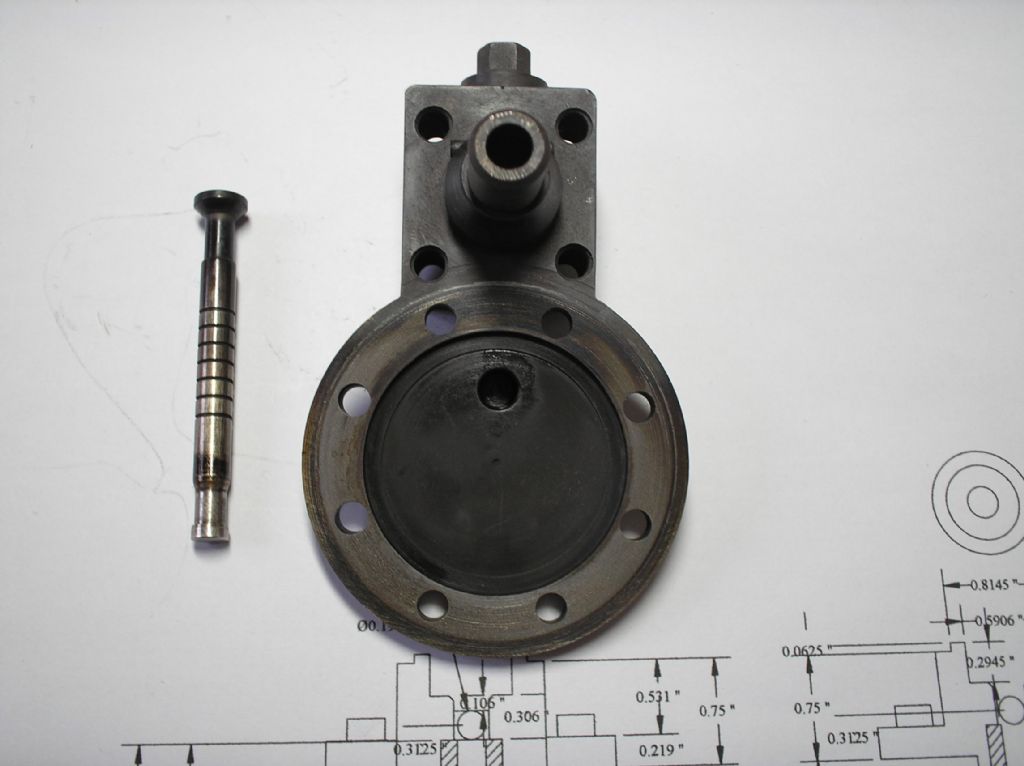

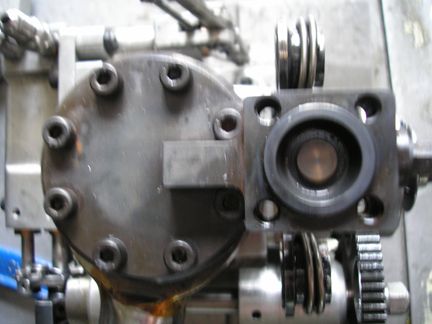

                              Here are pictures of my valve and cam follower.
                              At running temperatures the valve expands 0.012" if clearance not set at 0.013" to 0.014" this is what happens.
                              I made hairpin valve springs as coil ones annealed when at high speeds.

                                That's very very nice Windy. I was looking at all the bolts that you have to lock down the cylinder head.
                                Also looking at your scored camshaft. Tell what kind of temperatures do you think we are looking at here? And do you know, or can you guess what the steam pressure is? I like the little valve too. It's really nicely made.
                                  I been trying to upload a Photo, but I can't find out how to do it. I have a picture of a Petrol Blowlamp which is probably similar to the ones used with the Flash Steam plants.
                                  Have you put your photos in your albums that works for me then transfer them to your posts.
                                  The cylinder head is ground with valve grinding paste to barrels like some full size single cylinder engines are done.
                                  Cam follower has a stellite facing the bluing on the cam was caused by valve clearance being lost normally just bright steel when clearance ok.
                                  It all runs in Rocal Moly paste with no problems.
                                  The valve is a turned down Rover K series exhaust valve with an 8mmØ head.
