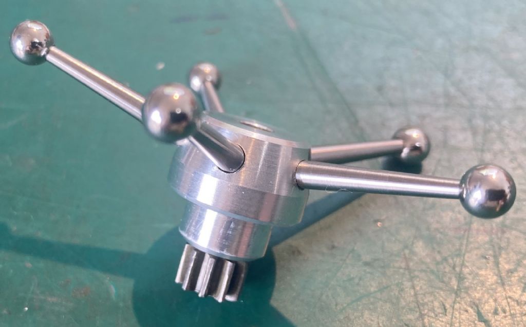

      I wanted some small steel balls for a capstan handle for a sensitve drill I'm "refreshing".

      So I looked on eBay and found a cheap and varied source – body piercing jewellery!
      The internally threaded balls are surgical steel (allegedly) and are available from 2mm to 6mm diameter with a M1.2 or M1.5 thread. They also come in black and gold colours. The black ones might be good for scale models of full size machines. No doubt other colours are available – I didn't want to delve too deep.

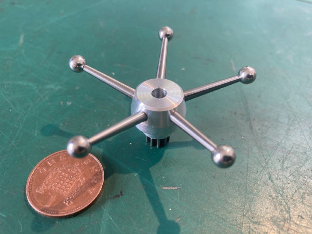

      I used 5mm for this but I've got some 6mm on order for some small locking levers.
      And the cost? £3.31 including p&p for a pack of 10.

              They are just the job, Steve!
