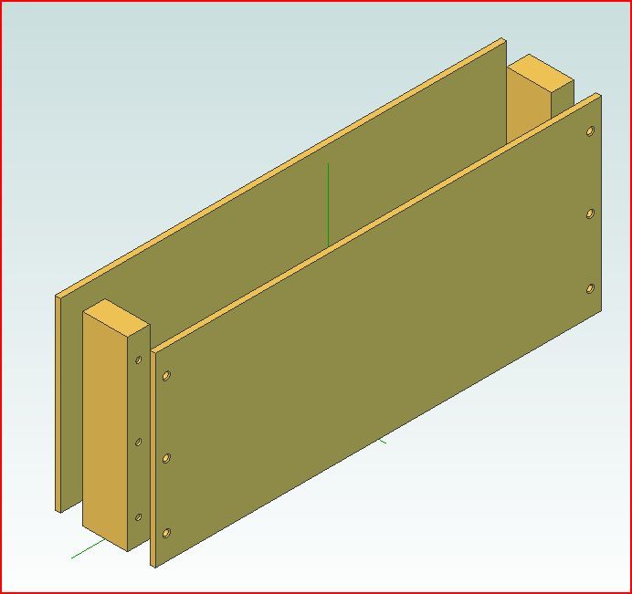

        Is it possible to get brass unequal box section approx. 120mm x 15mm x 16g? I have had a metaphorical look around on google but nothing of this size shows up. It is intended as side tanks on a small scale loco.
        Mick
        #219408
          Is that a typo ? should it be 12mm x 15mm
          Either way I think its a make yourself, if 120x 15 bend up two angles and solder together to make a box, if 12×15 cut down square tube into two L shapes and resolder

              Yes, rectangular section 120 x 15mm. I had thought about bending stuff up as you mention Jason but I am not too keen on soft solder on a live steam loco although a higher MP solder might do the job. I have ruled out silver soldering because of the inevitable distortion. Any more thoughts would be welcome.

                        Jason, the scale of the loco is 10mm to 1 foot (Gauge 1). Oddly the paint (good stuff) will still be there when the solder is flowing freely……that is using standard soft solder.(Bitter experience). I do have some 400 degree stuff which should do the job though. A few rivets will probably assist. The boiler temperature is not the problem…..it is when flames go where they shouldn't or accidental fuel spillage occurs that causes the problem. In a perfect world these things would not occur but not in my world!
                        A perfectly good alternative and perhaps more realistic size would be 50mm x 15mm …..laid on edge…..but I still cannot locate any. I am now thinking of taking a length of brass channel ….say 15mm x 5mm……then after filing in some "V" sections where the corners are to be, bending it up to form the rectangular shape carcase, perhaps silver soldering the two meeting edges. Then rivetting and soft soldering on the side sheets. I am not very good at that sort of work though, hence taking the lazy route and thinking about using box section.

                            What about some 6×12 to form the sides and possibly bottom, 1.5 (16swg) for the sides then drill and CSK for 10BA brass scews. Either tin with softsolder and then sweat together once assembled or use some JBWeld.

                                    How were you intending to fit a top and bottom to this box section tank?

                                        Jason….your plan is simple and neat and a lot easier than my idea of channel. As to fixing top and bottom I had originally thought of HMP soft solder/ screws/rivets . I am still putting ideas together because I am scratchbuilding the superstructure onto a rolling chassis that I have almost finished. I have no plans for the superstructure, just photographs and approximate dimensions. I am not even sure at this stage whether it is worth designing the tanks to hold water as their capacity would be limited and a simpler direct boiler refill system as used by the 16mm fraternity may be a better option. I am being persuaded of the gentlemen of the forum of the virtues of soft soldering but I have to confess to a mishap with a spirit fired tank engine when, after a brief overflow of fuel the cab unsoldered and fell apart ……..but to be fair the side tanks did not!
