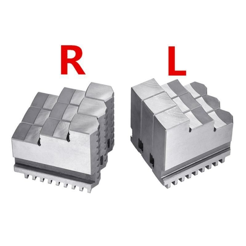

                              Possibly refers to the outside jaws having the long end of the stepped jaws machined to a V whereas the inside jaws have the short end of the stepped jaw machined to a V. Hence Long V and Short V jaws refers to the length of the V.
                              Ignore the letters R and L in the pic, just some random pic off the net and not relevant. But Long V on the left, Short V on the right.
                              #602092
                              DC31k
                                @dc31k
                                Posted by Hopper on 17/06/2022 08:04:34:
                                That is good. It bypasses the confusion involved in calling them internal and external or outside and inside jaws. 'Long' and 'short' translate into probably every language in an intuitive way.
                                In the ones labelled 'R', the inside of the jaw grips the outside of the part. The outside (step) of the jaw grips the inside of the part [and that is the only one of the four cases where the force on the scroll is reversed].
                                In the ones labelled 'L', the inside of the jaw grips the outside of the part. The inside (step) of the jaw also grips the outside of the part.

                                    I'm quite happy to accept Hopper's suggestion – it seems to fit very well.
                                    #602112
                                    Oven Man
                                      @ovenman
                                      Can I also second Hopper's suggestion. I came up with the same conclusion but couldn't think how best to describe it.
