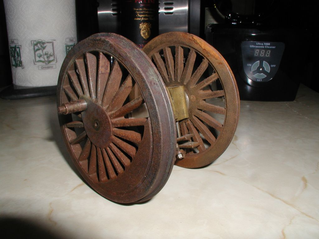

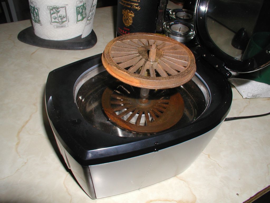

                                            Hi all, last Sunday I was in my local Maplins store just browsing, when I spotted a James Ultra 7000 ultrasonic cleaner on offer. Needless to say I bought it on a bit of a whim, just to see what it might do. I realise that many think these are small and not capable of much, but there you go.

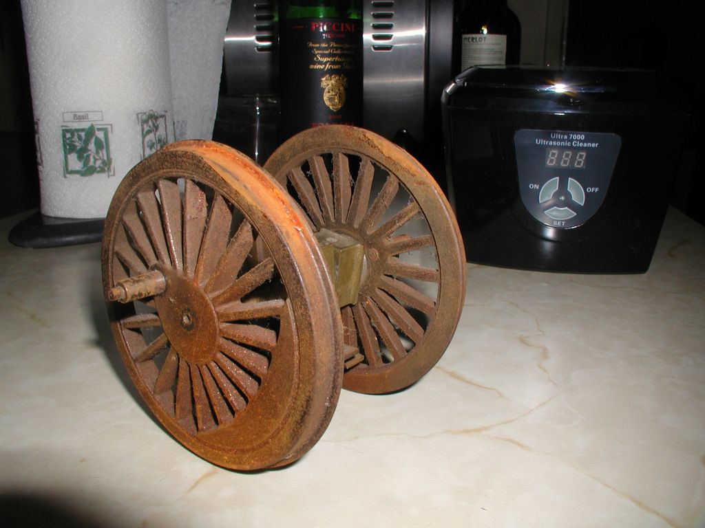

                                            This morning I have had the chance to try my new cleaner out. I choose to clean a pair of Olympiade loco wheels that my late farther turned up back in the 1940’s, which have become a bit rusty. The first trial was with a 90 second burst in plain water with a couple of drops of washing up liquid followed by a second 90 second burst and a 280 second burst. After these three bursts it was much cleaner and a lot of the rust was removed.

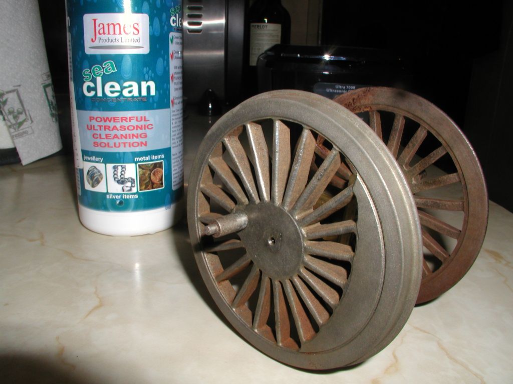

                                            The other wheel was then cleaned, but this time I used James Sea Clean solution and three bursts of 90 seconds, and the result was very much improved, with most of the rust removed and the greyness of the wheel casting visible.
                                            If nothing else is good about small ultrasonic cleaners, at least this one will clean up all the wheels that my late farther turned up all those years ago, without using harsh abrasive methods, time and lot of elbow grease, and especially having to get into all the spokes.
