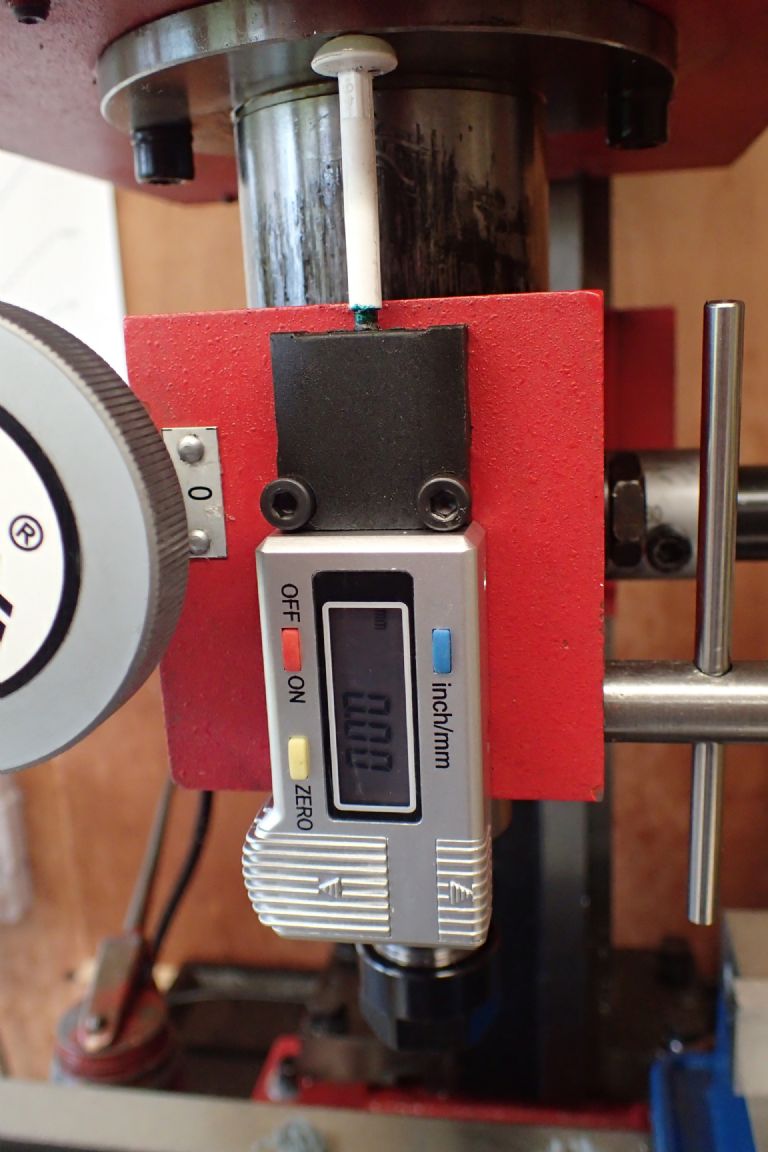

      I use a cheap tyre depth guage as a simple quill DRO on my SX1LP. Apparently it is a capacitance based measuring device.
      It works very well – as long as I keep my fingers away from it. If I switch it on or zero it using my fingers I get 0.03-0.05mm "jitter" on the display. Zero it with a non conducting object ( plastic T slot cleaner usually) and all is well.
      Take the device off the mill and it behaves perfectly as does another similar unit I use for measuring the depth of holes.
      I suspect the issue is a capacitance effect between me and the ground plane provided by the big lump of iron to which it is screwed.
      Can anyone explain in a bit more detail how these things work, and make any suggestions as to how I might screen the problem. A bit of brass or plastic between the device and the mill head makes no difference.

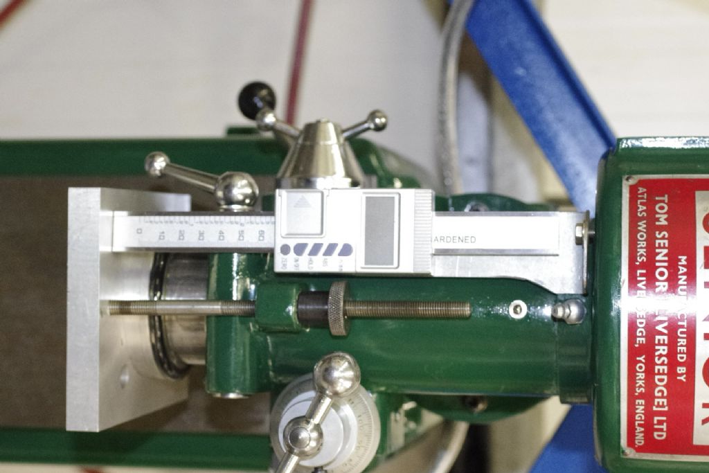

                _igp2442.jpgThere are plenty of variations available, we have two at the museum, and have never had any problems, they are based on digital caliper technology._igp2441.jpg

                              Thanks for all the thoughts, I did some experiments based on the ideas. Robert G8RPI's idea worked. If I touch the head of the mill with one hand while pushing the buttons all works fine.
                              The gauge works perfectly as a simple DRO when the machine is running or stopped. The readings correspond to the markings on the fine feed knob (without the backlash) over the full 25mm range of the quill (and the tyre gauge) as long as I keep fingers away from it. There is no sign of flicker in the readings when the mill is on or off, running or stopped.
                              However – the problem IS electrical interference, but not from the mill. By accident I experimented while the workshop lights were off. All worked perfectly. Switch on the overhead florescent tubes – problem reappears. If I hold the gauge very close to the florescent fittings the readings go haywire.
                              I can only conclude that if I don't touch the mill head while pressing the buttons I am acting as an aerial for the interference from the florescent tubes. So either a better guage to use as a DRO (one with a metal body?), some new light fittings for the workshop or simply touch the mill before zeroing.

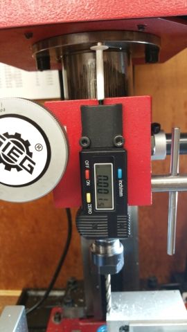

                                                    Just an update for anyone interested. I obtained a new "silver" tyre gauge and swapped the front part for the one I was using as the mill DRO.
                                                    The problem of the flickering display went away. Presumably the thin coating is sufficient screening to fix the problem. There is a side benefit. Although the devices look identical apart from colour, the new one does not loose its setting when it switches itself off, and comes back on when the quill moves. The old one reset to zero when it switched off, and had to be manually switched on again – so they are different implementations.

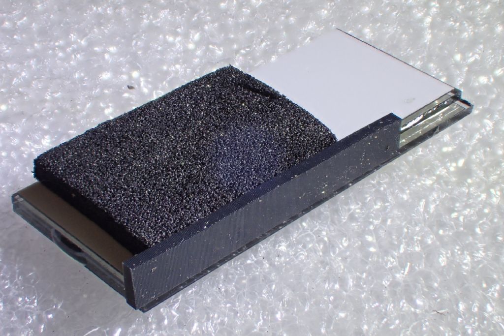

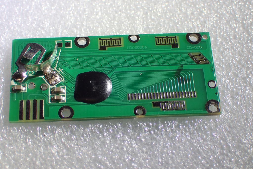

                                                    In swapping over I had to dismantle the original device and came across another interesting curiosity. The back of the LCD does not appear to have any electrical connection with the PCB.
                                                    The display has a strip of what feels like rubber along one edge. I cannot – even with a loupe – see any contacts on the rubber.
                                                    While the PCB has a corresponding set of pads onto which the rubber strip presses
                                                    I can only presume that the strip of rubber conducts from top to bottom, but not sideways so that matching pads on the LCD connect to the pads on the board. If so that is high tech (and potentially quite useful) material in something that cost me a fiver delivered – so what did it cost to make!!

                                                      Thanks for the interesting and useful update, Peter
                                                      … Regarding the rubber : I think you might search for ‘Zebra Strip’
