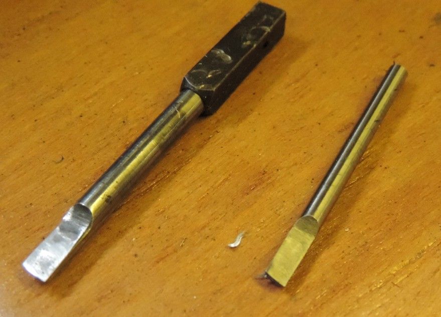

                          Thanks. This is the Beginners site, and, there is no better begining beginner than me. However, the help on this website is taking the incline out of the previously very steep learning curve. Would it please be possible to include a photo of what the finished item will look like. I understand that the main shank of the tool will have to be a smaller diameter than the cutting tip but what form the d-bit is, has me foxed. in addition, I presume a round bar will have to be mounted in a bar holder, or have flats ground along the diameter. My machine takes 10mm tools. I have a grind stone and the tool to dress the stone in order to maintain a true surface.

                              Hi 13,
                              No it's simpler than that. You literally grind away just over half the HSS rod for a short distance (say 10mm) back from the tip. You can grind the end back at a slight angle to give a bit of relief, but don't touch the shank.
                              Fit in the toolholder just as Ian describes.
                              Take a look at my album HERE
                              In the photo below the one on the left is from silver steel .hardened and tempered, and the one on the right is HSS, just ground.
