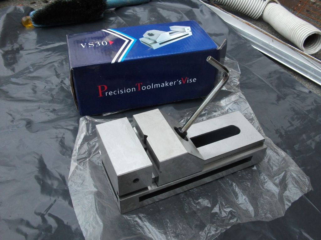

                    For those of you who may be interested in buying this type
                    of vice have a look in J&L MSC Advantage Flyer August
                    page 13 at these Interstate vices on offer.
                    I bought the larger of the two some while back ,its very well
                    made.

                          John P, that's really interesting, yours looks different from the one pictured, how does the jaw movement operate on yours? I can't see holes in side? But there are in the picture?

                            Hi Pete.
                            I guess the flyer photo is the smaller of the two , the holes in the larger vice that i have
                            are just inside the hold down slots in either side ,the jaw movement and
                            mechanism works just the same as the Arc vices .

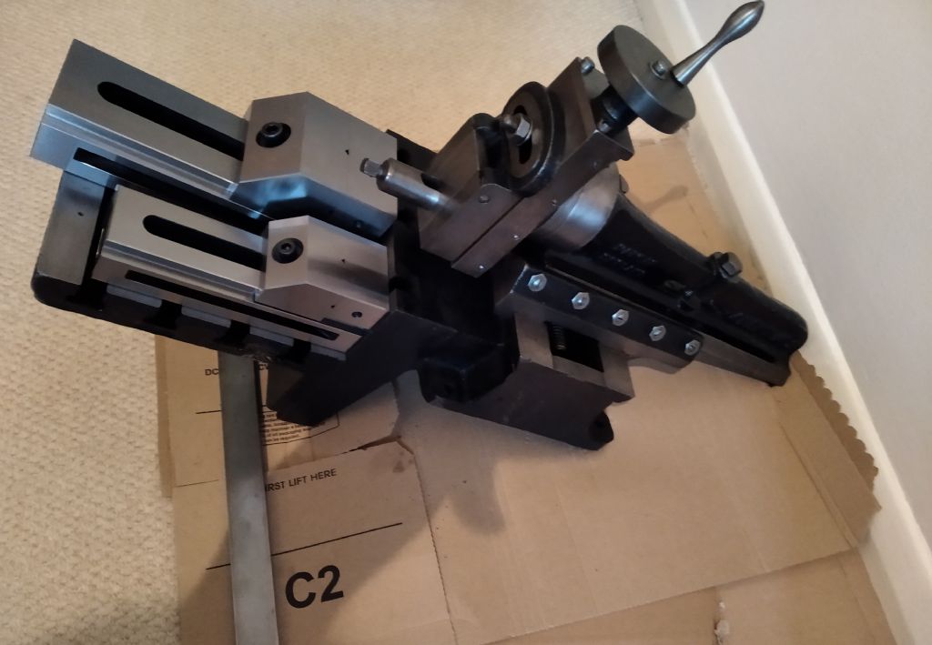

                                          The 2 vices arrived today, the 72mm version I originally thought would be suitable is a bit on the large side for the adept no2, the 50mm version is the one I'll use, at 140mm total length, with 75mm opening, it's quite a neat little vice.
                                          Shaper vice
