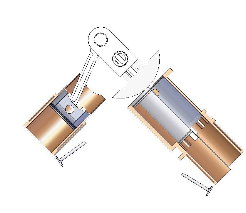

      Some austrians try to take over the market for catalyzed IC driven generators for hybrid cars.
      Two stroke range extender.
      It is a two-cylinder two -stroke but not like the famous Trabant where crankcases blew the cylinders with fresh charge.
      It is claimed that exhaust can only be catalyzed ,if fresh charge come from blowers separated from crankcase.
      Crankcases are full of oil and slidebearings like fourstrokes .
      Why?

              The philosophy is they run the thing with a pme of only 6 bar or ca half theoretical full charge.
              With longitudinal scavenge no unused oxygen escapes during scavenging and cannot disturb lambda measurement.
              Unburnt fuel is low on both scavenge schemes and with no fuel in crankcase the oil content in exhaust is not vastly different I think?

                    Somewhere it is written that they intend the twin 2-stroke to run at a mep (mean effective pressure) of 6 bar and have a maximum pressure of 45 bar.
                    A fourstroke with well engineered inlet tract can run 12 bar mep and ca 75 bar maximum.
                    Same power from same cylinder volume.Which is lowest mass?

                      It is also complicated by being two-cylindered with a lot of gearwheels ,whirling counterweigths,camshaft etc.
                      I have tried to compare size for a valveles VeloSolex with a coresponding sidevalved version and both crankcase scavenged.
                      One sealing ring will do
                      The Austrian need many more to seal two separate crankcase pumps from oil for gear and cams and bearing.
                      Edited By Niels Abildgaard on 30/06/2023 08:25:11
                      #650420
                      Niels Abildgaard
                        @nielsabildgaard33719
                        The crankcase scavenged has a volume/packaging advantage
                        Crancase versus blower
                        Edited By Niels Abildgaard on 30/06/2023 08:38:31

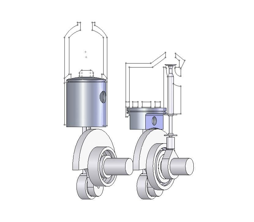

                                            Comparasion of packaging
                                            Left
                                            One way oil crankcase scavenging
                                            Rigth
                                            Wet sump lots of oil
                                            Upper Austrian with electric blower
                                            Edited By Niels Abildgaard on 02/07/2023 09:33:35

                                                The Spulgeblaese (blower) on picture is maybe mechanical driven.
                                                It is difficult to see.
