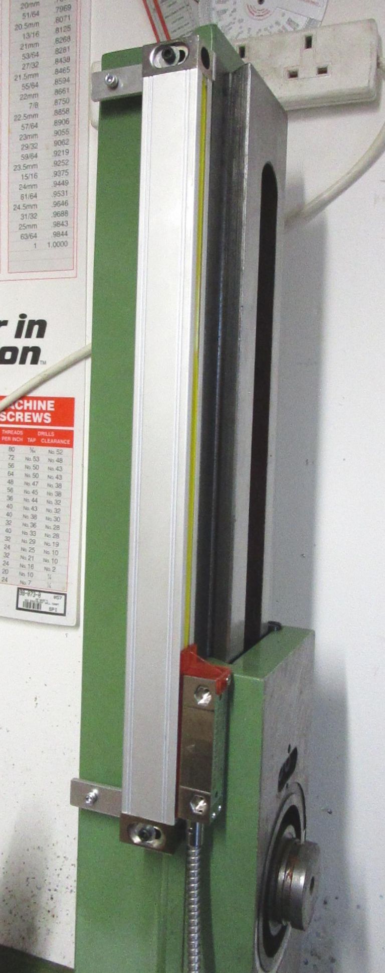

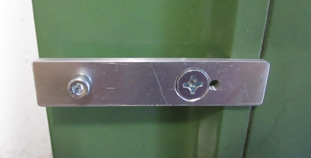

            Hi Guys,
            I've just fitted a DRO to my Chinese copy of an Optimum mill. I put a glass scale on the column so that I can read the head height. My mill also has a readout on the quill for drilling depth.
            I used a pair of aluminium brackets to mount the scale. I also used a spacer plate between the read head and mill head to match the thickness of the brackets.
            I think the protective plastic dust cover is a nice touch ! Keeps greasy fingers off the membrane buttons.
            Like all things, I should have got one years ago…

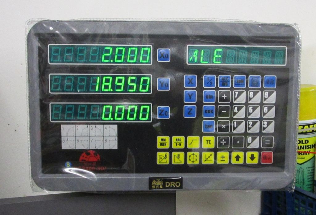

            #533338
            Frances IoM
              @francesiom58905
              I like the “ALE” function but should you be drinking + operating machine tools?

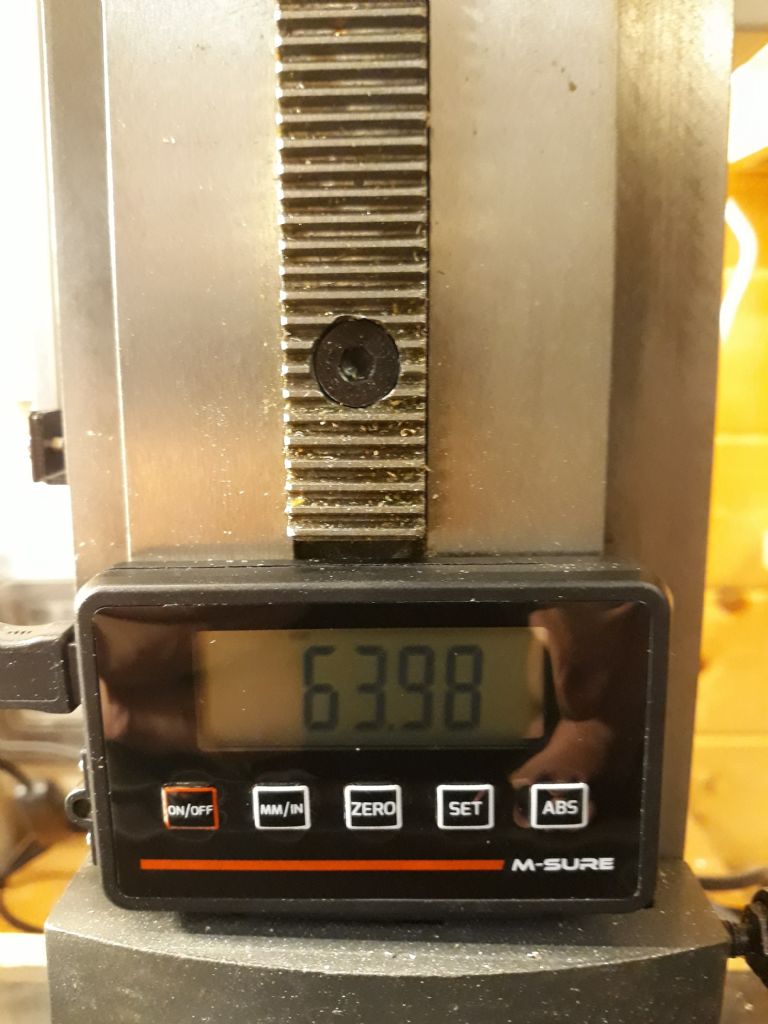

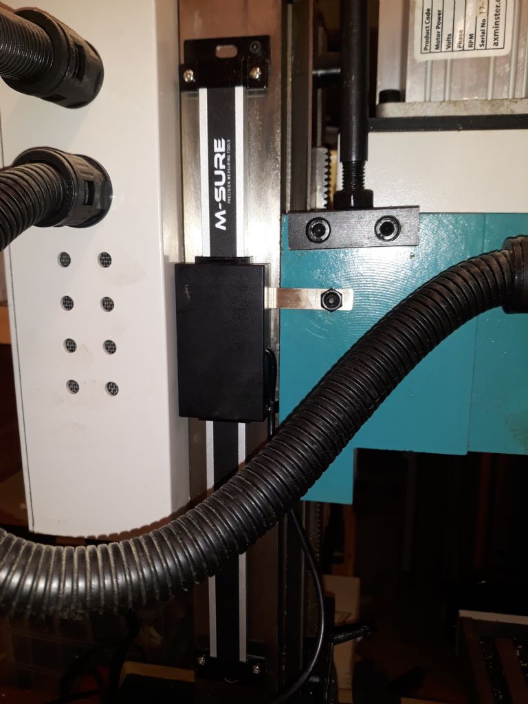

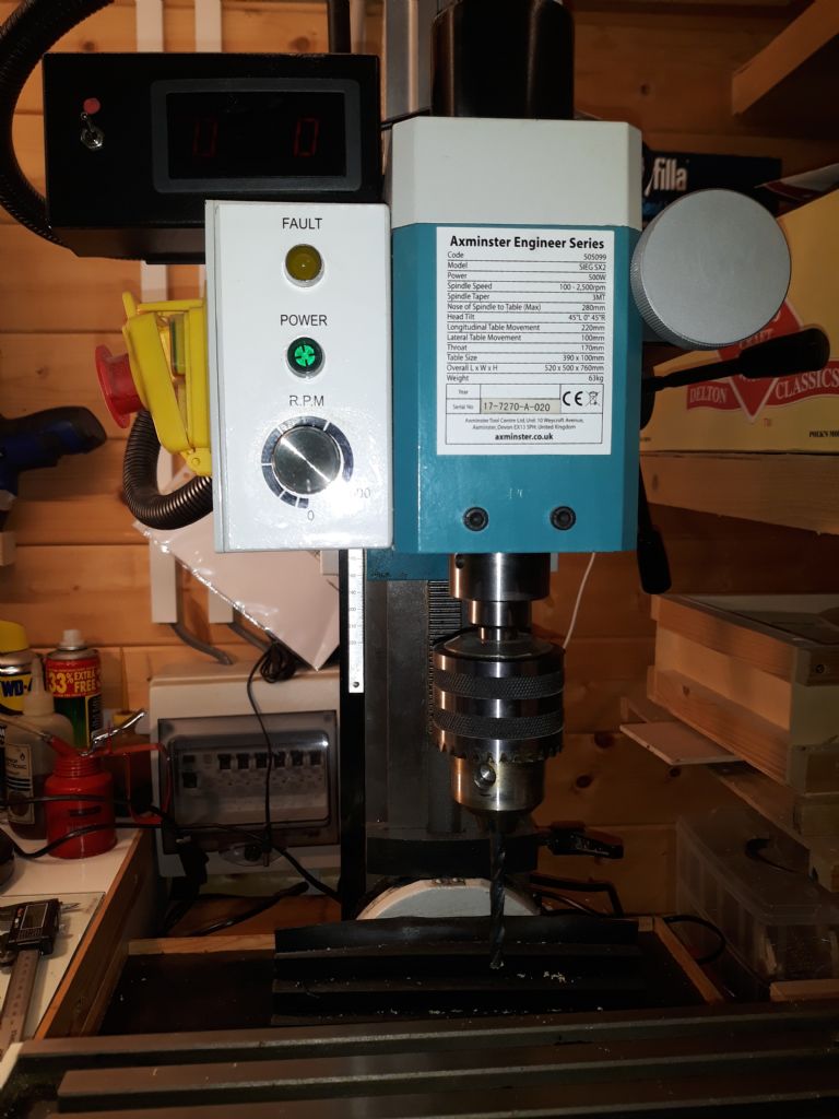

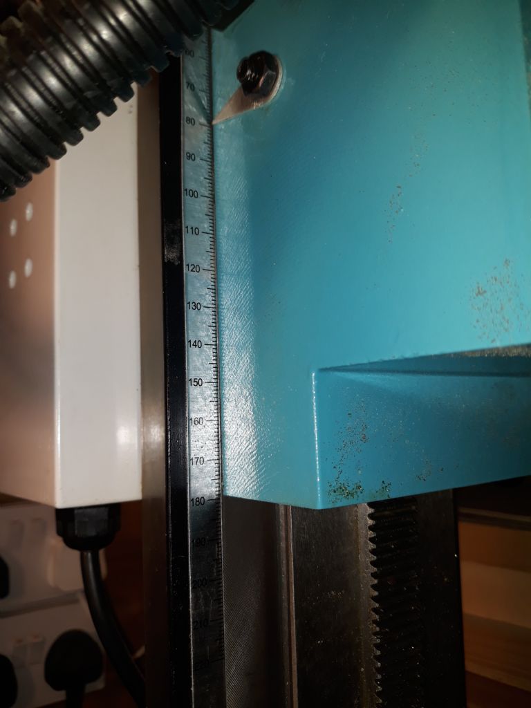

                              Back to my single axis z-axis problem on the SX2. This is what you see when you in front of the machine
                              The depth indicator is well hidden behind the motor control. Lets have a closer look.
                              I have to say I am not acrobatic enough to read that while lowering the drill (not such a problem when milling, as you normally use the fine feed)
                              Solution: A cheap, battery powered single axis DRO. Now already in position. Using the screws which held the millimeter scale I need only one extra hole to fix the sensor in position. The brass strip making the connection between sensor and milling head is using the hole where the old, mechanical indicator was fixed.
                              And finally the screen. There are several possibilities to fix it, I just used the magnets on the back to fix it to the column. In case it is in the way I can always move it to somewhere else.And the DRO screen.jpg
                              This made my day, a quick fix for £30.

                                Gerhard,
                                Can I suggest that the display is not in an ideal place fixed to the front face at the base of the column. It's in a direct firing line for swarf/cutting oil etc, ti's up to you of course.
                                #534094
                                  It is also sitting on the column stop. If drilling to a specific depth the stop is fixed with ref to the printed column scale to allow the desired quill movement with no risk of drilling too deep.

                                    Posted by Ron Laden on 16/03/2021 07:16:03:
                                    Gerhard,
                                    Ron, thanks for the hint, but I think this can be fixed with some transparent plastic sleeve

                                      Posted by JasonB on 16/03/2021 07:37:04:
                                      Jason,
                                      correct, I need to raise the depth stop otherwise I cannot use it. But as said above, the display is just fixed by 2 permanent magnets, so no problem there. The printed column scale is gone, as a) it was in the way and b) I used some of the fixing holes to fix the new, electronic scale.
                                      #534187
                                      mechman48
                                        @mechman48
                                        Why not attach it at the top of your mill head, then you have the readout directly in front of you & away from swarf/oil/ ingress, the magnets should hold it securely enough & the cable is long enough?.
                                        George.
