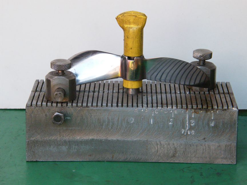

      After breaking my high tensile 130 plus mph flash steam propeller after the August crash I'm in the process of making another one.
      I used a nickel air/oil hardening steel for that one but have very little left.
      I'm thinking of making it out of en24t as I have enough of that material.
      When I tried using that before when I cold twisted it about 30 degree it cracked.
      The section twisted is about 2" x 1.25" x 0.156" thick it is initially a Ø1.25" bar that has the 2" sections milled in it .
      After twisting it is hand finished using angle gauges and a simple jig profiling it into a propeller.
      I would like to leave the en24t in its present strength as to anneal will loose that property if I do anneal to try to stop it cracking how do I with basic heating equipment get it back to that strength it or is it too specialised.
      Others have used en24t for props but if they twisted it as well I do not know.

            Only a loose thought but I have arc welded(cheapo Lidl welder) small thin parts recently and you have to be in-and-out in a second or two to prevent the piece from being damaged by heat
            This does however red heat the entire body of the workpiece quickly and efficiently, making it possible to plunge the workpiece in, say oil, or twist it while still hot as a blacksmith would
            Forging( battering it with a hammer while hot ) can also increase its strength
            You would have to experiment of course to acquire these micro skills, if you were to try this route, and the small spot weld would need to be removed

                This website might help.
                EN24T Alloy Steel
                If you can borrow a copy of 'hardening tempering and heat treatment' by Tubal Cain, that might help as well
                If you do have a go yourself, I'd do a test piece at the same time and try to do some destructive testing on it. I wouldn't want to be stood in line if a blade parted company. Best of luck
