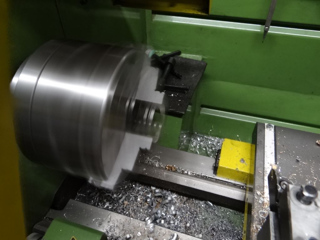

                                Those who've failed to find stroboscopic effects haven't looked hard enough!
                                That said, the effect is often small and I doubt it's much problem in practice in a small workshop where the noise of a machine running is often enough warning in itself.
                                But imagine you're in a large machine room lit entirely by fluorescent lights all flickering together at 50Hz with several noisy machines racketing away in the background. Perhaps you're wearing ear-defenders. Also, you're unluckily turning a strongly contrasted lump of bright steel and it happens to be rotating with just the right diameter and rpm to sync with the lights. A moment's inattention and you could get caught. Bit unlikely, not impossible. Actually, stroboscopic effects are much more obvious with largish objects like poorly lit fan-blades and gear wheels. Beware of them!
                                I have a mix of HF and conventional fluorescent lighting with HF over my lathe. It creates an effect not unlike strobing because the light bounces off the rotating jaw into my eyes at the same angle:
                                Not a camera trick, the photo is very like what I see – a chuck that at a careless glance looks as if it's stopped. As with a lot of accidents, several factors are often required to come together. I might fall for it if I was tired, drunk, distracted and unlucky. But not normally!
                                The other end of my workshop has ordinary fluorescent lights. Here I notice true strobing once in a while, but it's not strong enough to fool me. It's hard to imagine it causing an accident. The best way to see strobing is to spin an object with black stripes on a white or shiny background in low ambient light.  Used to be quite hard to see adjusting the speed of a teleprinter governor with a neon bulb and very obvious at the strobe lit Discotheque of my youth.
                                Another factor may be the age of the tube and the type of phosphor inside. Some tubes flicker a lot more than others, and old tubes seem worse than new ones.
                                HF tubes flicker much faster than the human eye can detect and the effect isn't synchronised between lamps. Like LEDS, they don't strobe.

                                  Interesting 2 jaw chuck does not fool me into thinking it is not rotating.wink
