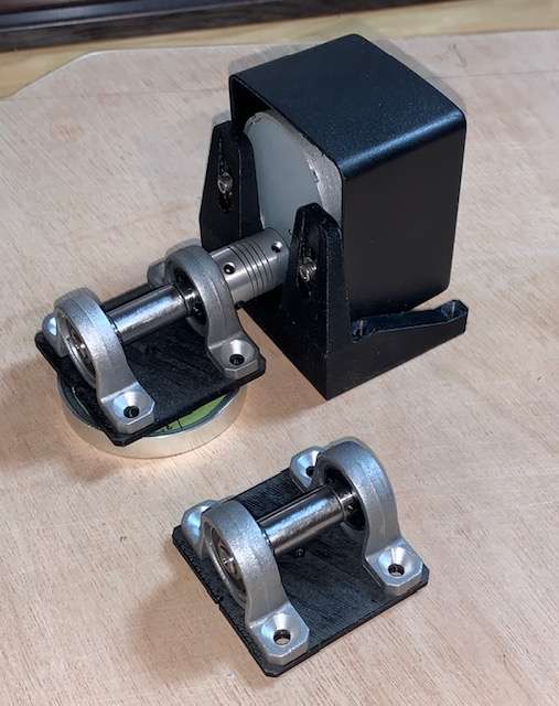

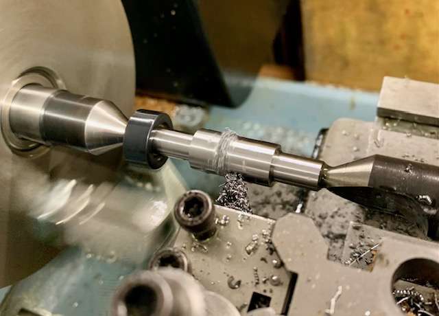

      All, I need to make a small shaft about 55 mm long. It is to fit between two bearing blocks, so the shaft will have a c.12 mm diameter central ‘bulge’, with two 8 mm diameter x c.15 mm long spigots either side to fit into the bearings.
      All the cylindrical features need to be coaxial, and also there may be a requirement to turn down the central bulge later depending on experimentation on the device (an equatorial platform for a telescope).
      I assume turning between centres is the way to go, starting by cutting the bar to length and centering the ends. I’m struggling with how to grip the small stock firmly for turning, without damage? The turning dog I’ve got is way too big for this job.

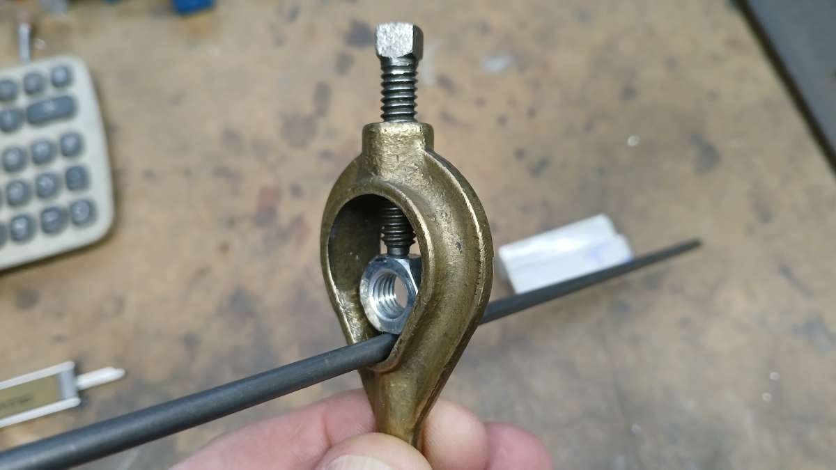

        If your driving end has a pin sticking out, you could always use a shaft collar. Replace the grub screw with a longer bolt that reaches beyond the drive pin. I bought a cheap set  with multiple sizes for the purpose.

                  Packer protects the work and lets you hold small items, 4mm dia in this case.

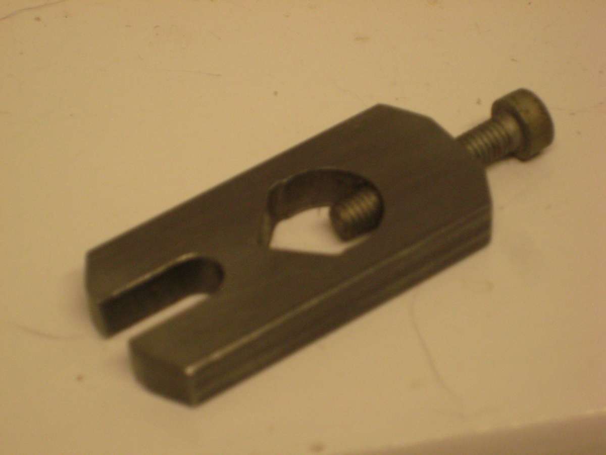

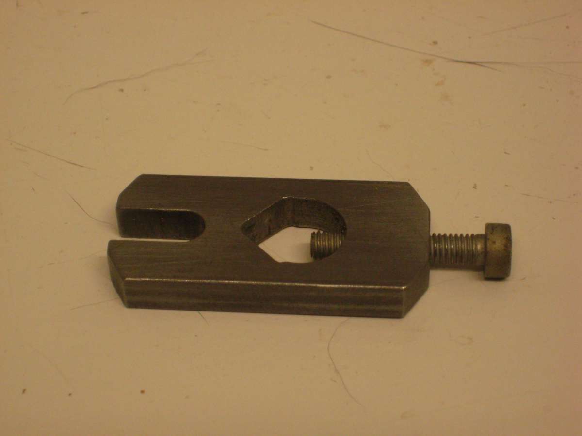

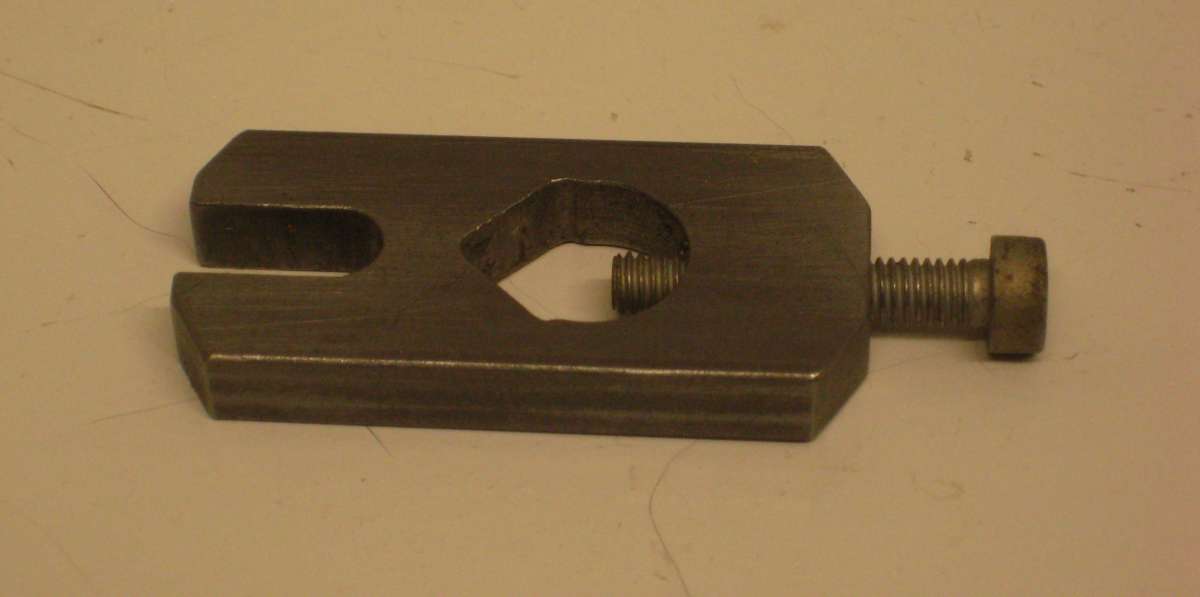

                    Made from a piece of 1/4 x 7/8 MS bar. Hole drilled 13 mm and filed to shape. Poor photos but I’m sure you’ll get the ideaIMG_0275Is there any way of putting photos where you want them and at a size that I choose ?
                    #778469
                      Photo appears where you had the cursor before you clicked the image icon so don’t do it straight after altering something in the middle of your text. Size depends on what you are uploading and the site won’t make it bigger but will reduce it if too large.
                      Rather than a slot for a drive pin you could also tap a hole for a screw which can be driven by the side of a chuck jaw

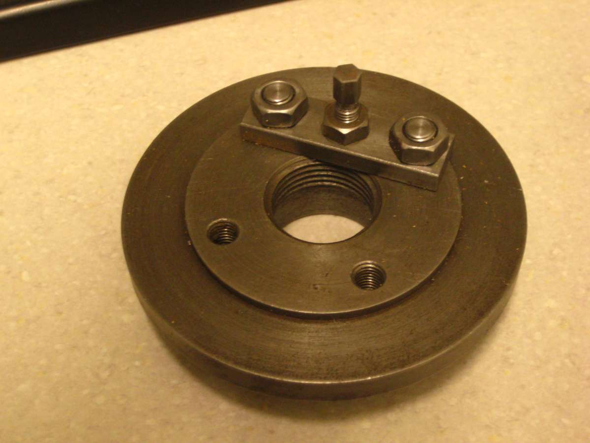

                              I take your suggestion re. a tapped hole for a screw. I first made this arrangement for a job where any play in the drive would have been unwelcome so the hex driving pin in the third picture can be twisted and locked so that it is snug in the slot.
                              Carrier 1Carrier 2IMG_0279

                                  In the end, Peter’s post reminded me that I’d also bought a set of cheap collars for some reason (I think for use on drills to act as depth stops, but they weren’t very good). I used a long bolt and some brass strip as per Jason’s suggestion to protect the workpiece. I was able to use my small Myford faceplate with a drive pin made from a bolt and some long nuts.
                                  To be honest I’d over-estimated the torque I’d need to do this job – I thought it would slip all over, but it was fine.
                                  Daft as it sounds I’m still not much good at turning cylindrical parts when it comes to getting accurate lengths between stepped features. I end up either turning up to a marked line, or trying to use the top slide – which is fine unless I want to angle it to creep up on a diameter.
                                  Anyway it seems to have worked OK. Ignore the poor finish on the surface – it’s intentional because it’s for a friction drive on an aluminium segment.
                                  IMG_2369
