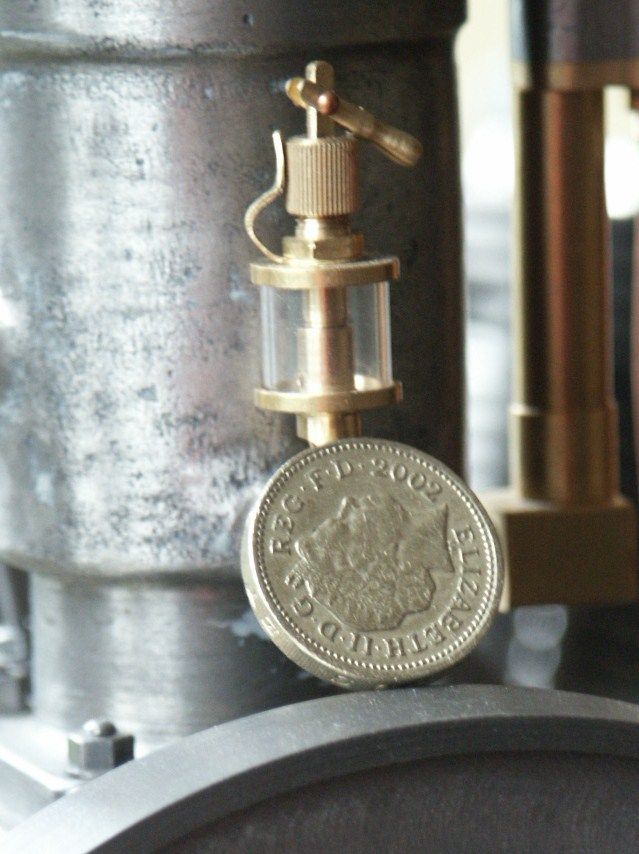

                          I use Micro-Mesh to polish the perspex, this little oiler glass was polished inside and out with it and it comes up crystal clear, better than the photo shows
                          Oiler
