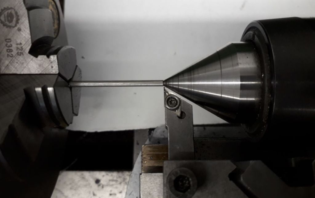

      I am turning some clock arbors in silver steel. The steel is tough so I am finding it easier to do in my Myford ML10 than in my Cowells. I have a reasonable set of collets for the Myford – most 1/32" increments – so holding the work at the headstock end is OK (except that the Cowells watchmaker collets are all metric, so switching over is awkward). The problem comes with the tailstock as all my centres are far too large and I can't get the cutting tool close enough to the end.

          What tool are you using I can happily ctr drill and turn down to a 3/32" shaft and use a MT3 revolving ctr.

            My Myford tools are a bit clunky – about 3/8" square. Now you mention it I guess there is no reason why I shouldn't use one with a much narrower tip.
            #410797

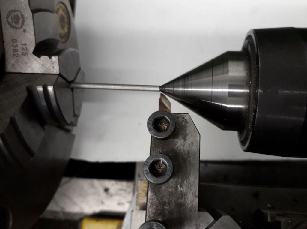

              YYes that's the basic Idea. I tend to use a 10mm shank 55 degree insert tool which leaves a 5 degree clearance to the live ctr.
              You can also grind up some HSS to a similar shape. Also you don't need such a large section tool though depending on your toolpost it may clash with the tailstock Ctr unless you have a lot of tool sticking out in which case one of the Dickson extended tool holders comes in handy

                Thanks for this. The photos are especially helpful. I have some HSS blanks and will try grinding one to the shape in the second picture. I don't have a Dickson style toolpost but my 4-way quick change one should work I think.

                        As the job has caused trouble on a Cowells and an ML10, both of which are up to cutting Silver Steel, I wonder if the problem is entirely due to choice of knives? Old-timers ground a huge variety of shapes and sizes to get the job done, and carbide inserts are even more diverse. I still get into trouble through not changing cutter to suit the job. (Perhaps I should order a quick change tool-post). Bother getting big tools into tight spaces, not getting enough reach from a small tool, trying to finish with a roughing tool, and wasting time while a baby insert eats it's way through a lot of metal. Etc.
                        Grinding HSS is an acquired skill, and it seems not everyone is good at it, blush! Partly for that reason I use carbide most of the time. To get the necessary range of cutting options I have holders in 6, 10 and 12mm for round, triangular, square and sharp inserts. (Not in every size!) Although I own a good selection, I still occasionally find myself grinding HSS.
                        Jason pictured two cutters shaped to tackle the problem. My preference would be the sharp carbide insert because I have one and it's easy. Second choice would be to grind HSS to shape. Although lots of chaps will tell you grinding is easy, it would take cack-handed me a while to get a satisfactory cutting profile on Jason's HSS example. Try it and see. You might be a natural, but don't despair if sharpening HSS takes more practice than you were expecting. Sparey's 'The Amateur's Lathe' is helpful.

                                        Ground a tool along the lines in the photo. Its working very nicely!
