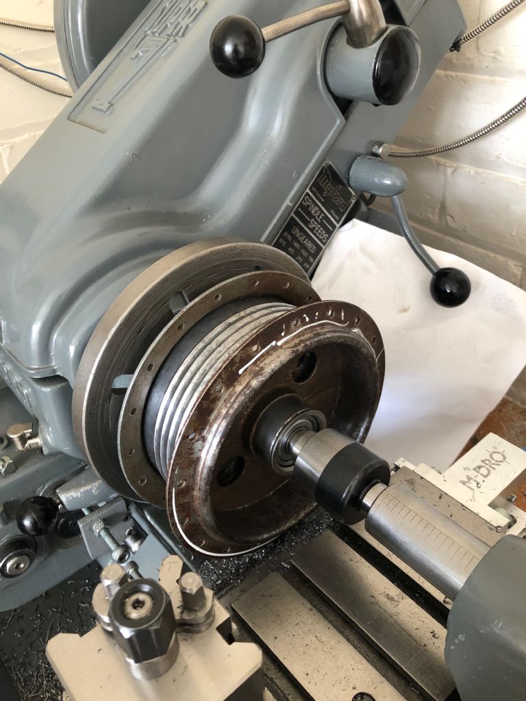

      I did machine the part between centres in the end, as I was skimming a brake drum, and that gap can come in handy

                John MC
                  @johnmc39344
                  Nice tip from Neil L, I'll try to remember that.
                  Machining motorcycle brake drums, no point in doing that unless the hub is laced in to a rim. The spoke tension will distort the drum.
                  When I do that job I put the live centre in the lathe spindle and the dead centre in the tail-stock. This forces the (complete) wheel to revolve on its own bearings as it would in service. It is debatable if this is really necessary but it eliminates another possible source of error.

                  Hopper
                    @hopper
                    Posted by John MC on 22/02/2022 10:59:40:
                    Good luck fitting the whole wheel in a Myford though! Minibikes only.
                    At the factory, the drums are usually machined before the wheel is laced up. Works good enough for general use. But the racing guys like to do as you do and skim the drum with spoke tension on the hub to get a perfectly round drum in service. Then skim the brake shoes to match while they are mounted on the brake backing plate with a couple shims to put them them in the working position.

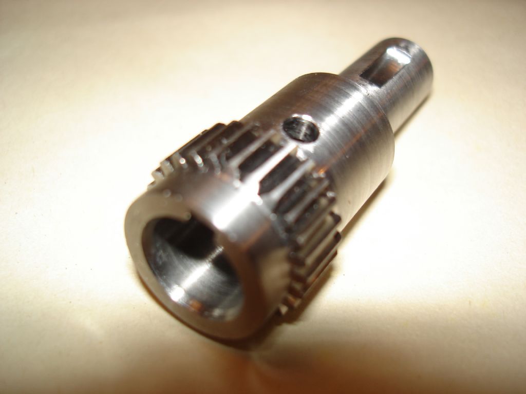

                      Posted by Neil Lickfold on 21/02/2022 20:56:51:
                      I have made parts between centres, where I use the centre taper to be the driver.
                      I finish parts in the same way. The centre shafts for the carriage dial are roughed out using collets and then finished between centres.dsc01978.jpg
