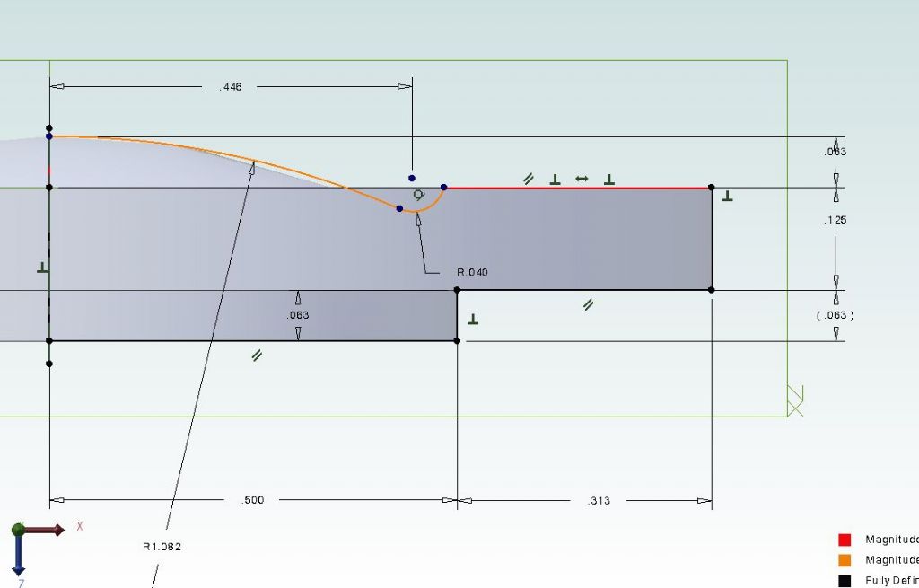

      If it's of use this is the profile I drew for the Victoria, radius and protruding

        Thanks Jason, I drew something out on CAD earlier, I think it will be OK. Just have to work out the co-ordinates. I think 25 increments of 0.020” on the cross slide should be good, using a 0.8 tip radius tool. Might need back-gear for this one:
        Couple of questions:
        1) The minimum section ends up at about 2.6mm. I say this should be OK to take the cylinder pressure. The original minimum is about 3mm, but I’d expect a large safety factor within that?
        2) I want to keep distance x to 7.5mm. Reason is that the front covers are that, and that dimension keeps the bolt PCD in the middle of the faced area. The angle of the tool tip means I can’t touch on the O/D and wind inwards by a set amount before going into the end. And I want that profile generated by the tip going in to form the edge of the dome. Any suggestions? Maybe start at the centre and work outwards – but that means determining the exact centre using the tip I guess.

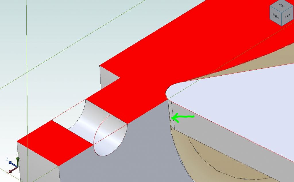

              Looks like you may just have enough clearance
              #564774
              Dr_GMJN
                @dr_gmjn
                Ah, I misunderstood – tool rubbing on its flank, on the ‘I/d’ of the step?
                Do DCMT inserts have a standard flank angle (to stop rubbing) that you’ve modelled?
                Thanks.
                #564778
                  Yes, the C in dCmt signifies the angle which is 7degrees and by far the most common though others are available. This is why you see the insert boring bars tilting the insert at an angle so the side does not rub in a small bore.
