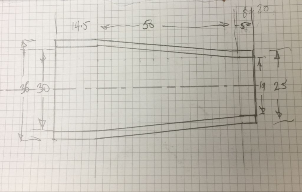

                Wha50768e53-a340-4c93-b4e7-46f1830430e0.jpegAfter further consideration this is what I really need. I think it will be simpler to make in three pieces as it is, after all, only a spacer between two bearings of different sizes. I’m currently thinking if I turn my stock to 36mm then bore 19mm and turn the 50mm length inside and out with the narrow end towards the chuck I can then part off and have the bit in the chuck to use for my 14.5mm parallel tube. I can then make the smaller diameter parallel bit from a suitable size of feed stock. I could also make the wall thickness 4mm.
                What could possibly go wrong

                #382284
                Brian Wood
                  @brianwood45127
                  Hello Andy,
                  Now that you have thoughtfully provided a drawing, forget my contribution, I misinterpreted your description completely! For a start I took the wall thickness to apply to the minor diameter end
                  Retiring to think again, sorry

                  ega
                    @ega
                    Brian Wood:
                    They say a picture is worth a thousand words!

                      #382319
                      Brian Wood
                        @brianwood45127
                        As ega says, a drawing helps a great deal.
                        I might now make that shape from tube, it will save a great deal of swarf making. Joining the three sections I would do with short step joints and silver solder the assembly well cramped up to preserve the alignment
                        The central tapered tube could be made from 36 mm O/D tube split down the length with a narrow triangular cut to then ease it together to join on the cut edges making the taper. Bind wire round that before sweating together
                        Just my thoughts
                        Brian

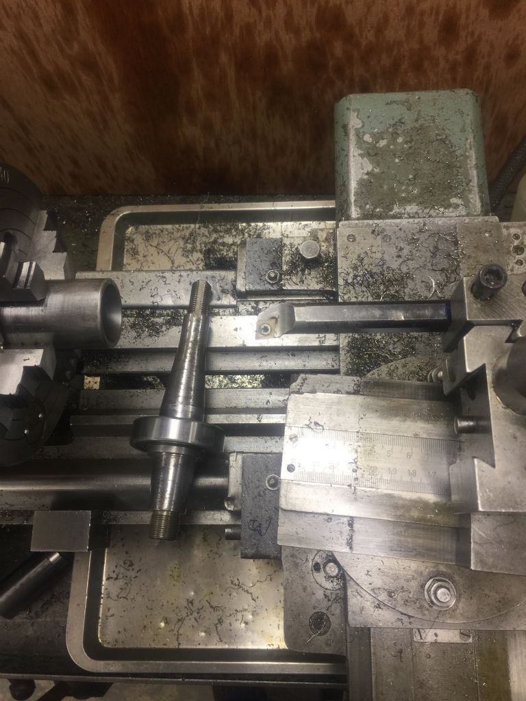

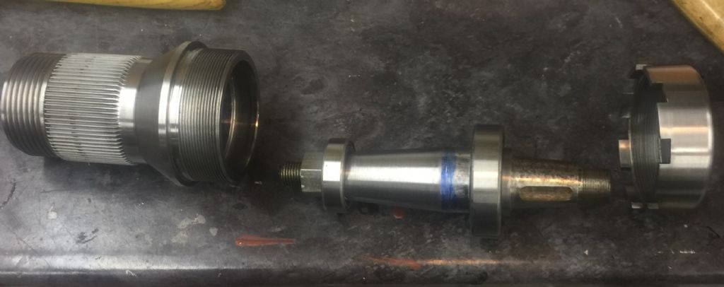

                                              At last I made the spacer!
                                              I held the stock in a 4 jaw chuck and series drilled through the centre ending up with a 3/4" blacksmith drill. I then opened out to 20mm with a boring bar,Bearing spindle.jpeg
                                              I was amazed with quality of finish with such a long extension of the boring bar. The above photo shows this. It also shows the spindle for which the spacer is being made. I measured the angle of the taper as 5 degrees and set the compound over at this angle. Having reduced the overhang of the boring bar I then bored the 30mm short parallel.
                                              To bore the taper I extended the boring bar and set it in line with the spindle axis. With the compound slide wound well back I then advanced the cross slide to the bed stop, wound the boring bar in on the compound until it nearly touched the shoulder of the 30 mm bore. Having measured the length of the taper I then marked the compound slide with the length as below.Compound slide marks.jpeg
                                              I then bored the taper winding the compound slide in by hand. Running at 500 rpm it took 0.5 mm cuts quite happily producing blued steel chips and giving a good finish.

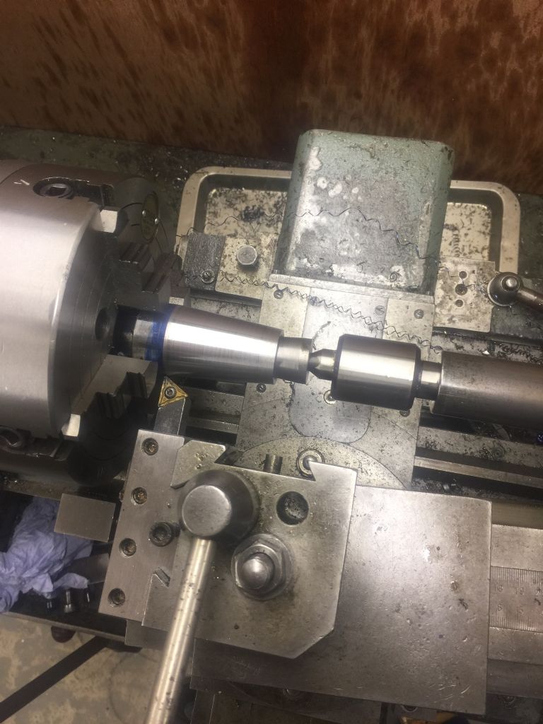

                                              To turn the external taper I made a plug for the 20mm bore that the was supported with a revolving tailstock centre.In the lathe.jpegAgain turning at 500 rpm with a 0.5 mm cut.
                                              This what the finished assembly looks like, well, it will be improved with a bit of Scotchbrite.
                                              In the end it was a lot easier than I anticipated thanks to everyone's advice.yes.
