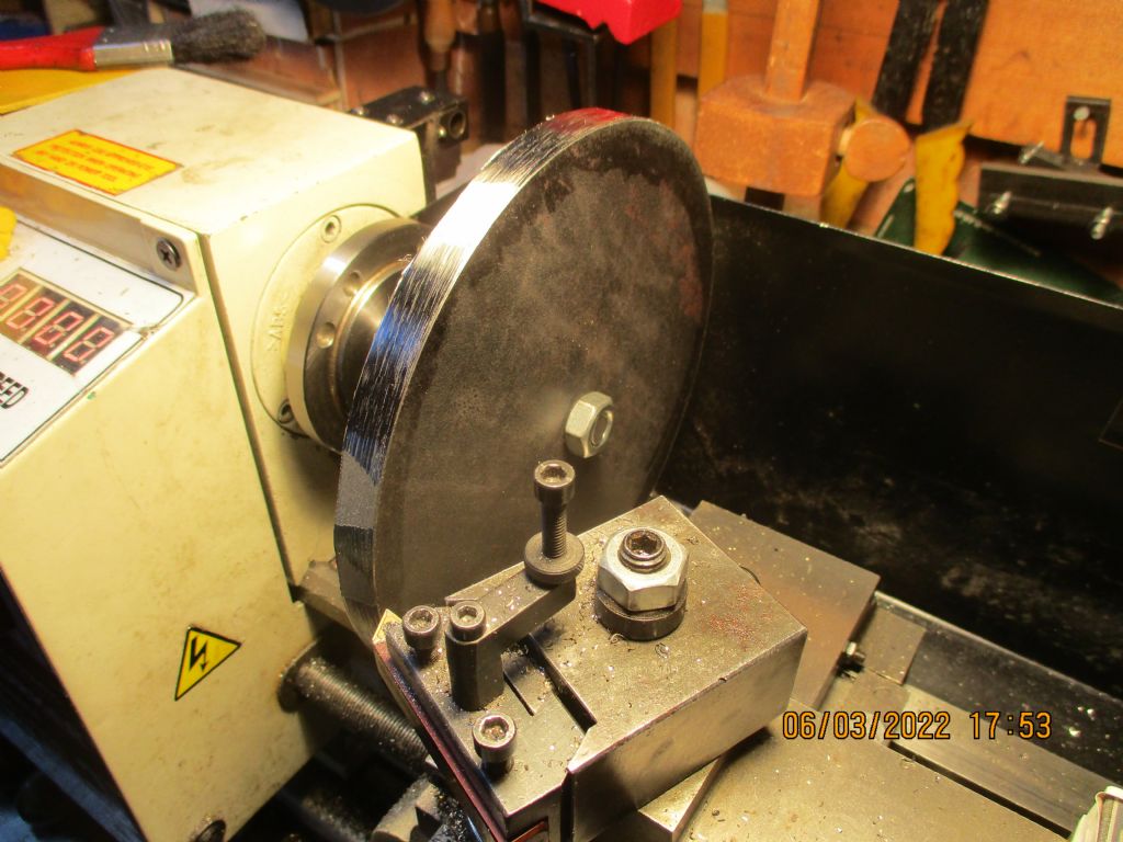

          David Caunt
            @davidcaunt67674
            I've just had to do this for my Half Beam flywheel. First cut the square as near round on the band saw.:8.jpg
            Then fit to lathe. Mine is Chester Conquest. Which says maximum turning is 7" ie just over 177mm. This was only possible with the guard removed.
            This has taken quite sometime and still needs the finishing touches.

            Ady1
              @ady1
              Plasma cutter
              Drill 4 holes in the hole centres
              Cut 4 slightly oversized discs out in 5-7 mins with a jig
