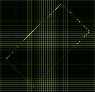

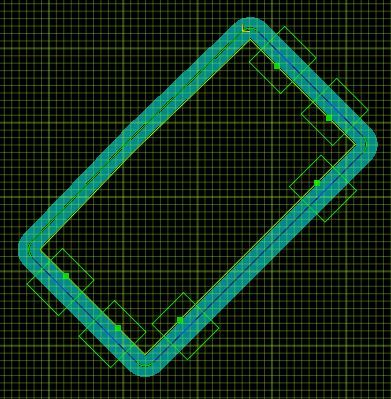

              I thought I'd try generating it in CamBam for CNC milling.
              Assuming it would be milled from 2mm plate, the top shows the plan view and the bottom the toolpaths including 6 holding tabs, using a 3mm endmill. These not positioned on the "active" top left face as they have to be filed away after cutting. You can just about see that this face is slightly curved.
              Though designed initially "flat", I rotated the design to avoid one of the axes having to reverse while cutting the curve which inevitably leaves a tiny mark due to even the smallest backlash.
