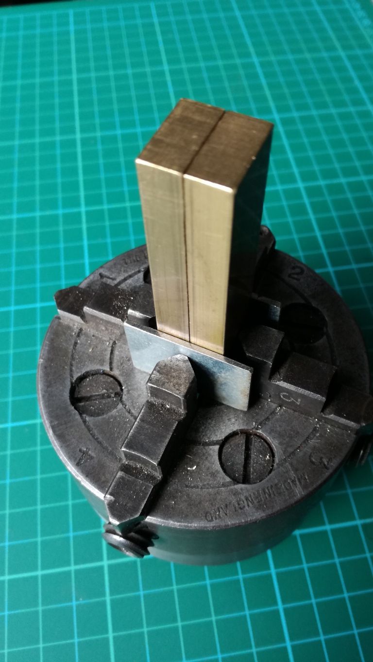

        Hi Paul, further to Clive Foster's idea, you could buy a piece of 3/8" x 3/4" from say macmodels.co.uk, cut two pieces long enough and mount them in your four jaw as shown below, but making sure the centre of the two pieces are central to the spindle axis, drill and tap a small hole in the end sticking out but making sure they are both nipped up to each other and screw in a short grub screw, this will stop the two ends parting away from each other during turning. Put a small centre on the joint for your tailstock centre, and then turn the two pieces down to size. Once turned down, just cut to length. You will then have two pieces of half round, so if you mess up the first attempt of putting the slot in, you can have another go with the other piece.
        Regards Nick.

            +1 for Nick's method. You could also soft-solder the mating flat faces together for more security.

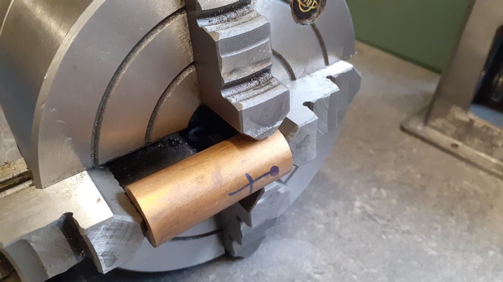

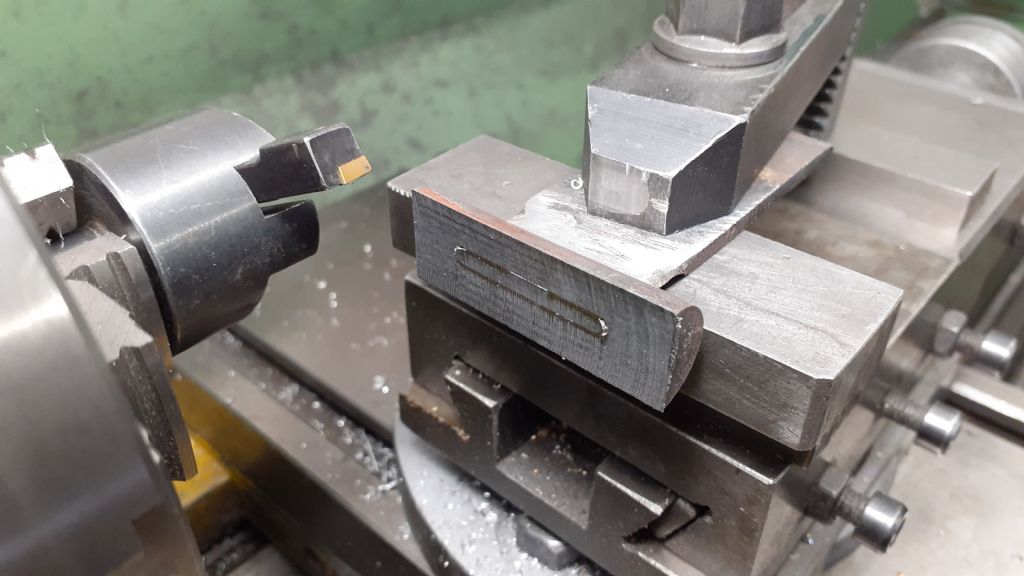

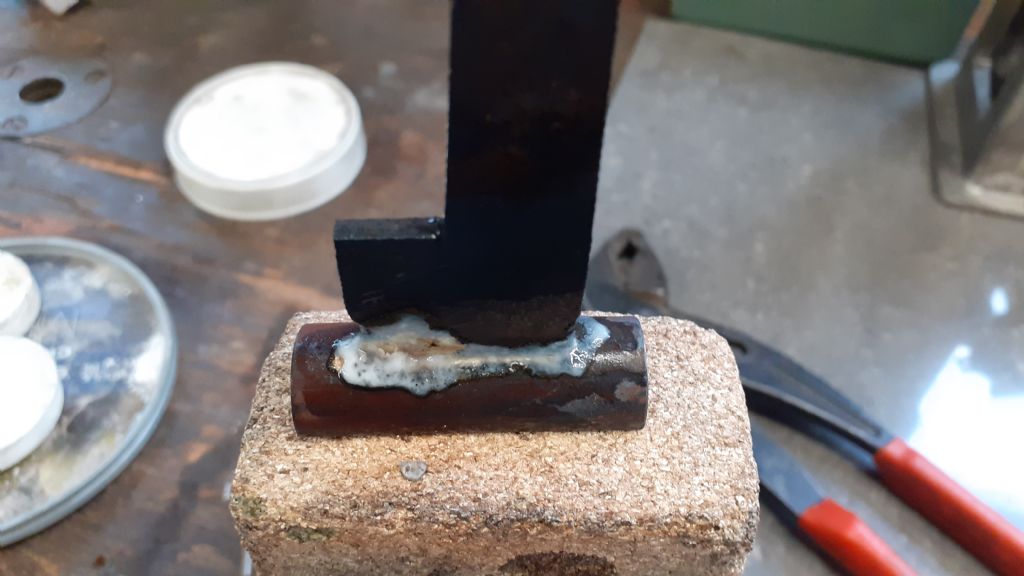

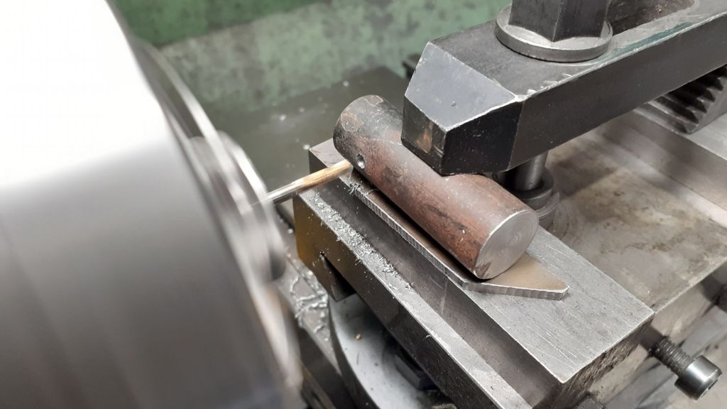

                  Although thetwo flat bits is a way to do it it does seem to defeat the idea of buying a "kit" of materials in the first place and does not really address the issue of soldering the part on exactly true and suare to teh vertical standard.
                  So putting my metal where my mouth is this is how I described in my previous post and answers the question of how to make the part with the material supplied.
                  First face the two ends of the bar
                  Clamp to topslide with packing to bring it upto ctr height. If your toolpost will take 5/8" than you can just hold it in that. You can then drill your series of holes
                  Or better still mill the slot
                  Saw roughly in half to get rid of most of the waste
                  Solder to the vertical member
                  back to the lathe and clamp it by the standard clocking that true along the lathe axis and flycut the end back to half the 5/8" thickness
                  Job done, if you don't have a fly cutter or big milling cutter try this

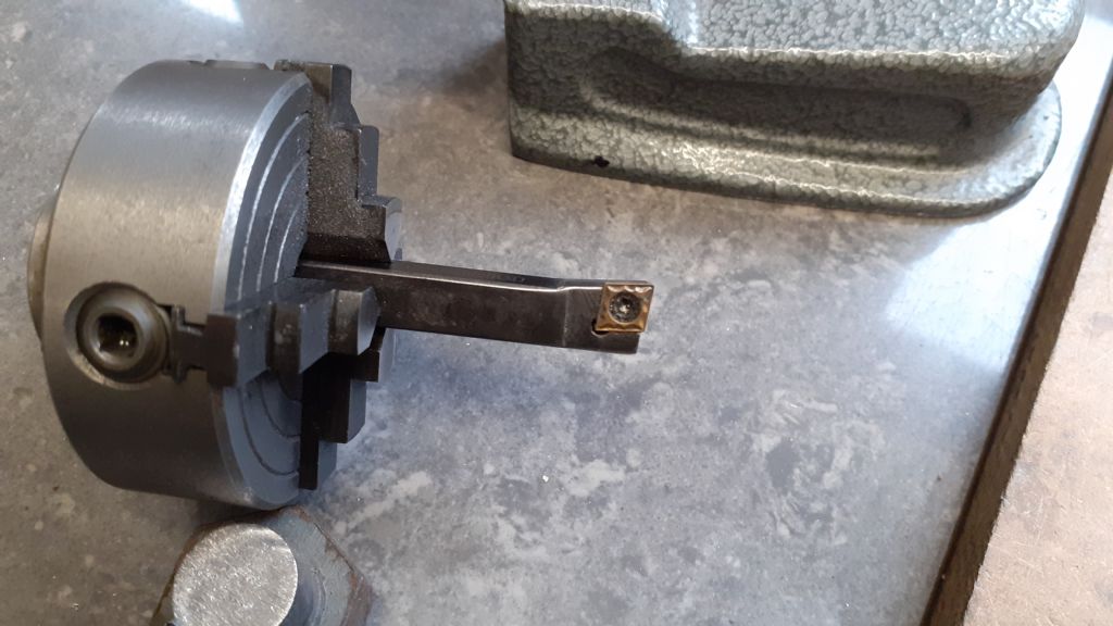

                          Btw I would not have thought of putting a lathe tool in at chuck and using it like a small fly cutter

                              Hi JasonB, OK yes there is a bit of waste but you do get two pieces to play with, whereas cutting the the bar in haft produces a bit of waste that wouldn't be any good, should the piece that has been turned to size goes wrong. I'm not saying that my idea is any better than the one that you have shown, and I understand your method, and it is a valid one, but I don't know if Paul has the equipment or the skill to do it the way you have shown. Of course with the way I've described, there is no heating involved or cleaning up once finished. Although I thought of it before reading Clive's method, using the two pieces will allow tailstock support. Now by all accounts, looking at the finished engine, it seems to me that the semi-circular piece will need a couple of tapped holes on the flat side to fix it to the base, which could be drilled easily on a bench drill before the two parts are turned together, and can be used to hold the piece in a similar manner to the way you have shown, when milling the slot. My method was only an alternative way of doing the same job, and many others my find an easier way for them, There is waste, but it's a small amount compared to videos I've seen of things milled out of solid blocks of metal. There is always a cost in any method, whether it's extra material, heating, cleaning, time mistakes, etc.
                              If Paul does it by the method I've described, and it turns out fine, he could always buy another kit and make another engine and then sell it for a little profit to put towards his next project. devil

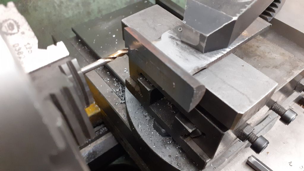

                                As for wasting half the round bar by sawing it off yes but it is better than wasting it all by not using itsmiley
                                As the base and standard are going to be soldered together then there is no extra clean up with my method as it will be needed anyway and I'd be happy to do the same if it were JBWelded or soft soldered together.
                                And apart from a bit of bar for a clamp (which I have said may not be needed) and some packing no extra equipment needed

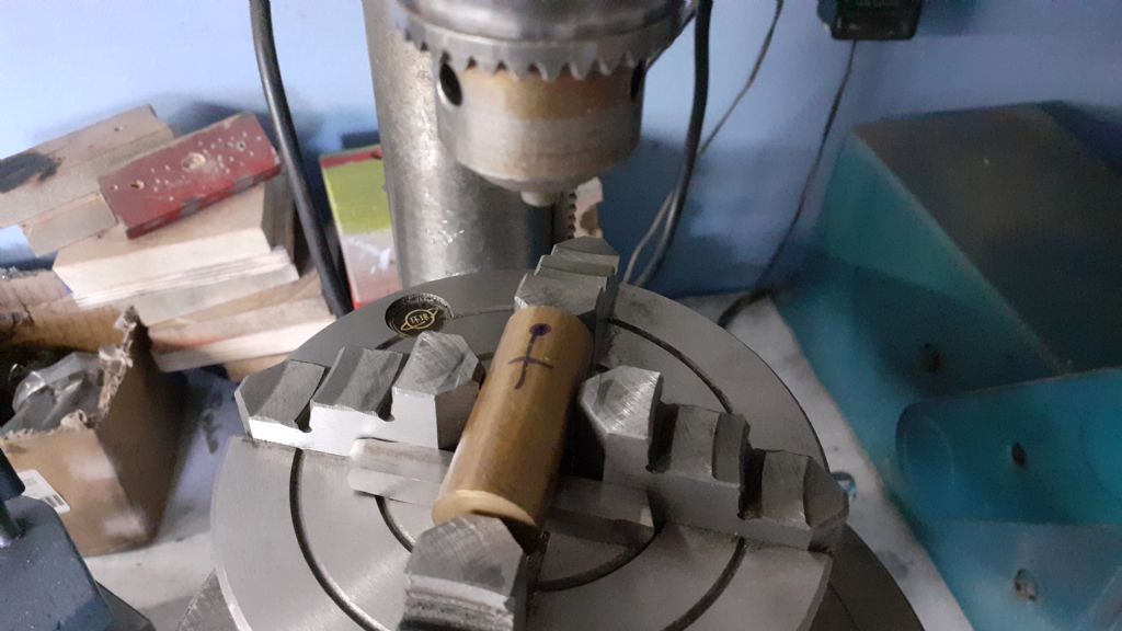

                                Did not add too many photos but my setup also allows for drilling and tapping the two holes in the base perfectly perpendicular and just about exactly spaced by use of the cross slide handwheel.
                                But above all it ensures the base is true to the standard. other methods being suggested hope that the stitch drilled and filed slot will hold the standard truely vertical.

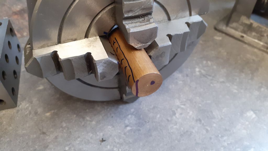

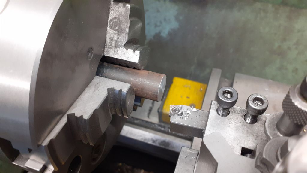

                                        Fingers crossed though as you are likely to need to do other milling with the lathe a simple clamp bar may be a worthwhile investment in time and material, I still have and use the ones I made for my little Unimat 3 which must be about 40yrs old.
                                        You mentioned about making a vee block from the offcut from the base, having sawn a similar bit off it is rather small and would be hard to hold for making into a Vee block. Luckily you don't need a vee block and have all that is needed.
                                        After facing the ends of the supplied stock set it up in the 4-jaw using some lathe tools as packing (remove before switching on) and set it lengthways so that the lathe axis is on the point where the cylinder pivot goes. You can then face back to produce the flat surface and then drill and tap the pivot hole, it is important to get this perpendicular to the face for a good seal and doing it all at one setting will ensure it is. Guide the tap with the tailstock chuck so it does not wander and give a wonky thread.
                                        If you have a bench drill you can take the chuck off the lathe and move it with the work still in place to that to drill the steam passage
                                        If you don't and have to drill on the lathe then just move the work in the 4-jaw
                                        It looks like the bore is offset in the stock so you can then use the 4-jaw to hold your work and set it to run true to a marked ctr position and spot drill, drill and bore or ream the hole.
                                        Depending on what you have to make and finish the hole I would consider making it a through hole so any lapping will be easier and then just turn and loctite in a stepped cap to close off the cylinder.
